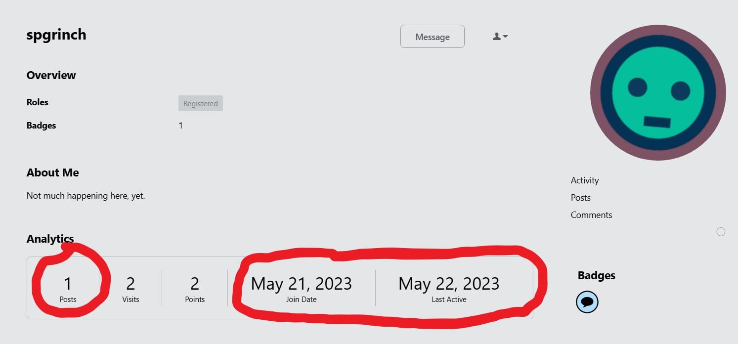

    Viking64 Posts: 7,677
    willyD wrote: »
    Hi spgrinch can you explain further how do you set the sub 15 degrees? Seems it worked for you
    Don't hold your breath. :p
