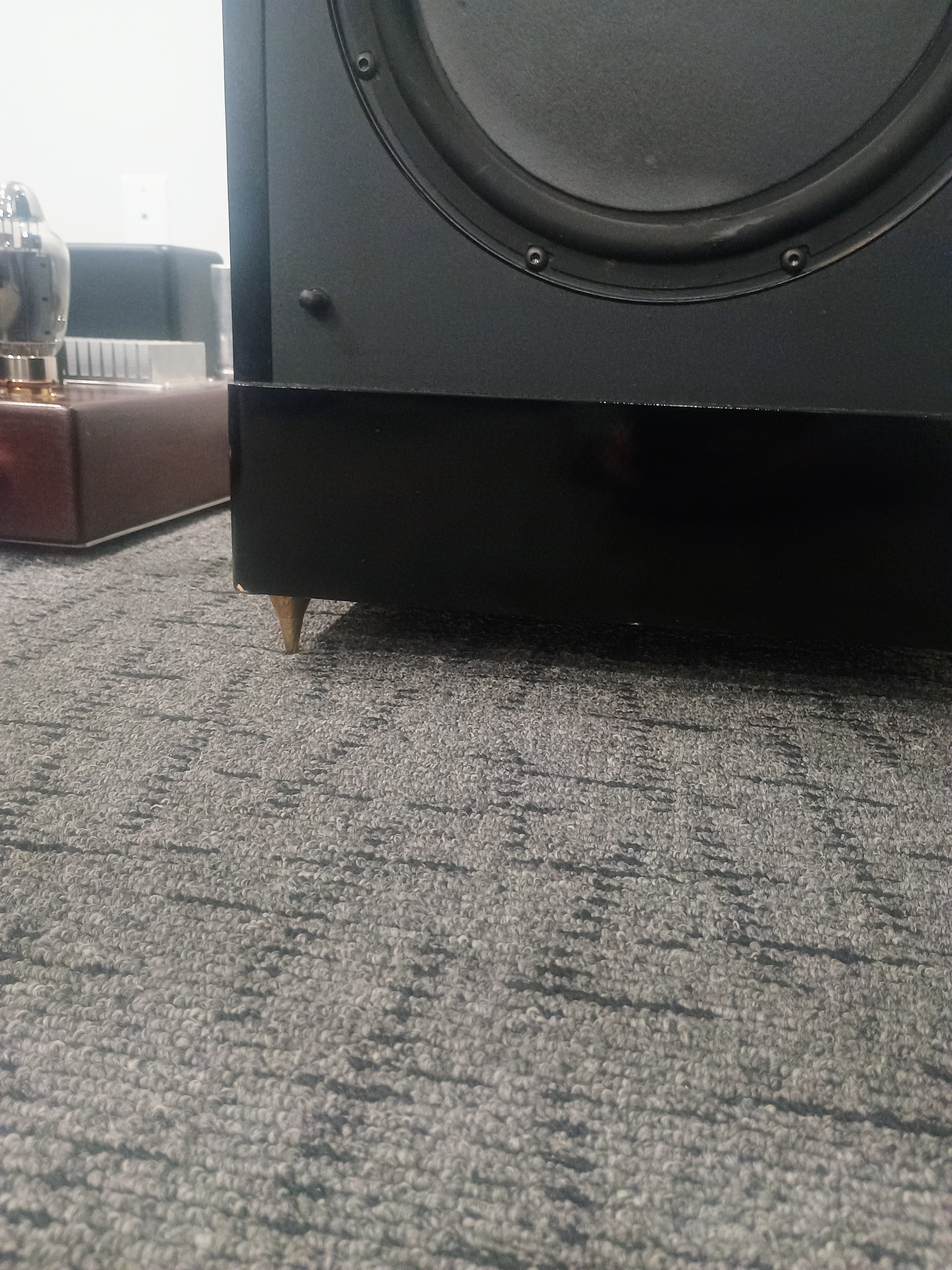

    Spikes worked great on mine, but I got lucky and bought them about 10 minutes from my house for $32 from meniscus audio, but the owner retired a few years ago.

    Better picture of the spikes I used, they are about the same size as the original pedestal.
