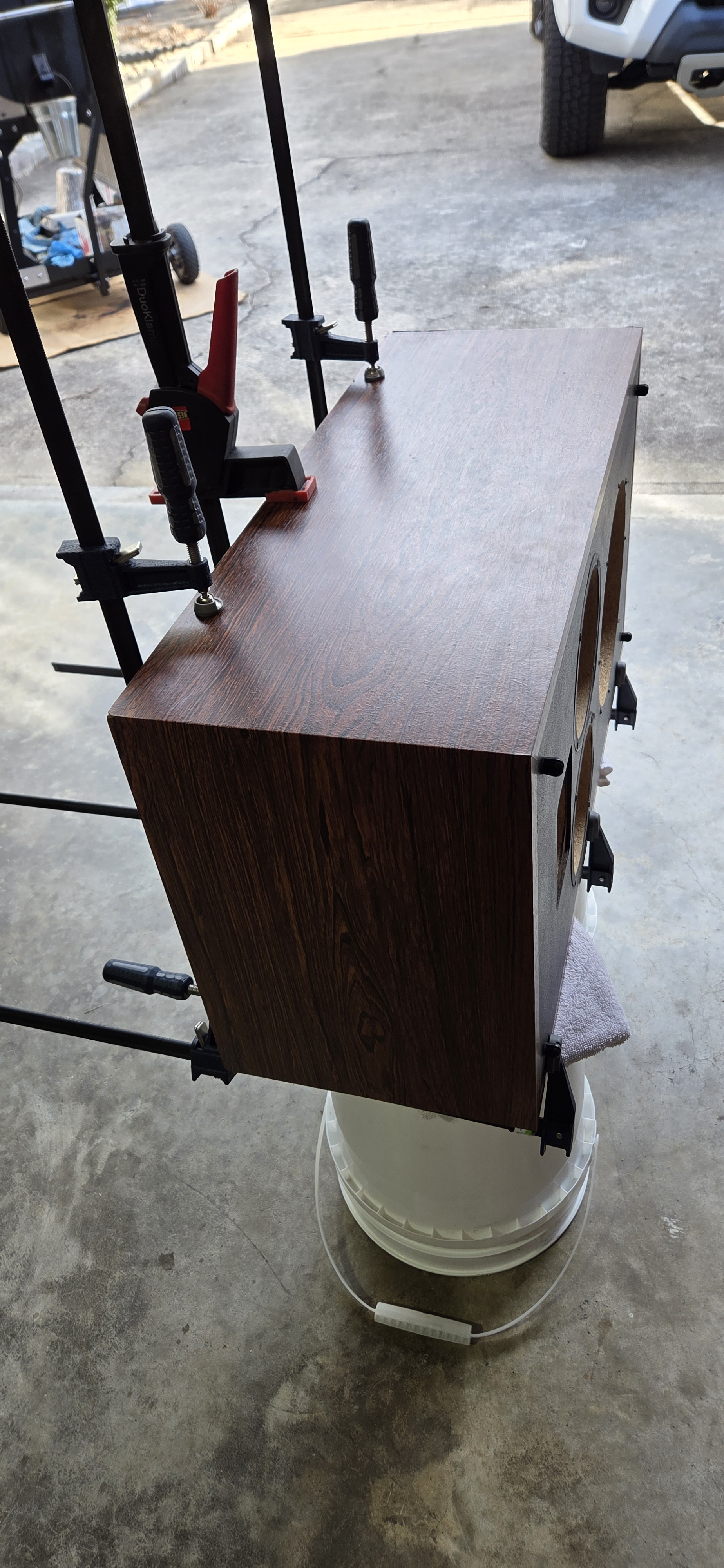

    Well, I kept troubleshooting the vibration and literally can see the side panel is free of the rear panel down nearly the whole seam. WOW, with a lot of bass it's so obvious! Now, don't want to screw through the cabinet and it appears the rear panel is too thin to screw some small right angel brackets. Thinking of Titebond 3 Ultimate wood glue and some clamps, thoughts from the gallery?
    Tony M Posts: 11,814
    Great.
    Can you spread the panel away enough to get some wood glue into the joint and then clamp it back together?
  • TLOC
    TLOC Posts: 10
    Sure, would it be a disgrace to install small right angel brackets inside the cabinet and glue as well? May 3-4, HD has 1"x1" right angel brackets in black with screws. I checked this morning and both panels are 3/4"(.75) +/- thick...thoughts???
    I wouldn't use L brackets.
    You could glue the joint back together and let it set. You could then glue a long corner moulding to reinforce the original joint. A 1"x 1" X how long that joint is. That joint would then be pretty solid.
  • TLOC
    TLOC Posts: 10
    Titebond 3 Ultimate on the inside seam and Titebond Quick & Thick on the rear seam, 6 clamps... :|
    pitdogg2 Posts: 27,467
    edited February 12
    After the glue up, I would do all the seams with Power grab heavy duty and push into both panels. Not only will it help with sealing up for no air leaks, it will also bond all the panels together for a more solid box. Many of us have done the same.
