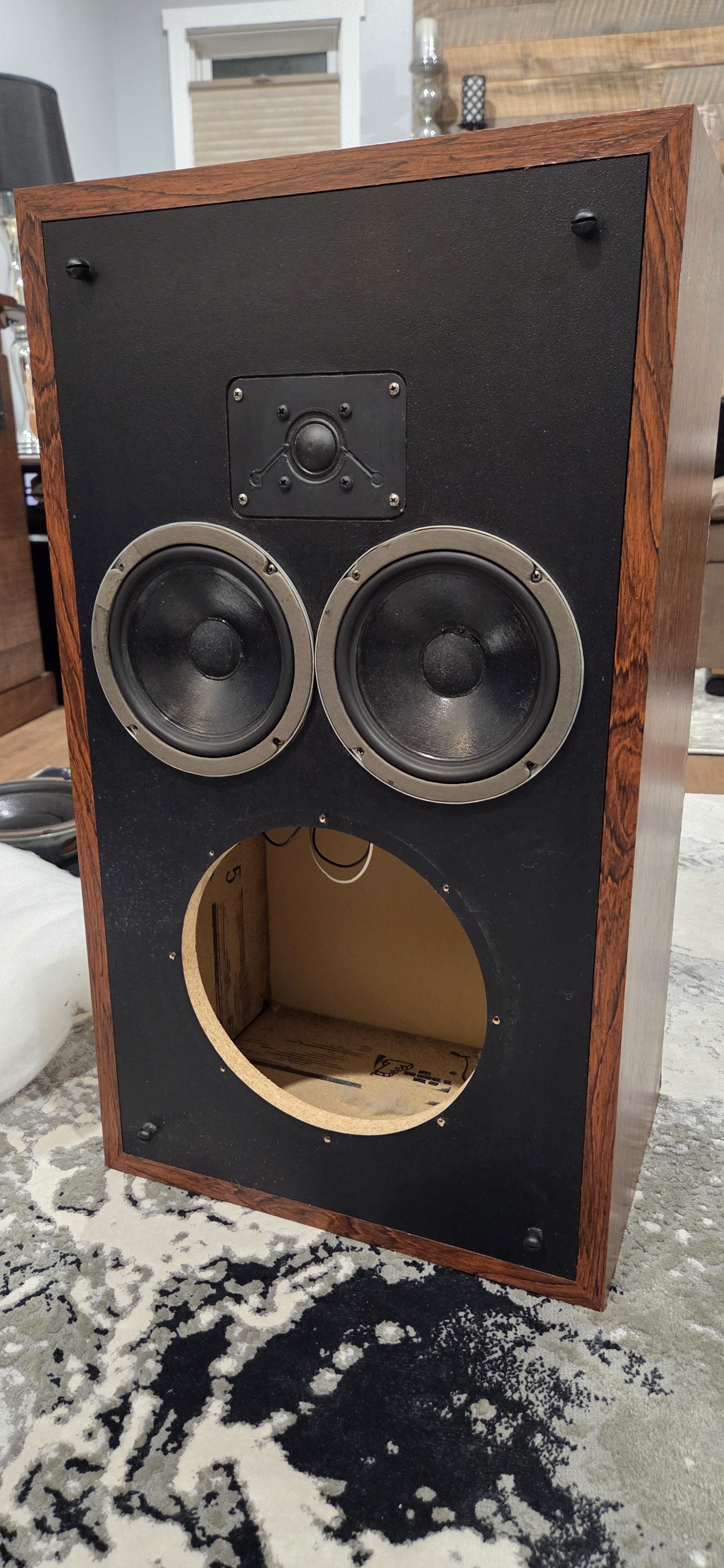

Hey Polk Audio freaks, new member, just scored a set of Model 10s, sounded and looked amazing at demo. Got them home and it seems one of the cabinets is vibrating/ resonates at a higher volume. Removed radiator and inspecting cabinet but can't find anything. Any suggestions from the experts. Love to figure it out, thanks y'all...Here's a few pics...tf357cwno0ft.jpg

    Is the white wire possibly hitting the passive radiator?
    Maybe a suspension spider is loose on a midbass.

    Thank you Tony, hard to explain but it seems more like the cabinet itself...Tony L

    Does it vibrate with that passive being out?

    Well, I kept troubleshooting the vibration and literally can see the side panel is free of the rear panel down nearly the whole seam. WOW, with a lot of bass it's so obvious! Now, don't want to screw through the cabinet and it appears the rear panel is too thin to screw some small right angel brackets. Thinking of Titebond 3 Ultimate wood glue and some clamps, thoughts from the gallery?

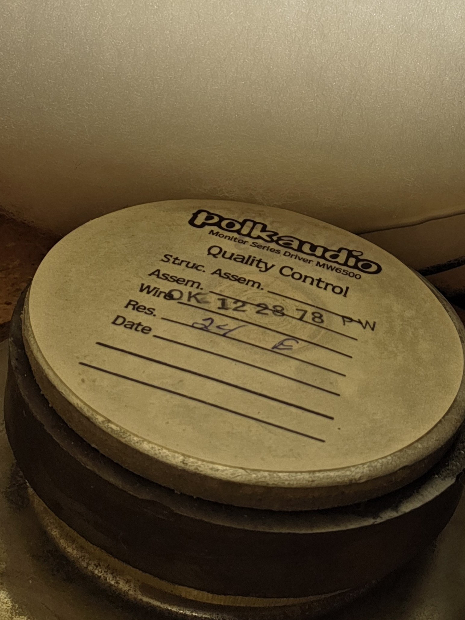

    So after the repair speaker sounds really good, new problem OTHER speaker tweeter fuse blowing after I put correct 1A fuse in. They're were 2A installed, go figure! It played for a few mins then blew. Questions, how do I know the tweeters are original peerless? Also, is this now a crossover issue? Third, do I start with replacing like for like modern caps or go whole new board? So far Ive replaced a set of binding posts on one, cutted and glued the other cabinet and cut, desoldered all driver connections and replaced with new gold plated female blade style...good grief...

    The one pic showing a tweeter looks like the Peerless.
