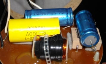

    Here's a shot of one of the rebuilt crossovers. New caps and resistors came from Parts Express. The green resistors are pretty long, but they have long copper leads, so everything fit nicely.

    I'm curious, why didn't you upgrade the most important cap, the yellow mylar?
  • I don't typically replace film caps, since they are generally good long-term, unlike electrolytics.
    But I'm willing to replace them if there's a benefit.

    It's a crappy mylar, easily bettered. Stick a Jantzen Superior Z or Clarity CSA in there. You can thank me later

    Both of those 12uF mylars were in series with the tweeter but you only replaced one with the Audyn. Not all film caps are created equal. Polypropylenes are considered to be better than Mylar. They have lower dissipation factor DF.
    Huh?

    There's only one mylar on a 10B crossover.
    xschop Posts: 5,138
    Depends on what was in Polk's part bin that day at Gallagher Mansion.
  • What tightwads! That electrolytic is in series with the tweeter also, even if it is part of the contour network. If I was replacing only one of them I would've done what OP did as well as that electrolytic probably has more than 10% DF at this point in time and mylar is probably still around 1%.
    But I wouldn't have done only one.
