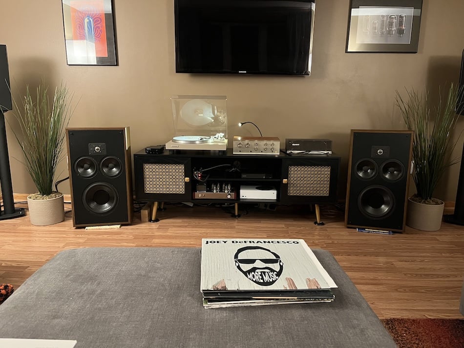

New to me 10B
Saw these listed on CL the next town over. Auditioned in a really dark old trailer house, hooked up to an extremely tired-sounding low end 80s receiver & CD player.
Dirty and dusty, but the cabinets/vinyl were nearly mint. The half-dead amp didn't really give any indication of sound quality, all drivers appeared to work and there was no woofer rub. I have a set of 7Bs I've owned and loved since the 80s, so I pulled the trigger.
Connected them to the Dynaco, and they sound pretty good! The crossovers appear to be untouched, have stickers from '85 and '86.

    I think they will sound better if you can pull them out into the room a bit (experiment with how much) and put them on some solid stands with mass to them to raise the acoustic center up closer to your ear height and to decouple from the wooden floor somewhat, especially if it is a suspended floor above another room and not on solid concrete. It is never good for imaging to have stuff between the speakers. Don't forget to replace those SL2000 with RD0194 when your budget allows. Order them from Polk and ask for the forum discount.

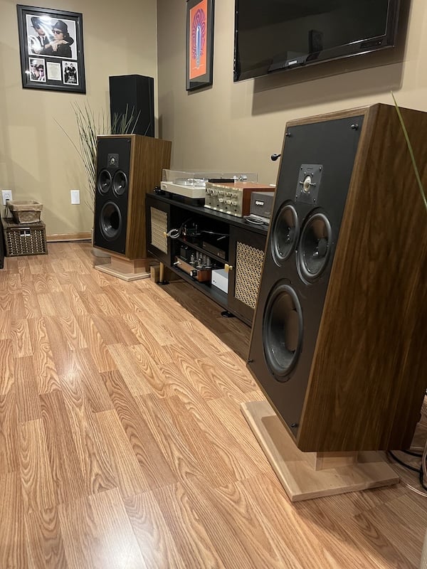

    The mailman brought my crossover rebuild parts today, so I spent the early evening rebuilding those. Back together now, the new caps need to burn in a bit, but these already sound less constrained.

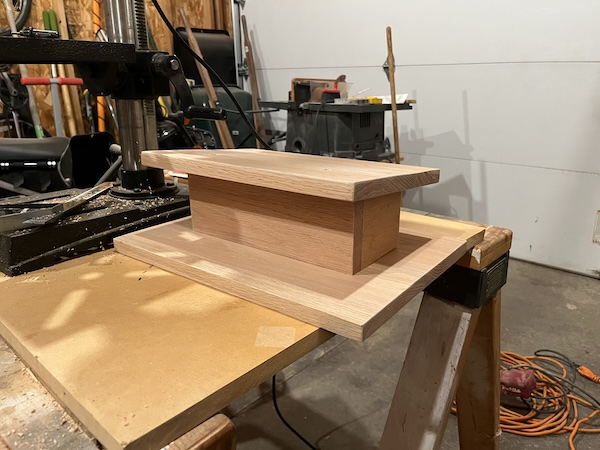

    I've pulled them out another foot or so, which does seem to improve imaging. A set of stands in definitely on the menu. I think I have enough oak scraps to build a set without needing to buy much more.
    This room's in the basement, so there's concrete right underneath that laminate.
    New tweeters on the list for sure too. I wouldn't say these are shrill, but they are a bit much.

    Hey…nice job on those stands. I’ve got some 7Bs as well. I’m looking forward to your impressions on how they compare with the 10s once you get those new tweets in!

    Very nice job on the stands!!
