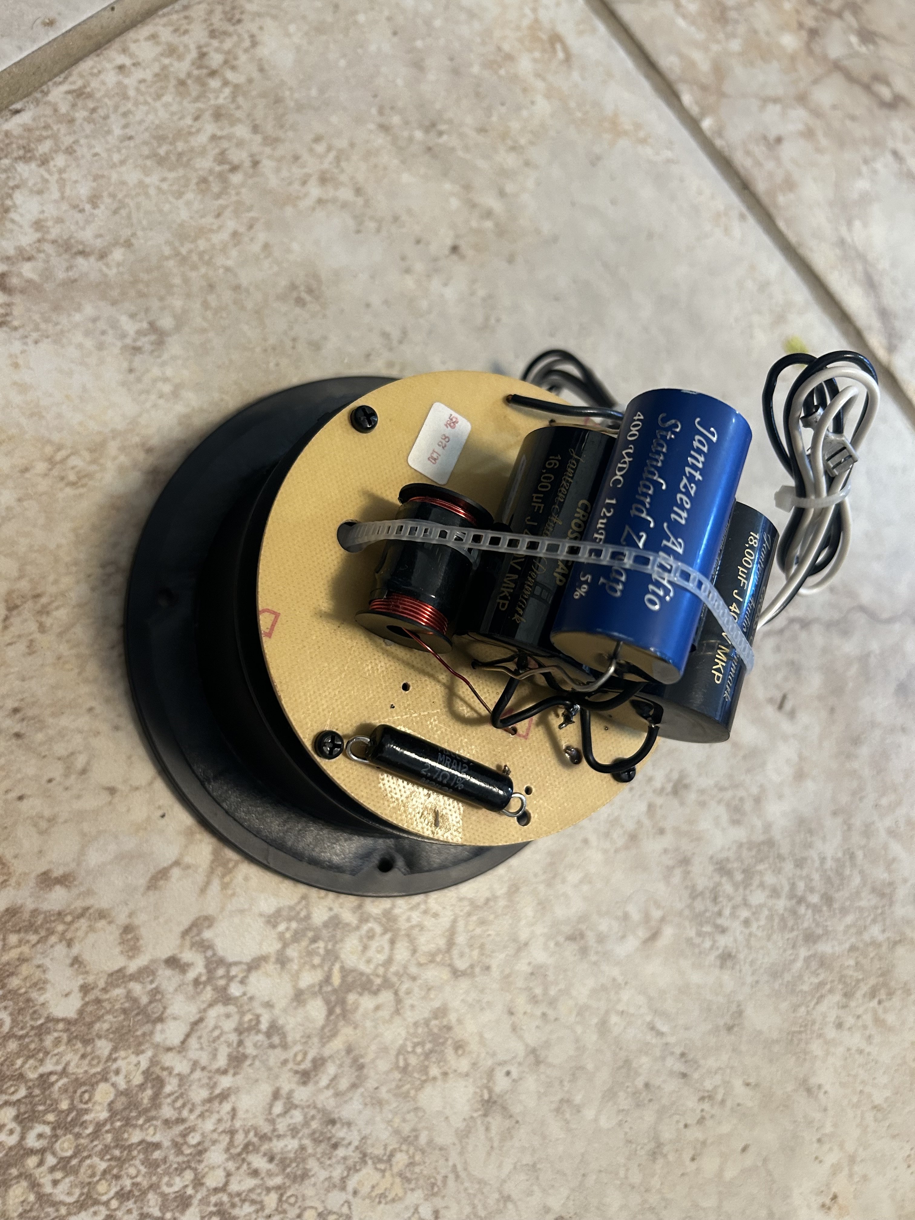

Monitor 7s recap
I just picked up a pair from a Goodwill auction, and I'm excited to give these a refresh - both the crossovers and the cabinets. I believe these are 7Cs? Any recommendations on manufacturers?

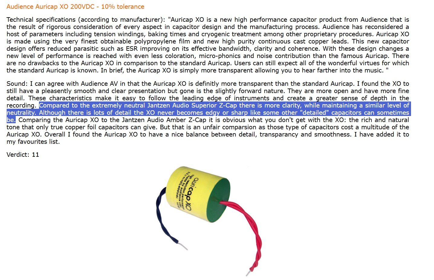

    Try an Audience Auricap XO 12 uf. Rated even higher than Jantzen Superior Z and it is $42.66 vs. $68.17. Sonicap is $57.27 and ClarityCap CSA is $26.68.
    You'd be the first one here to have tried the Audience afaik 😉 PS: except for maybe DarqueKnight (rip) 😥

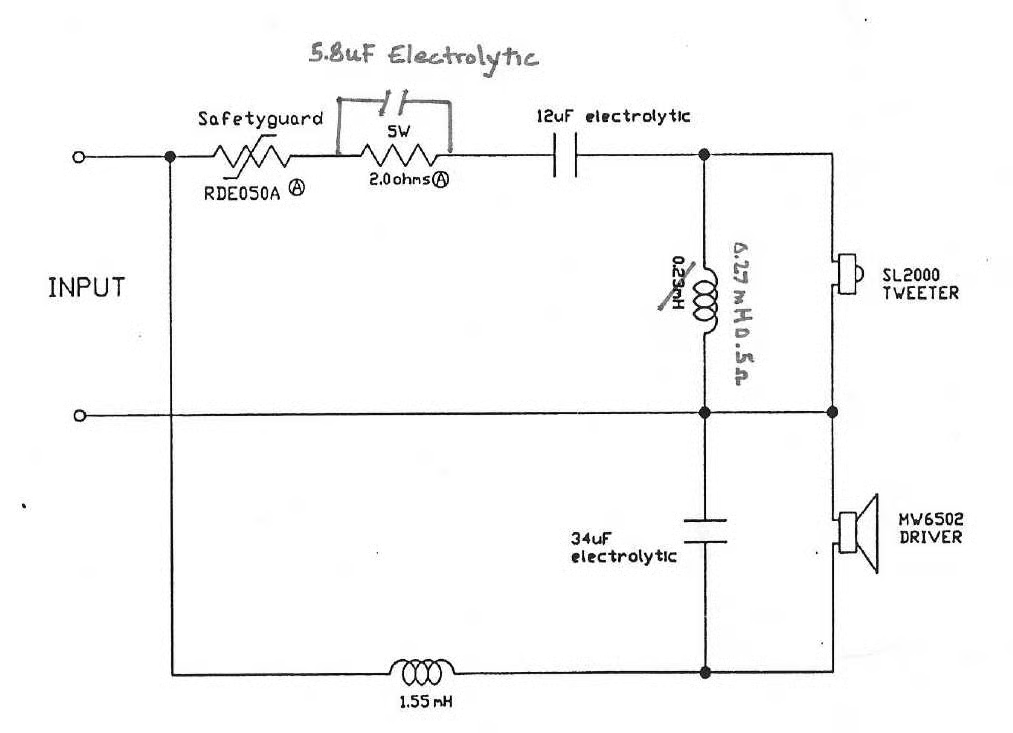

    What is a TL mod? I see references on an SDA refurb thread, but not much detail for a noob.

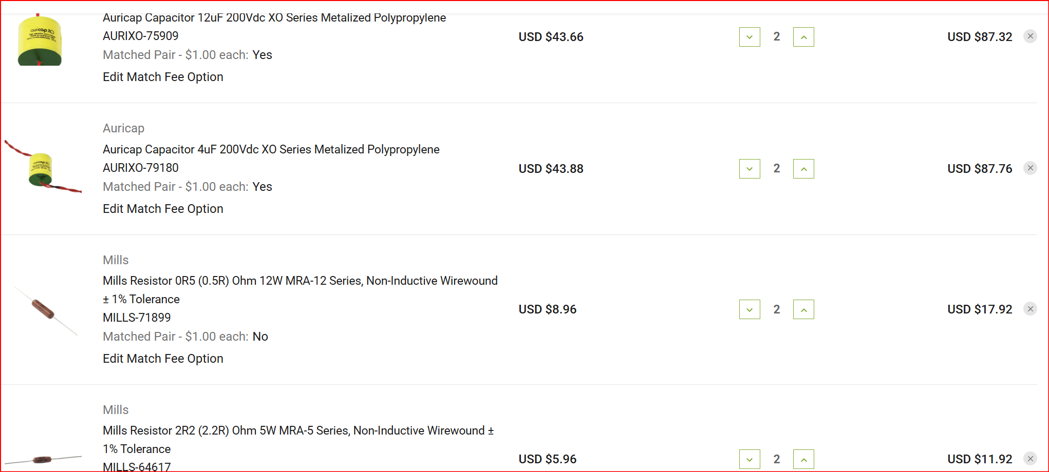

  • Before I pull the trigger, have I gotten it right?
    xschop Posts: 5,307
    TL mod requires the RD-0198 tweeters and a pair of 5.8uf caps.
    I'll try to find a 7C-TL Mod thread. The search function is sketchy here..

    yes 5.8 uF, not 4.0 uF. That 34uF could be a 33uF Clarity Cap CSA to save money if you wanted. 10W or 12W for the 2.0 Ohm tweeter resistors, not 5W which wouldn't be an upgrade over what is there, power wise. You have 2R2 in your cart which is wrong. That's 2.2 Ohms and you need 2.0 Ohms. You also need to get a Jantzen 0.27mH, 0.5 Ohm inductor so it isn't totally a simple mod.

    xschop Posts: 5,307
    I'd wager if he removed his factory tweeter inductors, they'd measure higher than .23mH. JAT
    I think that's a possibility for sure, if OP has or wants to get the measurement equipment. I don't know what the DCR would be of the stock inductor. Needs to be 0.5 Ohms now.
    This would work. I don't know if you can get them elsewhere other than hificollective
    https://www.hificollective.co.uk/catalog/000-1640-027mh-jantzen-air-core-wire-coil.html
    Hell no, you don't want those and forget about the TL mod BS or advice from the speculators.

    This is kind of ridiculous. I told the OP that nobody that I know in the forum except for DarqueKnight has used them but they ARE rated higher than Superior Z by TonyG fwiw. He gave it an 11 instead of 10.25. He specifically COMPARES them in his summary. I have no personal knowledge of it and I said as much, but neither do you. Oh and it is quite a bit cheaper and ON SALE.
