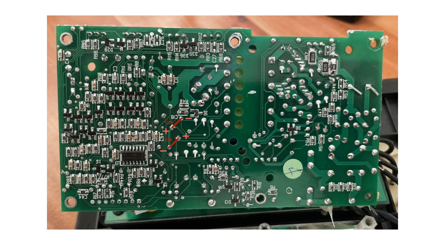

    My hypothesis is that the PSW111 features two different amplifier versions, one completely similar to that of the PSW110, with some larger components, another, which is perhaps the older, and completely different. An ebay user is selling a PSW111 as broken and the amplifier is very different from mine, it's like the one @Walterx79 . Casually somebody have the schematic of this second version of the amplifier?

    jwh7 wrote: »
    Long story short (pun intended), that trace had been fried. Connecting them made the sub amp work a-ok; it has been working fine for a few weeks now. ;-) I suspect some of those here (and at the hesiod blogspot) that didn't have success likely had this same issue.
    I simply cut a tiny chunk of phone wire and shunted the burned connection; by the 'D8' transistor in the following pic.
    I randomly thought about this old repair and wanted to check recent posts. :-) Since I fixed mine over 3 years ago, its been in regular use at my parents house without issue. \o/
