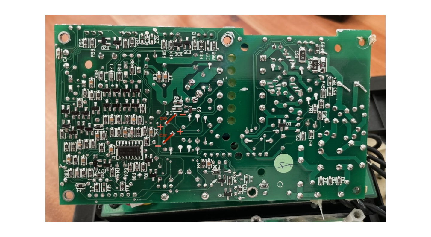

It seems to me that, from the photos posted also in this forum, there are two versions of the PSW111 plate amplifier. One is practically the same as the PSW110 with some different and more powerful components, another is radically different. I'm looking for the schematic of the second, the pics are these

    As evidence that there are two versions, this is the pic of the second version, whose amplifier has the same schematic as the PSW110 I already have, where lack the LFE connector
    F1nut Posts: 52,381
    The values are printed on just about every component.

    I didn't understand the point of the comment, they are two different amplifiers with different projects, I have the schematic of one, the other I don't. I'm a technician and I know how to read an electrical schematic, sometimes need to understand the logic of the circuit to make a repair and not disassemble and test components at random.

    Well, you could start with the 2 caps circled in red. That sub is infamous for blowing caps and those 2 do not look good.
    Other than that, you can send an email to Polk asking for a schematic. Be sure to mention it is a 230 volt version.

    The bridge rectifier and filter caps are OK, i fear the problem is in the little pcb mounted in vertical, the PWM controller, end i fear the schematic do not show the circuit of that as in the PSW110 schematic, but maybe the problem could be somewhere else on the board and schematic can help to understand it.
    Anyway thank for the idea to contact polk directly, I believed they no aswer but i can tray

    I founded a PSW111 defective for sale in my city at 40 euro, and I would like to try to repair it, but it is not the usual known heartbeat defect, when turning it on the fuse blows. The seller says he took it to be repaired and the technician told him that the problem is the PWM controller board, but I would not be so sure. That's why I'm looking for the wiring diagram.

    I just replaced C38 and C39. My faith in humanity has been restored. I attached a photo showing where the pins are to the PCB. I'm a true end-user so if I can do it, you can too. Thanks to everyone on this thread!
