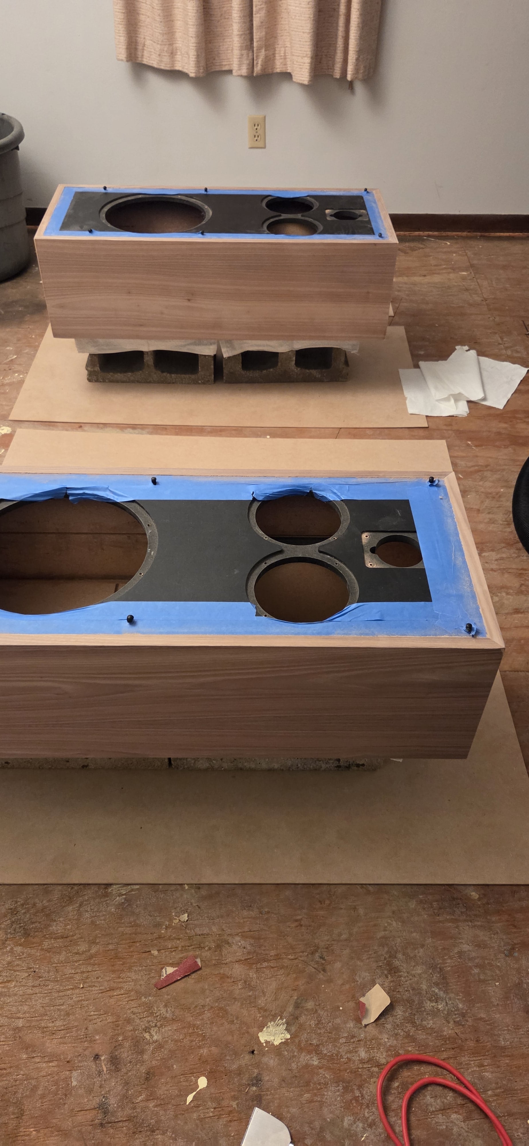

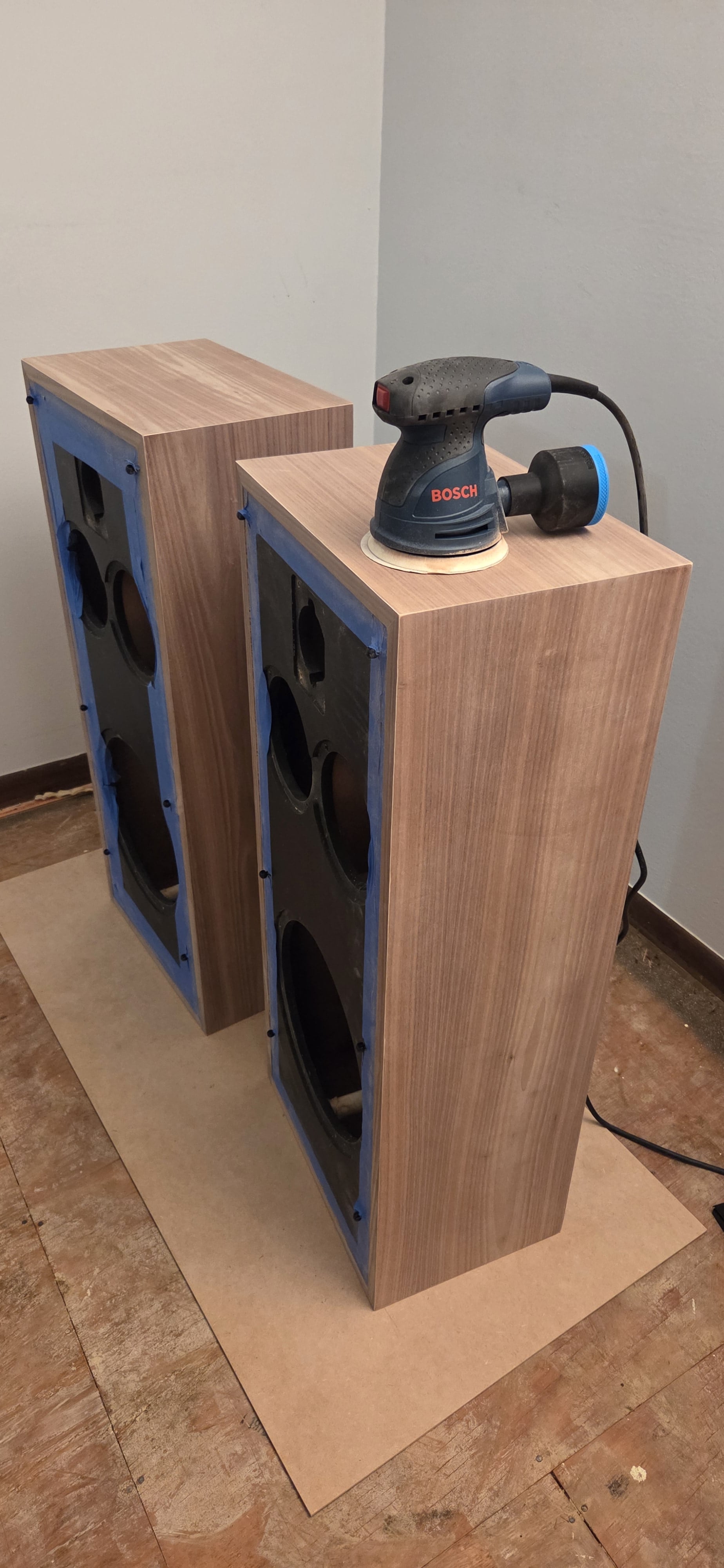

    I've decided that it's about time I get to work on this neglected project again. I left off having installed a new walnut veneer. I used a 4x10 sheet of wood backed (3/64") walnut-veneer and installed using DAP Weldwood Contact Cement. I spent last night sanding to 150 grit. I wish a was a bit easier on the sanding (knicked a few corners with a bit too much emphasis). I am spending today finishing with Rubio Monocoat 2c. B)<3

    Never use an orbital sander for something like this. Hand sand only in the direction of the grain.
  • drop1
    drop1 Posts: 92
    edited August 29
    You can see some swirls in one of those photos. I think that's mostly dust. After scouring and cleaning with mineral spirits it's all uniform and clean. It was a fairly heavy veneer and manufacturer guidance gave me the OK to use the power sander. I used a hand sander for the edges/corners and edge banding. Hand sanding is the safer route. Using the orbital sander was my choice.
    xschop Posts: 5,887
    Well you didn't start off with 60 grit, that's a no-no lol. Looks nice.
  • drop1
    drop1 Posts: 92
    edited August 29
    Yep, started and ended at 150 grit.
    Ultimately wish I would have been more careful with the orbital sander. However I don't need this to be the Mona Lisa. I need the project to be done :D

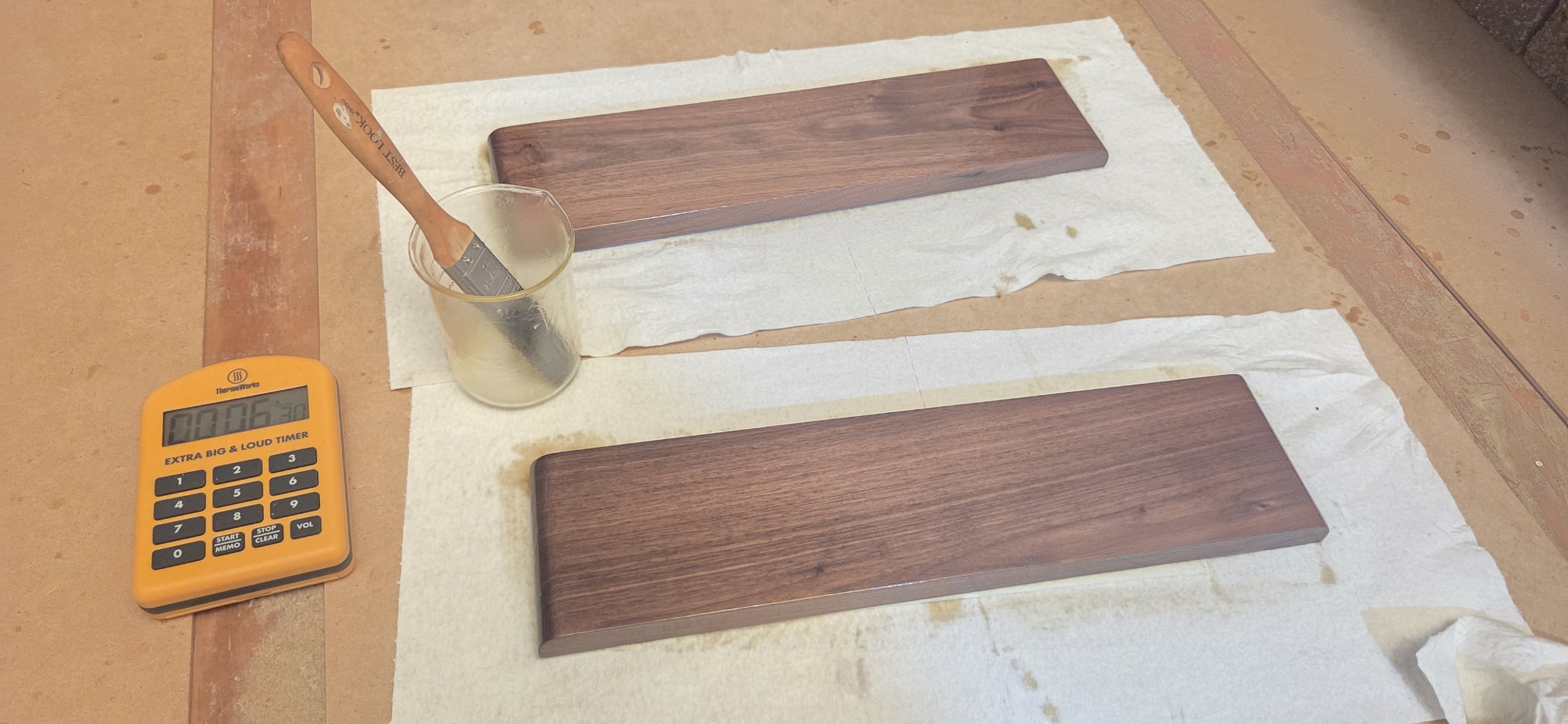

    Since I used a thicker veneer, I wasn't able to veneer these trim pieces. I cut some walnut to size as a replacement. It's gonna look awesome guys.
