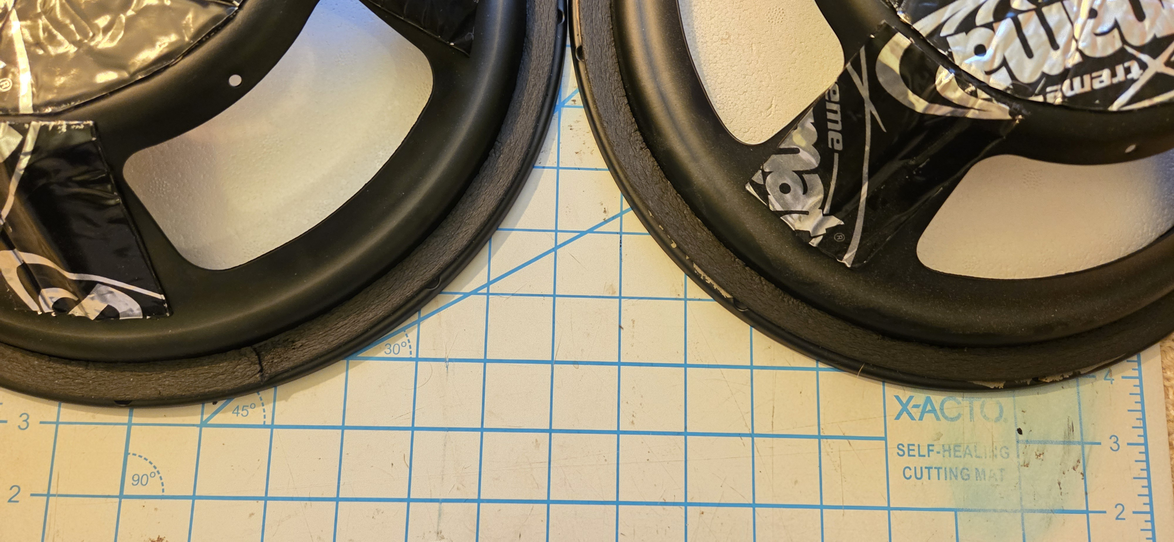

    Obligatory post:
    Glued the driver magnets with JB Weld. Dynamat Xtreme to the woofer baskets. inb4 a little goes a long way.

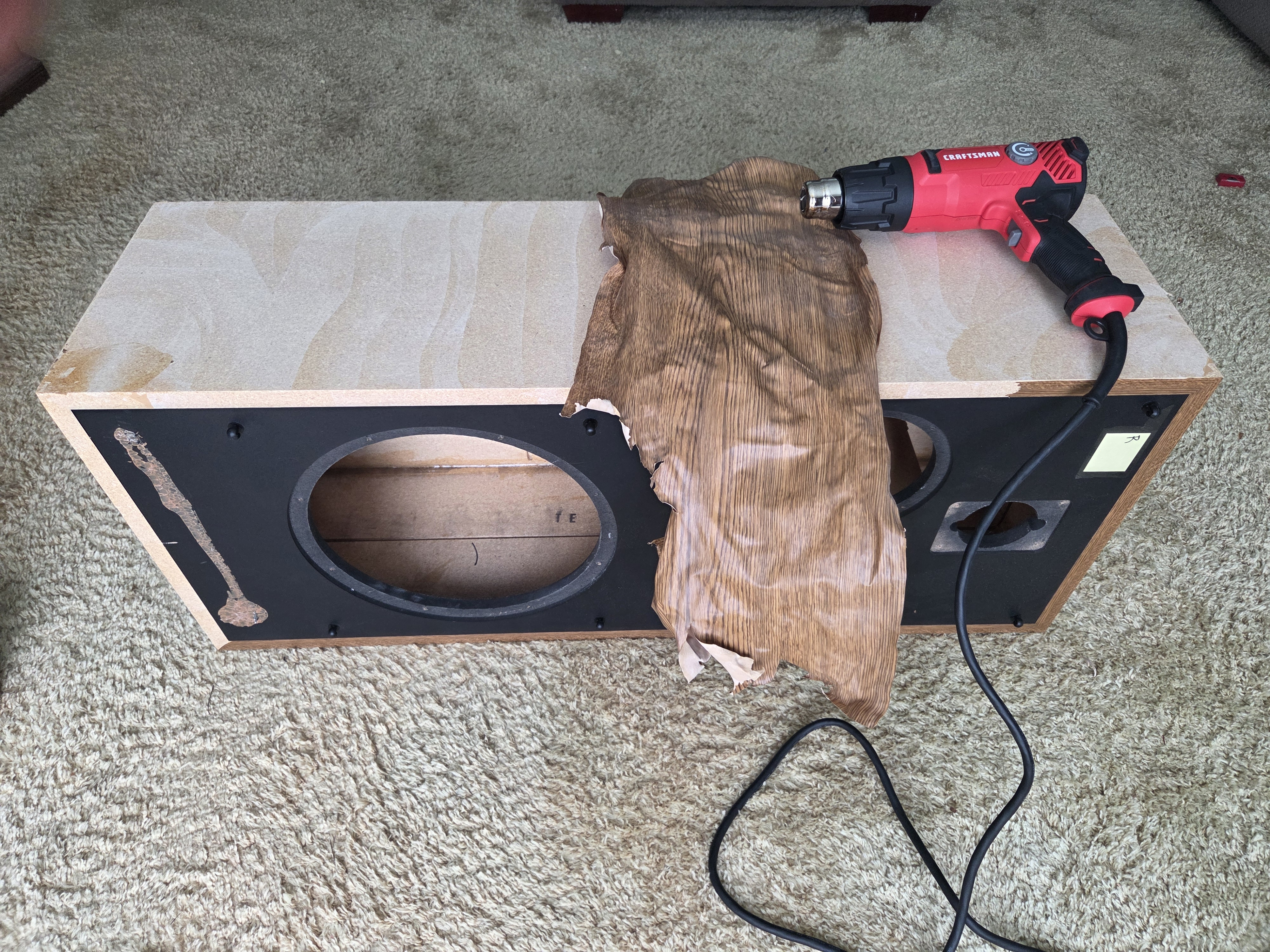

    The project commenceth.
    Vinyl wrap removal. I had quite a bit of trouble at first. I'm finding that the method described by a comment I found from @F1nut in 2010 is probably the best way to go about it. I thought this was going to take me *forever* but once I found a rhythm I was able to get it done with relative ease. Still quite time consuming.
    messiah wrote: »
    A heat gun.
    Heat up a corner by waving the gun back and forth. Do not get the gun too close. In short order the vinyl will soften, then get a grip and pull it back with your fingers. Heat a little more, pull it back, repeat until done. Use caution as the vinyl will be hot. I recommend gloves. I don't like to use a putty knife as it can tear the vinyl and also scuff/gouge the particleboard.

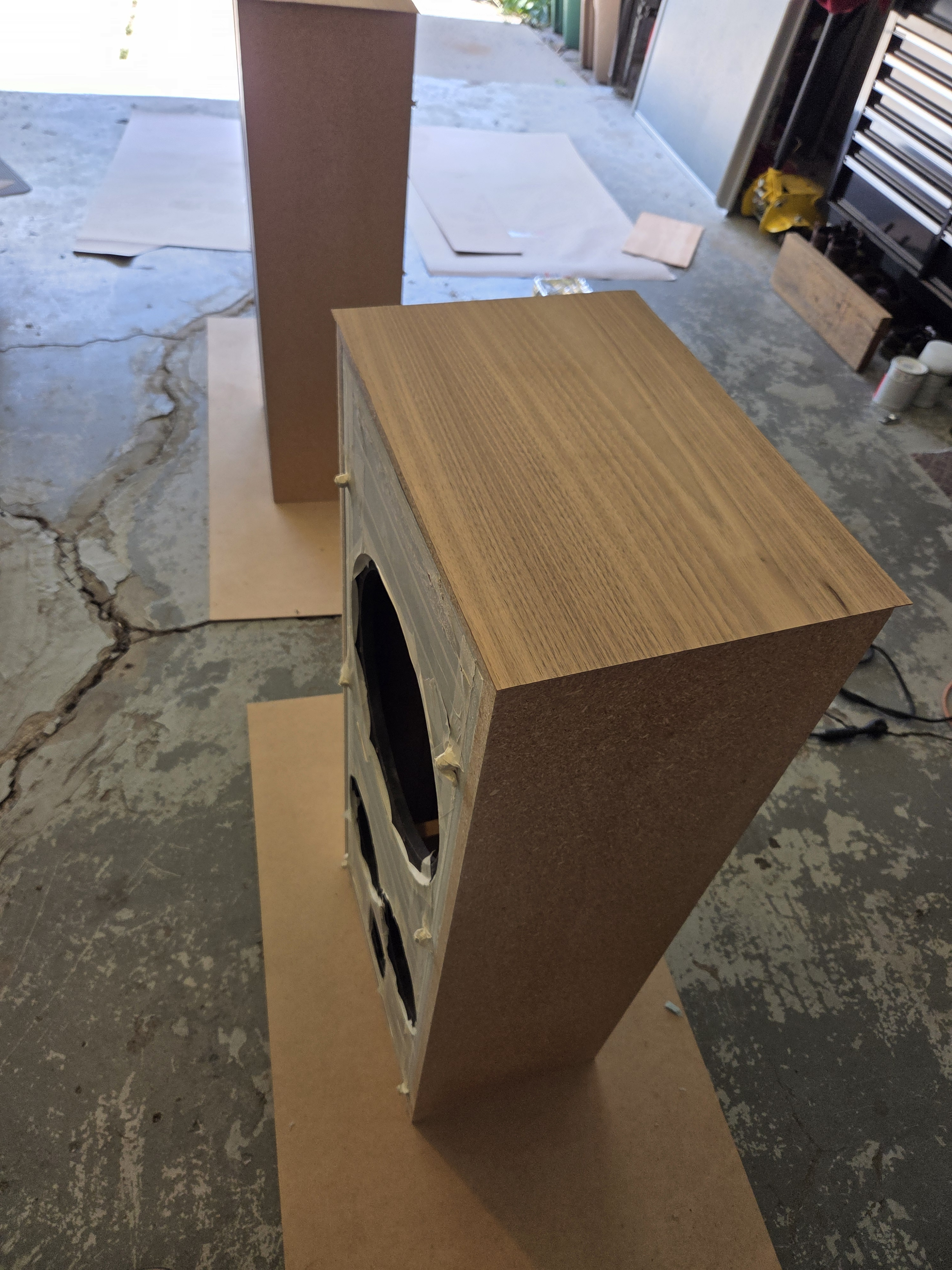

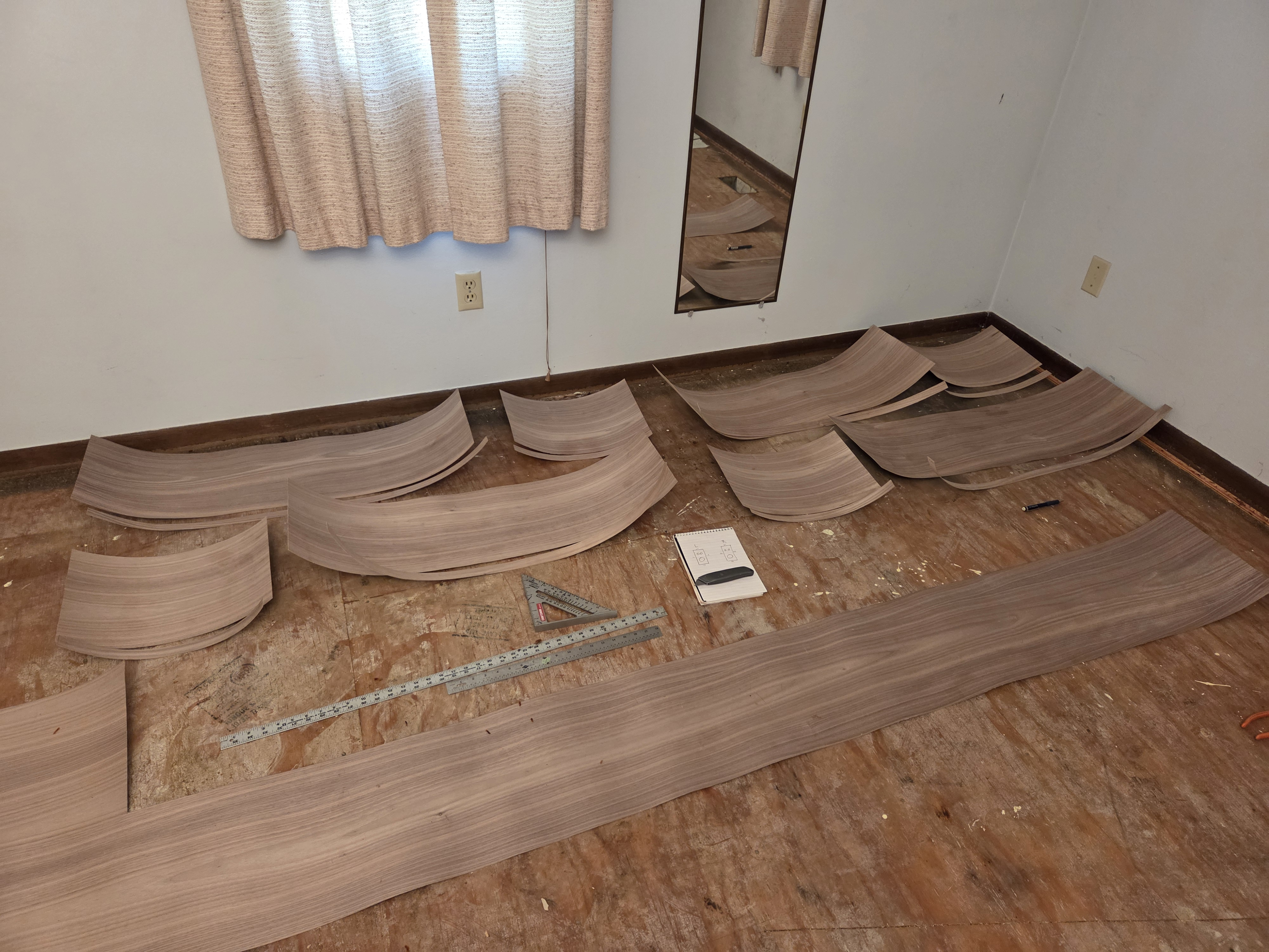

    Veneering commenceth

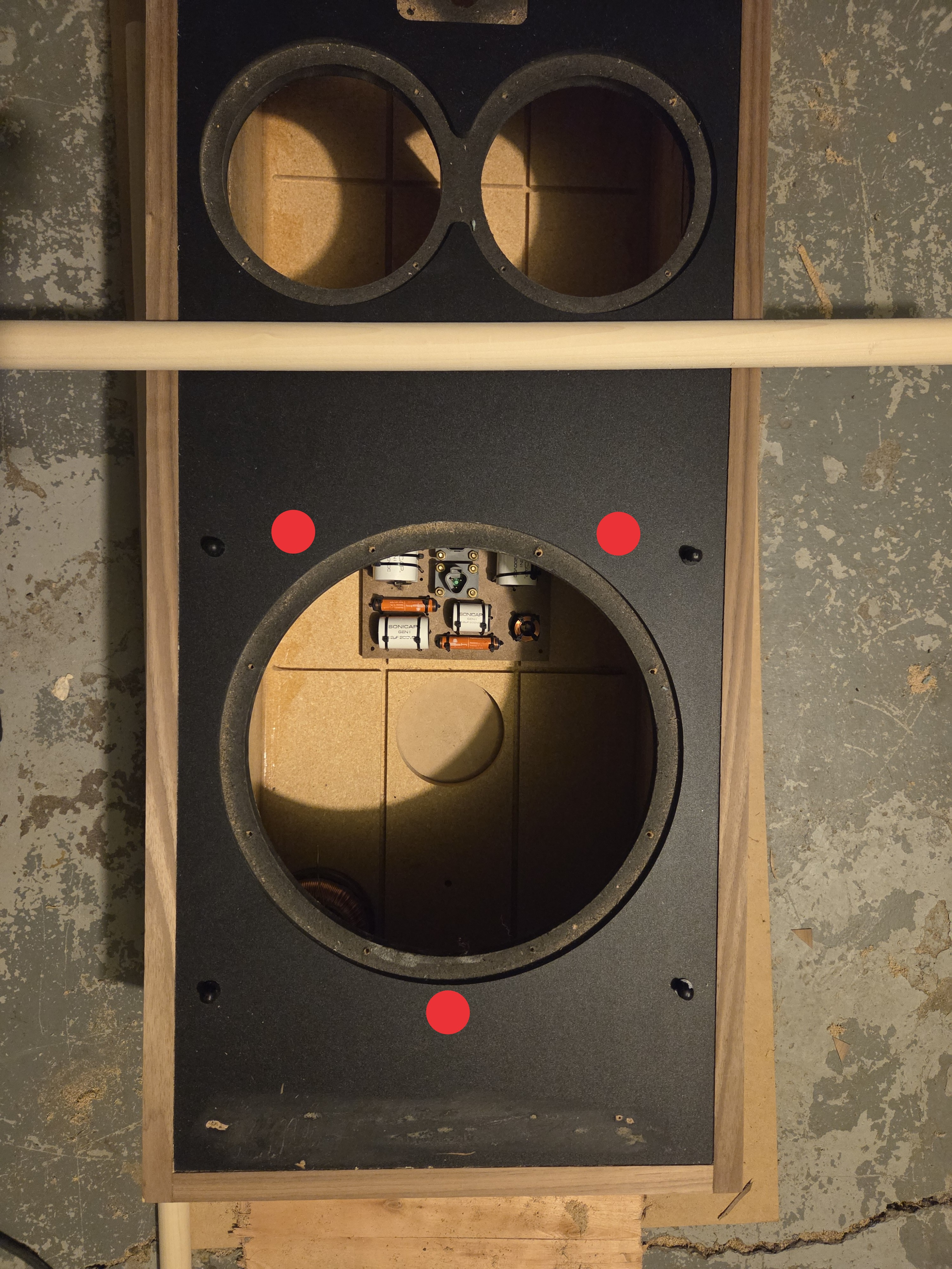

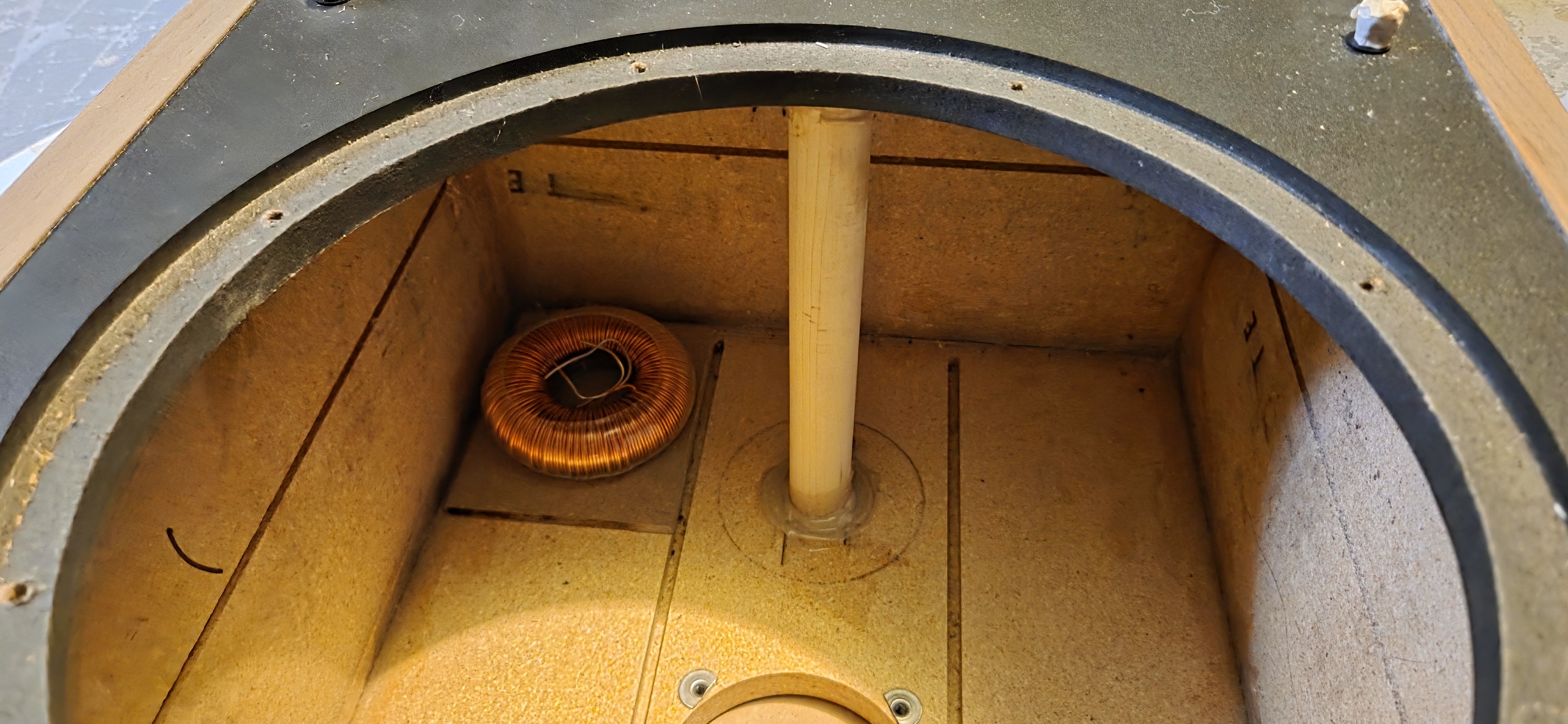

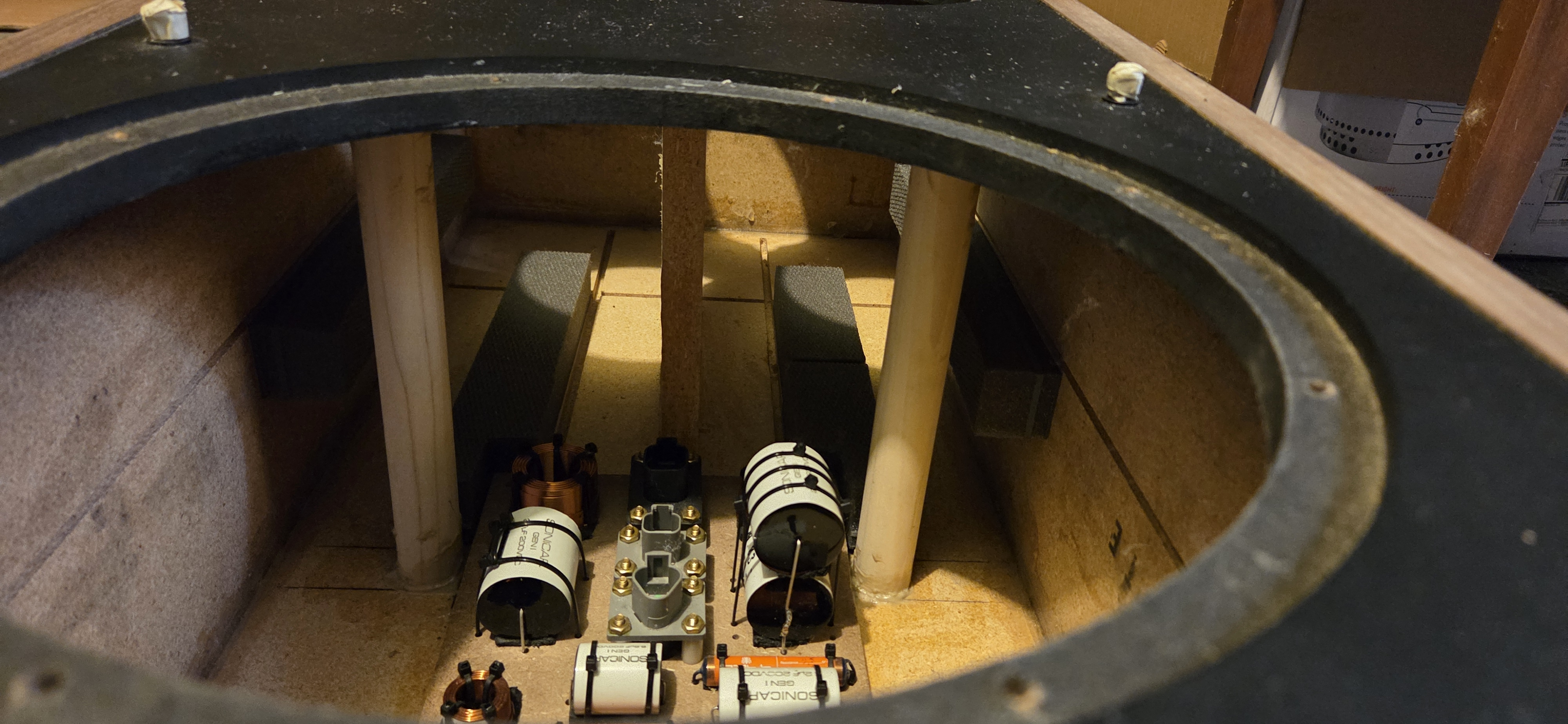

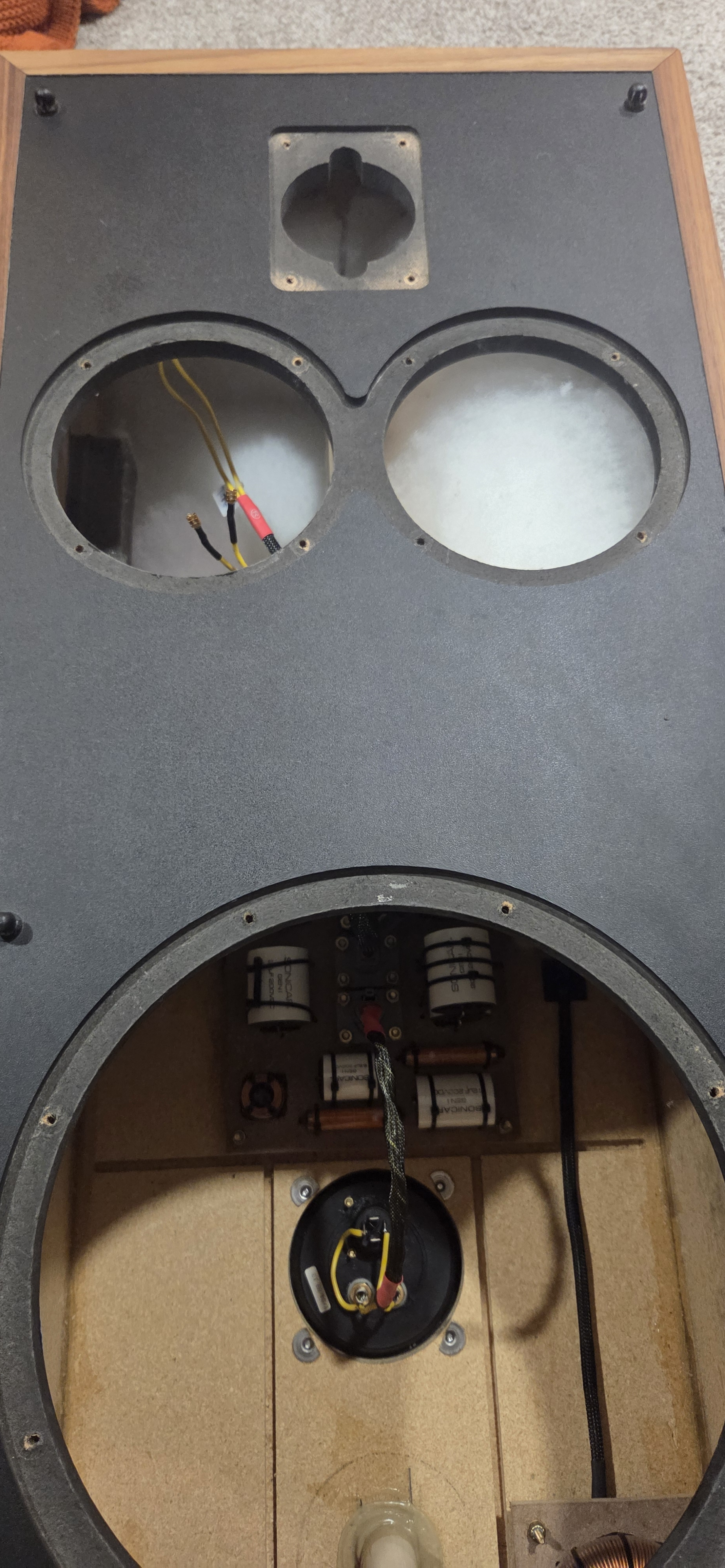

    Folks, I'm starting to think again about next steps on this project. I'd like to get some opinions if possible. What do you all think about adding some extra internal bracing to my 2b cabinets?
    I purchased some 1-1/8" dowels a while back. My idea would be to position them front-to-back at the red dots indicated in the below photo. In my mind, this would add some extra stability around the passive radiator. I also think that two dowels around the top edge of the passive radiator would help keep the polyfill in it's place.
    Thoughts?
    F1nut Posts: 52,270
    Staples will keep the poly in place.
  • drop1
    drop1 Posts: 69
    2 likes and an agree. I'll prob go ahead.
    pitdogg2 Posts: 27,737
    What if you moved the upper dowel rods to the midpoint between the mid-woofer and the passive?
    xschop Posts: 5,724
    Are there not factory braces between the mids? If not, I'd suggest placing one there as well, in addition to what you propose. Great build/work here.

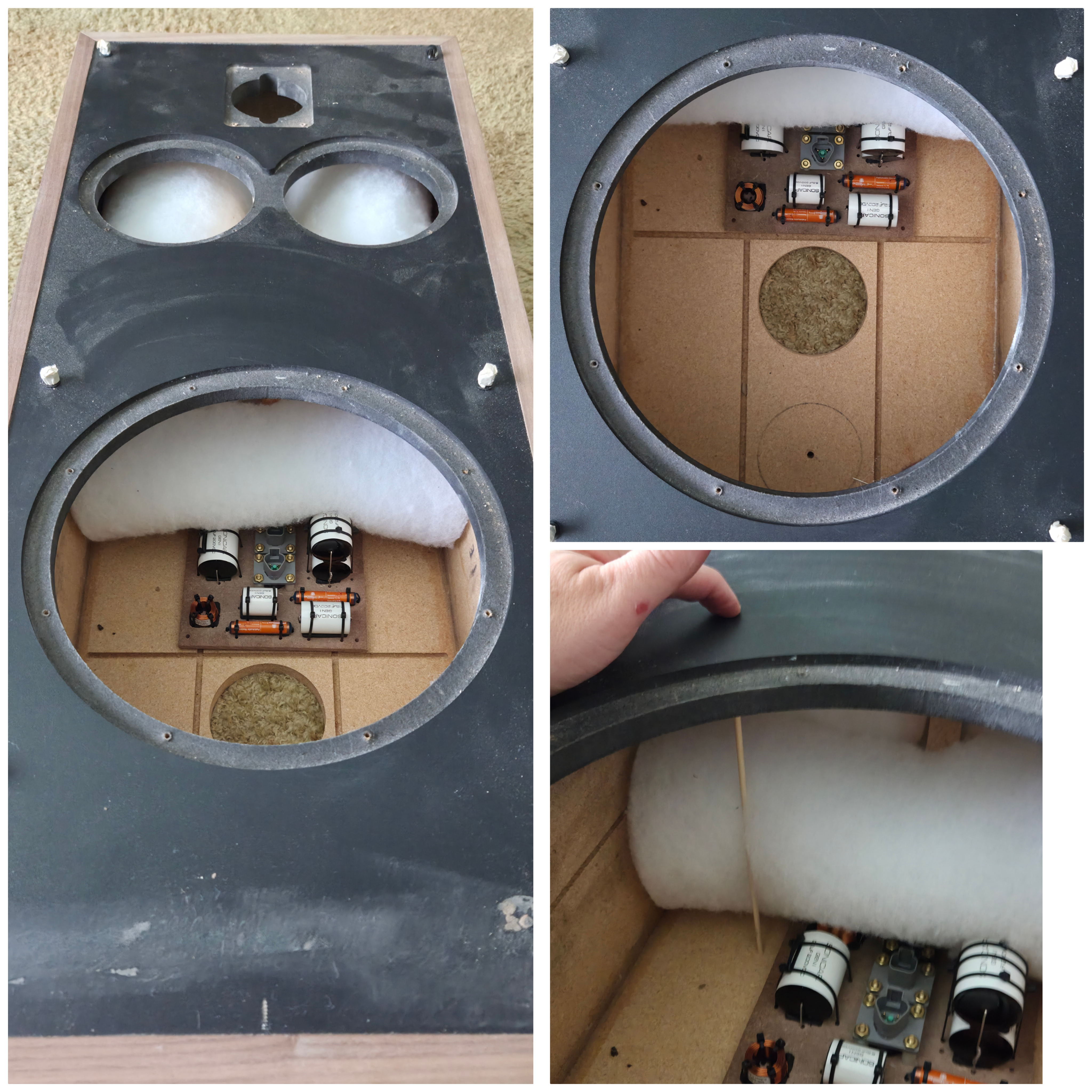

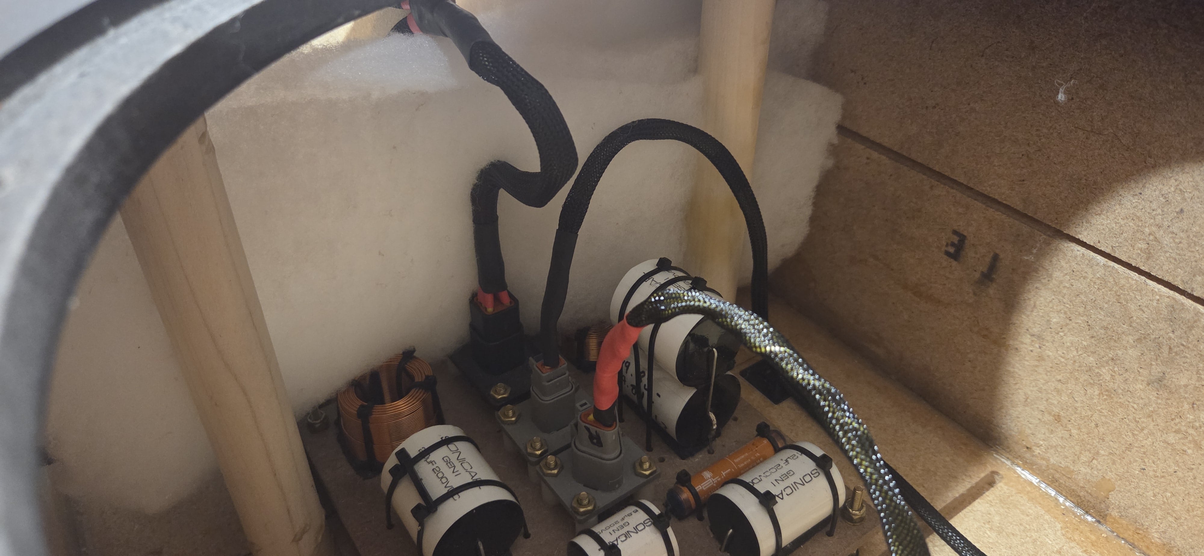

  • drop1
    drop1 Posts: 69
    Factory braces are still in-place. So here's a pic with the polyfill in the cabinet. It fills the space just under the center brace and folds over itself to stay out of the way of the passive radiator. It's already getting pretty tight behind the MWs and I haven't even added the BH5 yet. Current plan is to add the dowels at just the point where the polyfill ends.

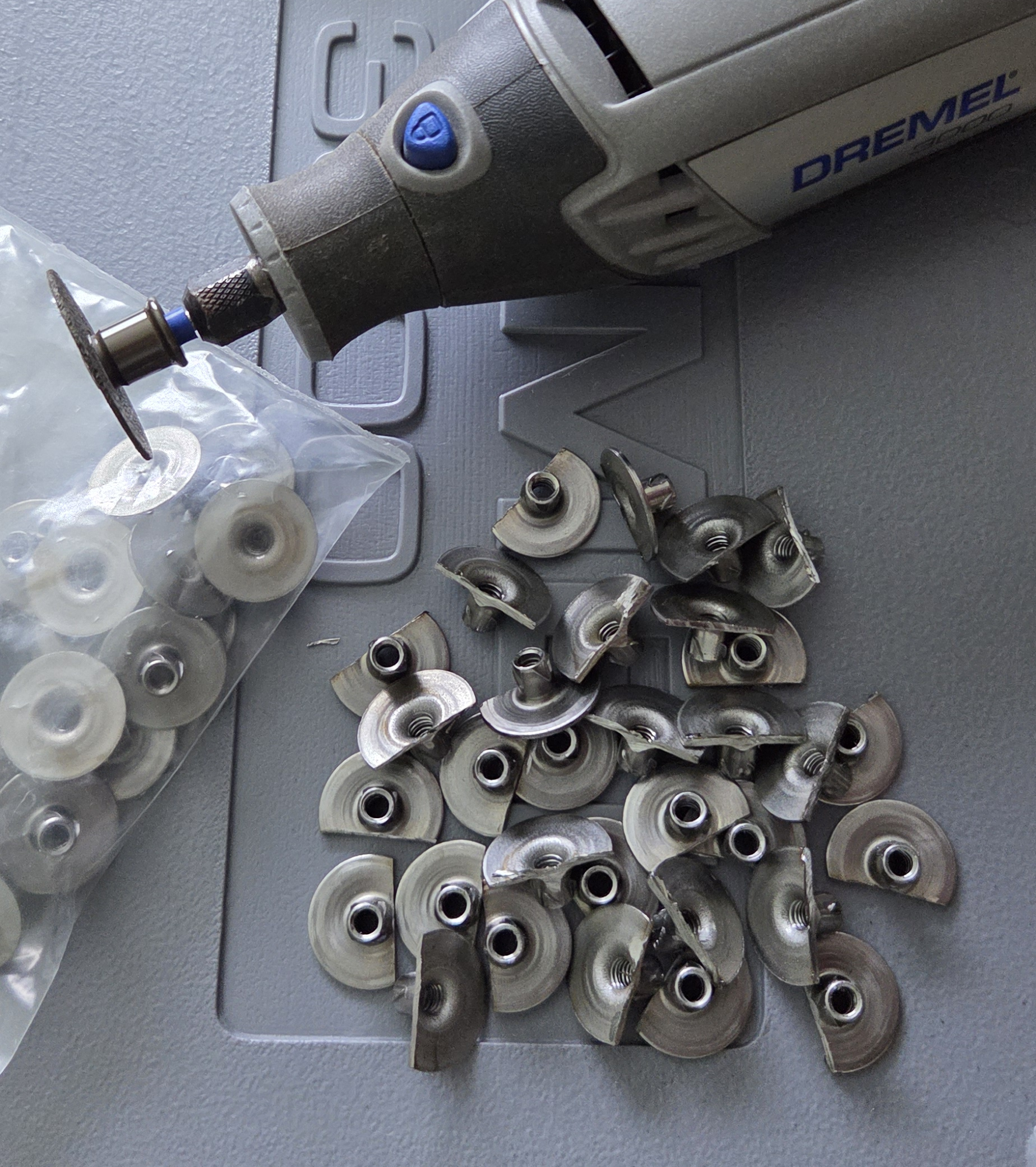

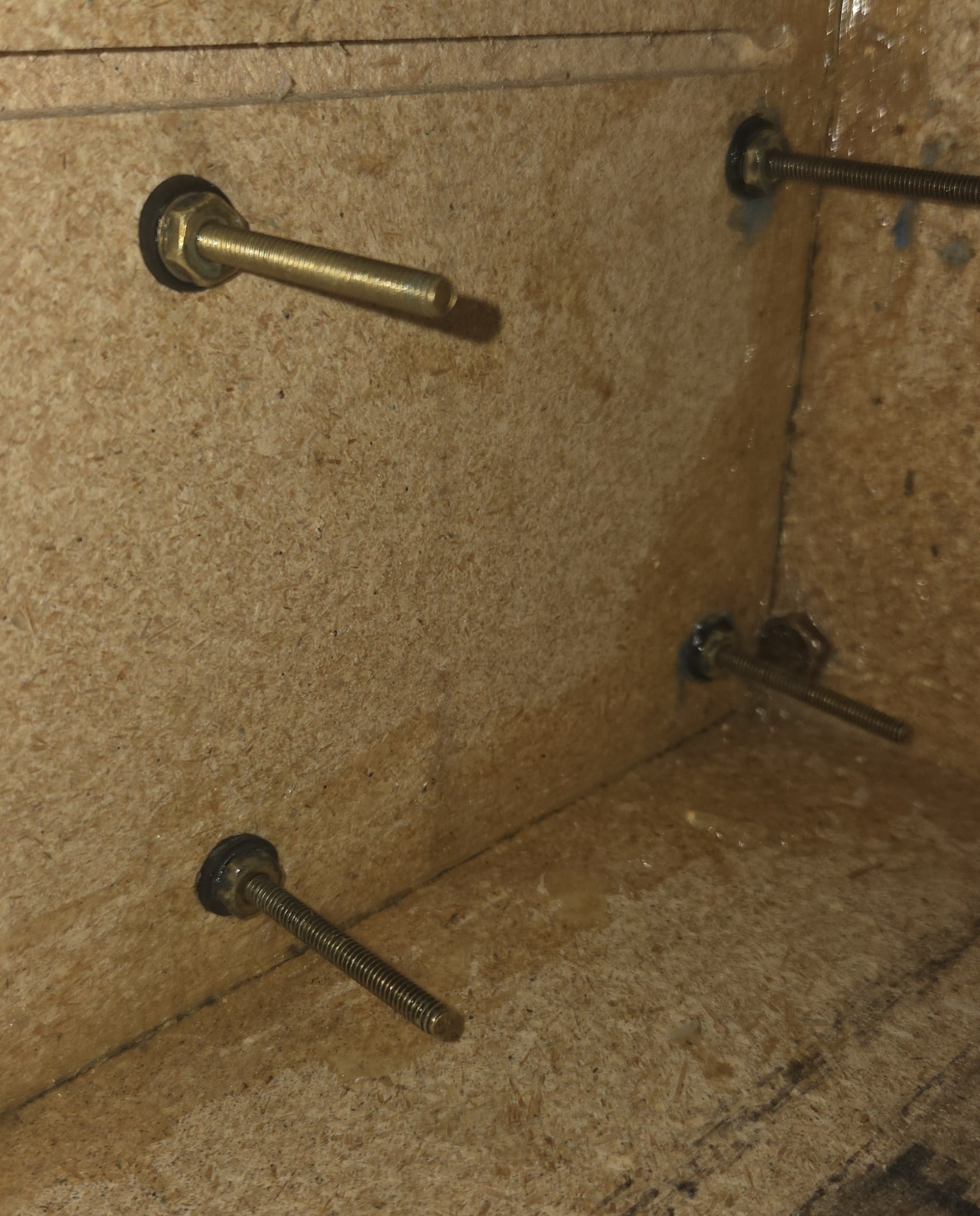

    Hurricane nuts trimmed. I clamped 'em in a bench vice and used my Dremel with a metal cutting bit. Short work.
  • drop1
    drop1 Posts: 69

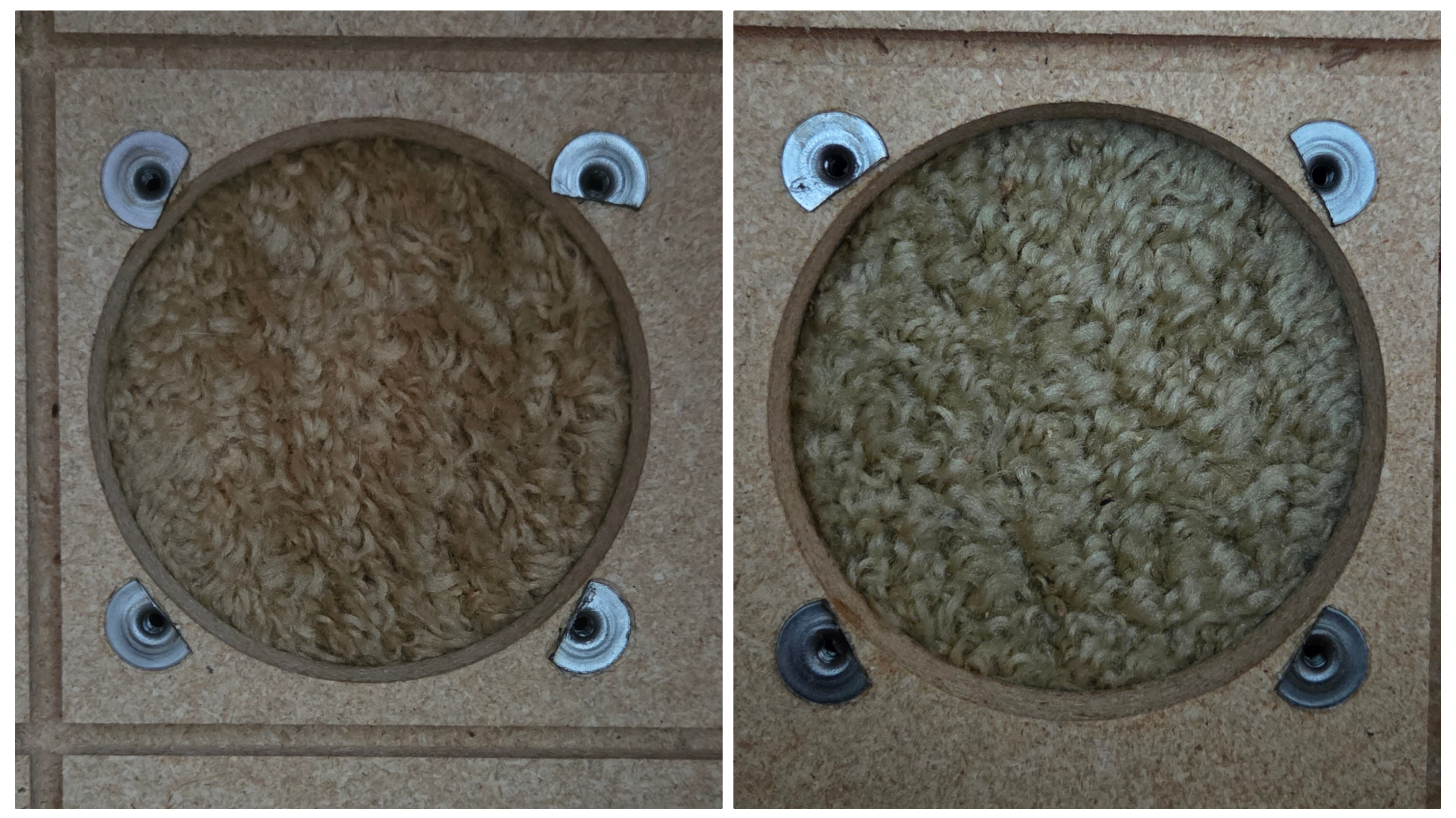

    edited September 2025
    I finished up the hurricane nut installation last night. I followed the advice of past forum posters. I drilled the cabinet screw holes out starting with a small bit and stepping up once and finishing with a 13/64" bit. I used a toothpick to distribute a small amount of Locktite Power Grab around the base of the nut. The nuts were installed by mating the bolt screw (w/ a small washer) through the cavity and to the nut and engaging the threads. I drilled slowly as the nut entered the cabinet. I stopped drilling when I could see it was tight and was careful not to overtighten.
    I started on the back. The first few came out a bit sideways. I fixed this by positioning the nut about 25% counterclockwise from where I wanted it to end up. As the nut enters the cabinet it will turn clockwise in the direction of the blades that lock it into the cabinet. The rest came out perfect.

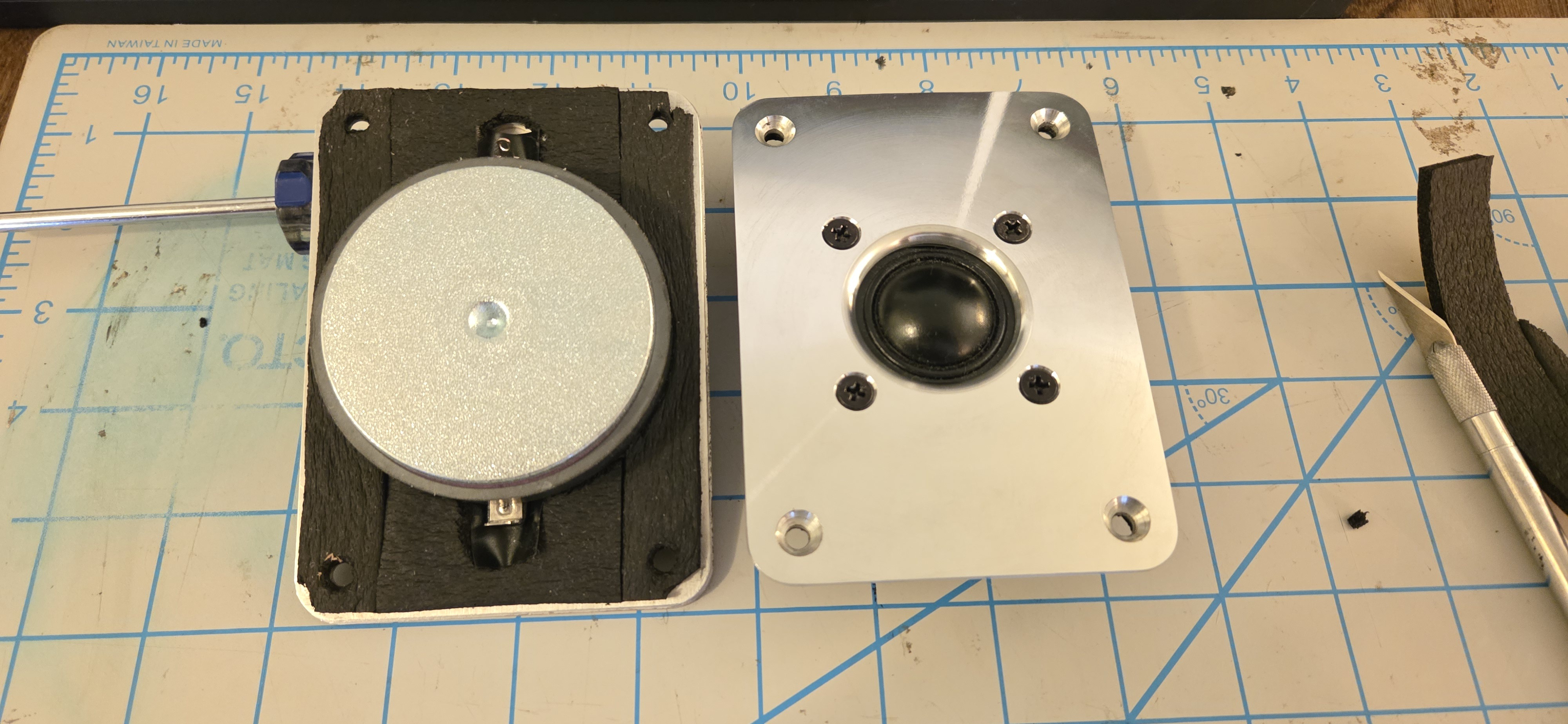

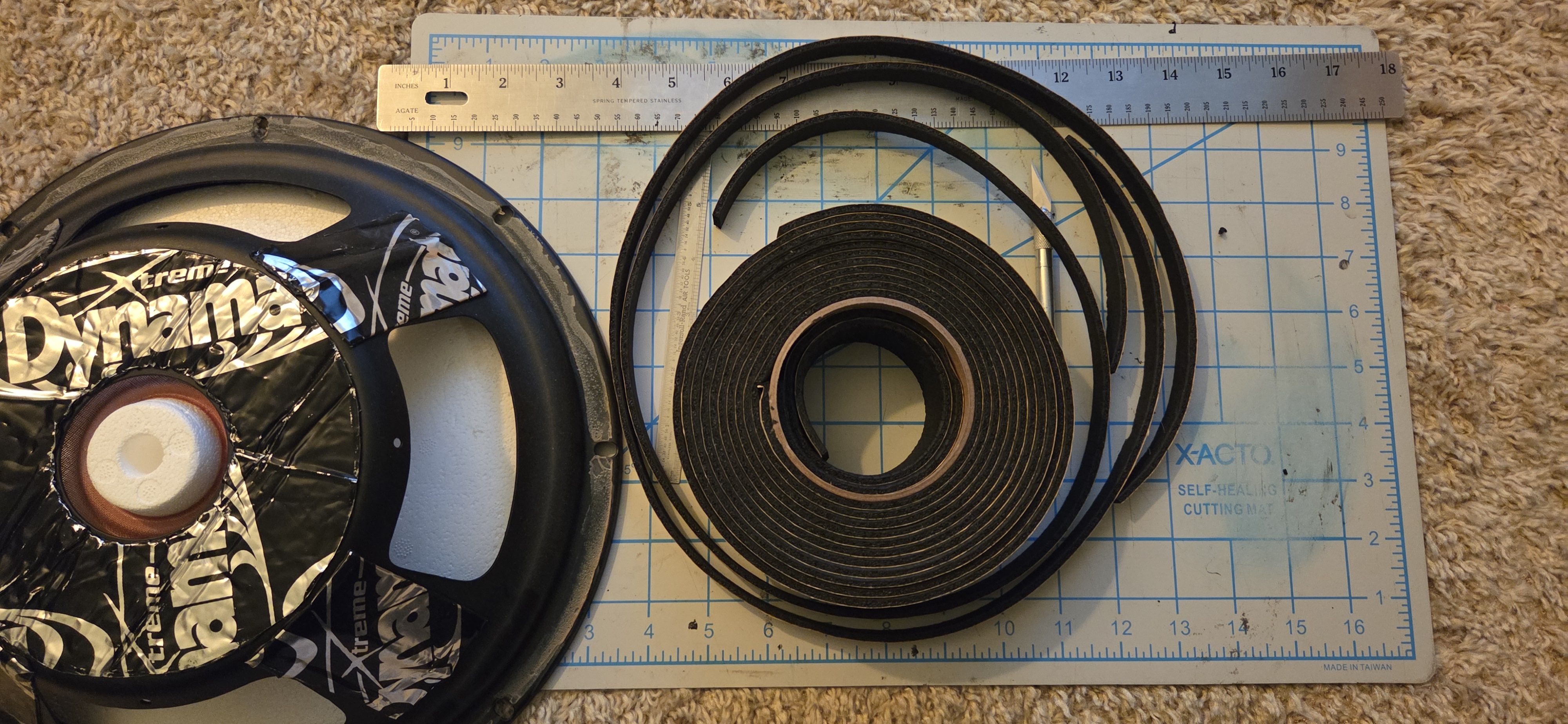

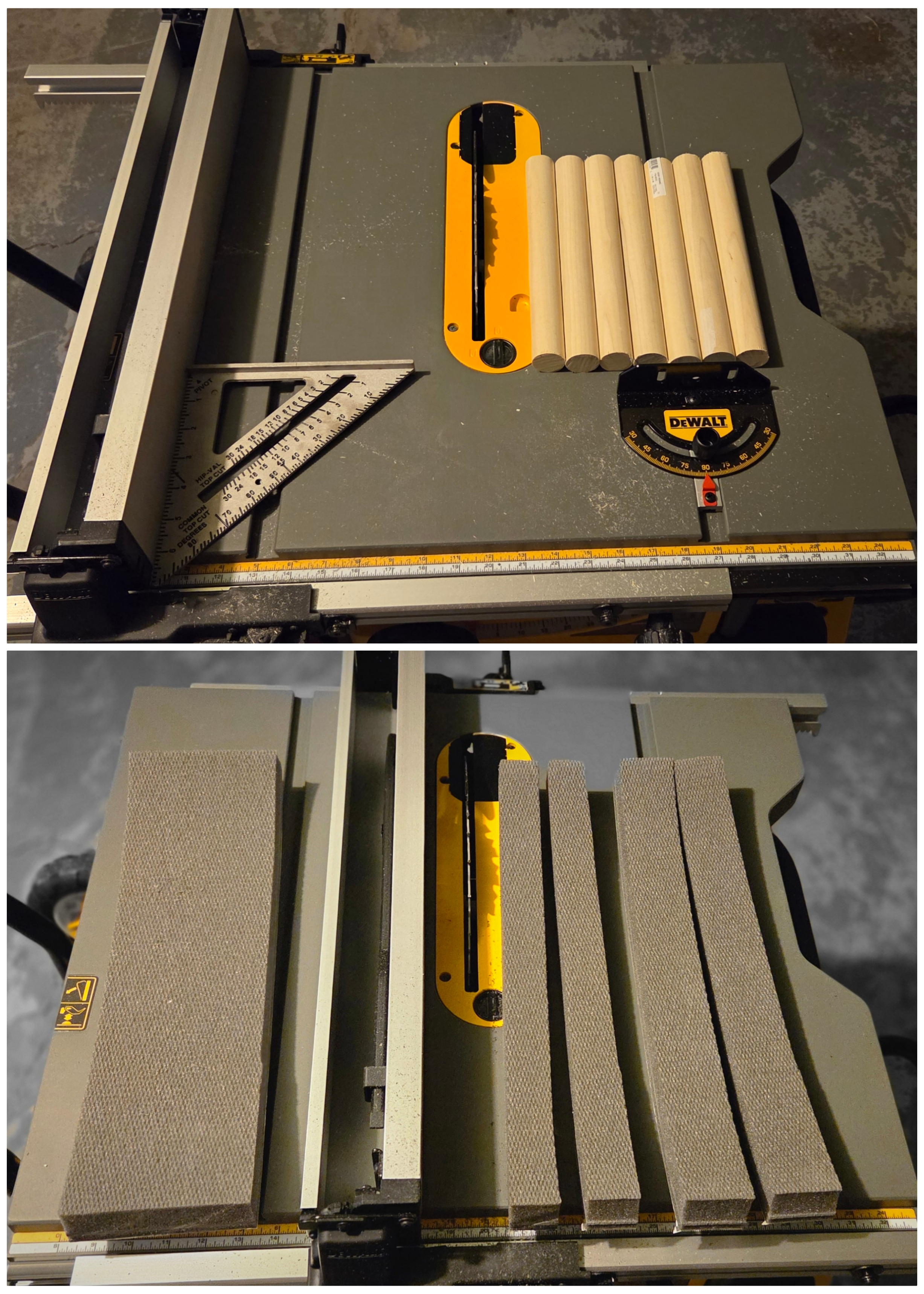

    Cutting Armacell Armaflex TAP18230 insulation tape
    Monotonous tedium!!
