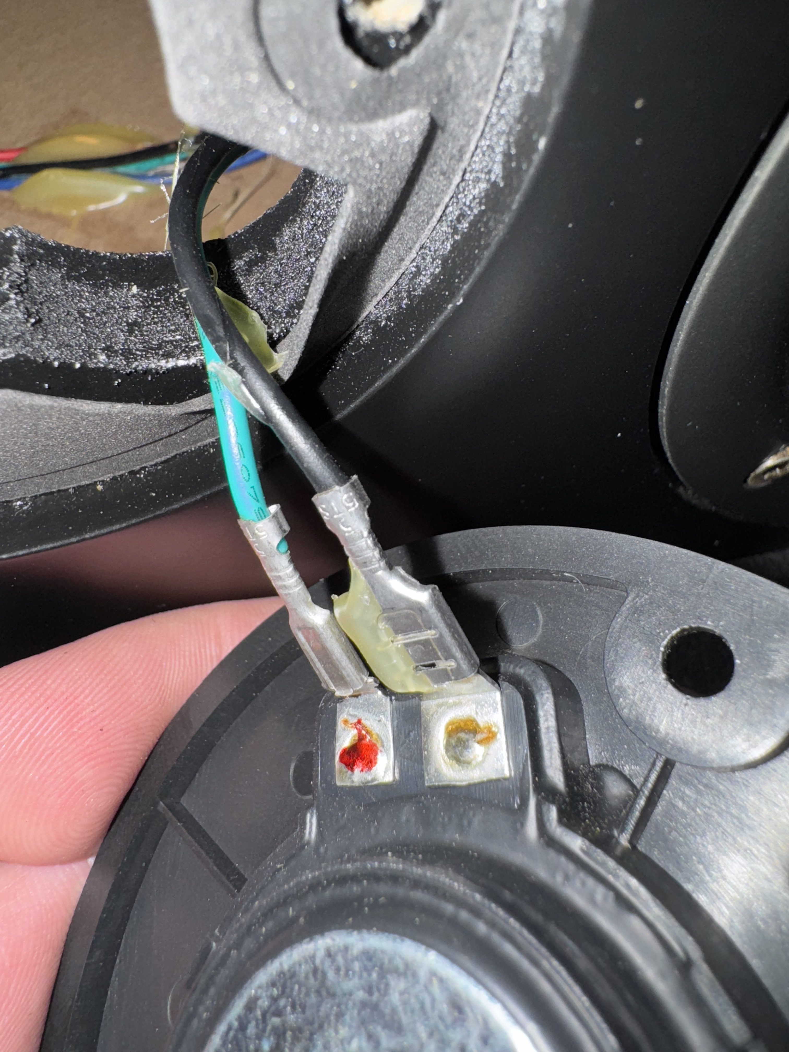

    Had to be hot melt glue. Unless theres a clearish looking solder idk about. It just had it on the - terminal. Would unplugging the + lead be enough to test it?
    Post a photo of that please.
    treitz3 Posts: 20,366
    Those are not soldered together. They are held together by the clip itself (mechanical compression connection), and you simply slide them off. You can't mess up putting them back in the right spot for correct polarity, because they are different sizes.
    That's an accidental drop of hot glue, but I doubt that is what is holding the faston to the tab. The faston or the tab has a tiny clip that locks them together. You have to pop the tiny clip free while gently pulling the faston off the tab.

    Well got my new center in and got that tweeter pulled out. Ohm meter read OL
    So I wasn't crazy and the tweeter is damaged!
