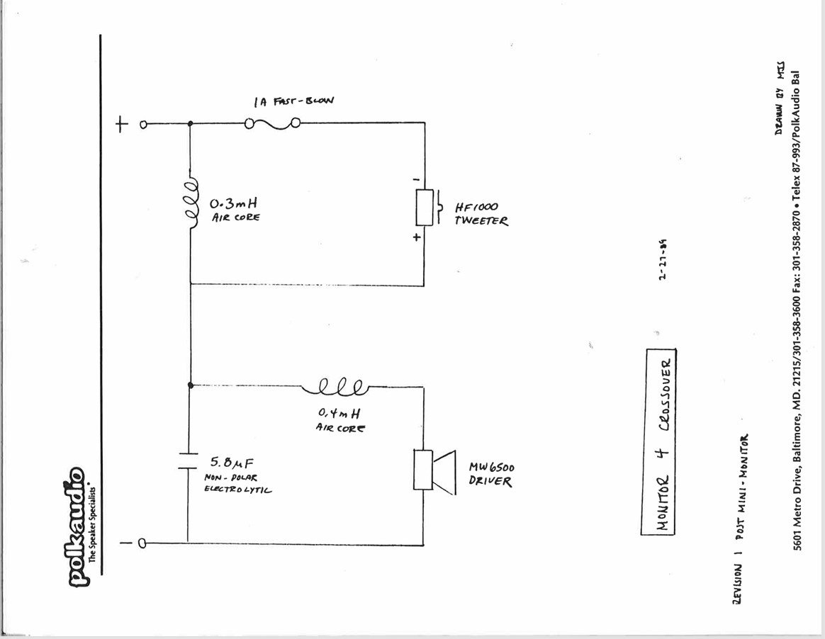

Attached at the very bottom is the schematic I received from Polk CS.
Apparently there is a discrepancy:
"...the cap is clearly in parallel with the tweeter, not the mid"
JS's drawing of my crossover:
Any opinions on my options here?
I was originally going to have him install Claritys but other recommendations are welcome.
    F1nut Posts: 52,011
    The schematic Polk gave you is for the version using the SL1000 tweeter.
    Post a picture of your speaker and its crossover.
    I don't know who JS is, but he is correct that the .02uF will act as a bypass cap, which you do not want. I'm surprised this person doesn't know that Sonicap has a 5.8uF.
  • kevinko
    kevinko Posts: 165
    Polk's schematic says "HF1000"... And I don't believe they made a Monitor 4 with the SL1000. So something is amiss.

    HF stands for high frequency and 1000 means SL1000.
    Anyway, best to replace the components as found.

    The date on that schematic is way past the time Polk was using the Peerless.

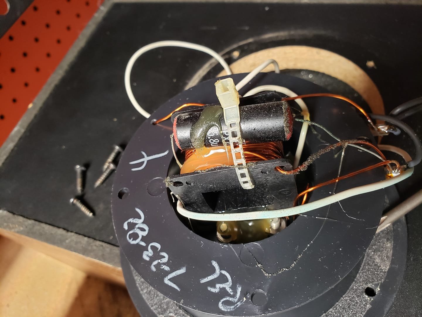

    Another 4 crossover from a previous thread:
    http://forum.polkaudio.com/discussion/174722/monitor-4-with-peerless-too-bright
    Mine again for comparison:
  • kevinko
    kevinko Posts: 165
    edited October 2017
    Any opinions on this new re-configuration?
    The old again for comparison:

    Just replace the capacitor. On a second second look at a 2 1/2 year old post I don't think the cap in either crossover pic is in parallel. Your pics show one lead of the capacitor going to the tab that then goes to your tweeter positive (correct?). Where does the other cap lead go? If it goes to one side of the fuseholder (that is connected to the positive speaker post) the capacitor is in series.
    Even if it is hard to see where every wire goes just trust that Polk put it together right. Sure there are a few documented errors in assembly that come up occasionally. But I don't think they screwed up every time they made one of their simplest crossovers. Just snip the leans and solder in a decent film cap. Easiest "rebuild" you could ever dream of.

    I have a set of the early 4's with the 3 component crossover.
    That 5.8 cap is indeed in parallel. One lead to the tweet ,the other goes to the negative binding post. The tweet coil is in series,one leg to the positive binding post, the other to the tweet positive along the capacitor.
    The low pass coil is in series with the woofer with one lead going to the pos. input post...also attached there is the feed to one side of the fuse...other side is white wire to the tweet neg lug. These appeared to be all original, but in my OCD I rewired them by removing the fuse from the circuit, placing the cap in series and the coil parallel downstream.
    I wonder if these early units were miswired...such that the coil and the cap were swapped at the binding posts.
  • jkdar67
    jkdar67 Posts: 2
    On further research it would appear that these very early monitor 4 crossovers are series type and not the more common parallel type.
    Perhaps it was to save some cost by reducing component counts, perhaps the designers thought it offered better performance,ect.
    Regardless I believe these are the only monitors to use this type of crossover, all subsequent monitor models use the more conventional parallel type

    My M4s w/ peerless tweeter and July 1982 XO.
  • Gardenstater
    Gardenstater Posts: 4,804
    Is the 5.8uf cap in series with the tweeter and the small inductor is in parallel?
    Do you have a 8 ohm Peerless with the MW6500?

    Here's what I think Polk was referring to as the HF1000. I have to say that they did refer to the Peerless sometimes as the HF1000 in the RTA11/Model 11 manual however, but maybe they were fast and loose with the ol' HF1000 designation:
    this is from Audio Oct. 1984
    George / NJ
    Onkyo A-8017 integrated
    iFi nano iDSD DAC
    iPurifier3
    iDefender w/ iPower PS
  • Gardenstater
    @dorokusai
    Maybe this semi mysterious unofficial redraw of a missing(?) original schematic should be put into the archives. I think the date is 2/27/89? Couldn't be 1984 as I initially though it was. The MW6500 was not being used in the M4 from 1984 on when they were using the MW6502 and they went to M4A. Also, the Metro Drive location wasn't pre 1986.
    So maybe HF1000 was indeed the Peerless.
    @volcano Make sure you have your Peerless tweeter connected in reverse polarity as per the schematic. Probably necessary to avoid a summation hump at the crossover freq.
