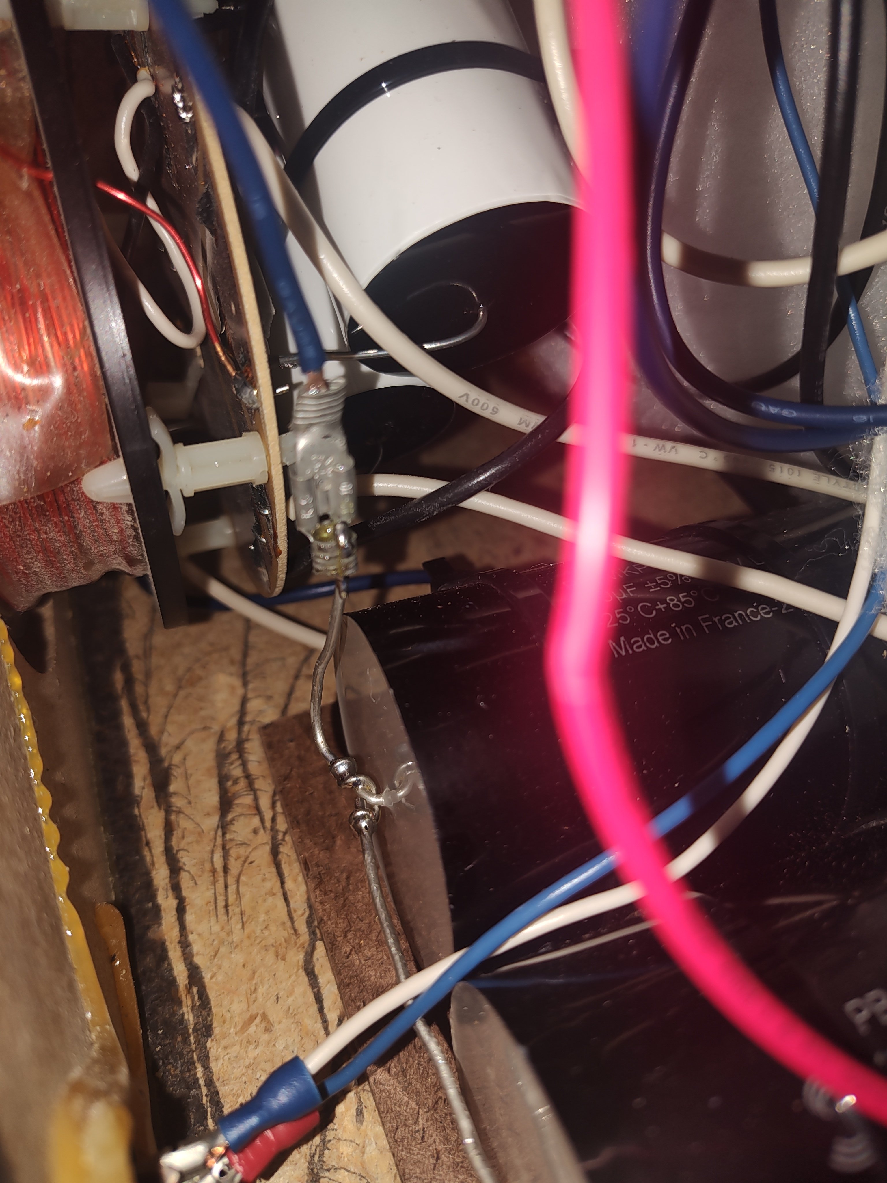

I rechecked the wiring, left PR out and played music, bingo, they work, dimensional is working based on changing balance. Before I button them up and based on how I soldered the two caps together, does this look correct? I'm pretty sure it is unless you have to have both leads on each side connect to the spade??

I honestly can't make heads or tails of your photo lol- Not Tom ::::::: Any system can play Diana Krall. Only the best can play Limp Bizkit.
lol, yeah, it's fricken cramped in there. Basically, I'm just over thinking this is all. I was just wondering if the caps were soldered the right way and not in series, but there is no way these are in series the way I have them. Thats what happens when you wake up at 3:30
Series would be like Christmas lights
Parallel is like a big hug- Not Tom ::::::: Any system can play Diana Krall. Only the best can play Limp Bizkit.
