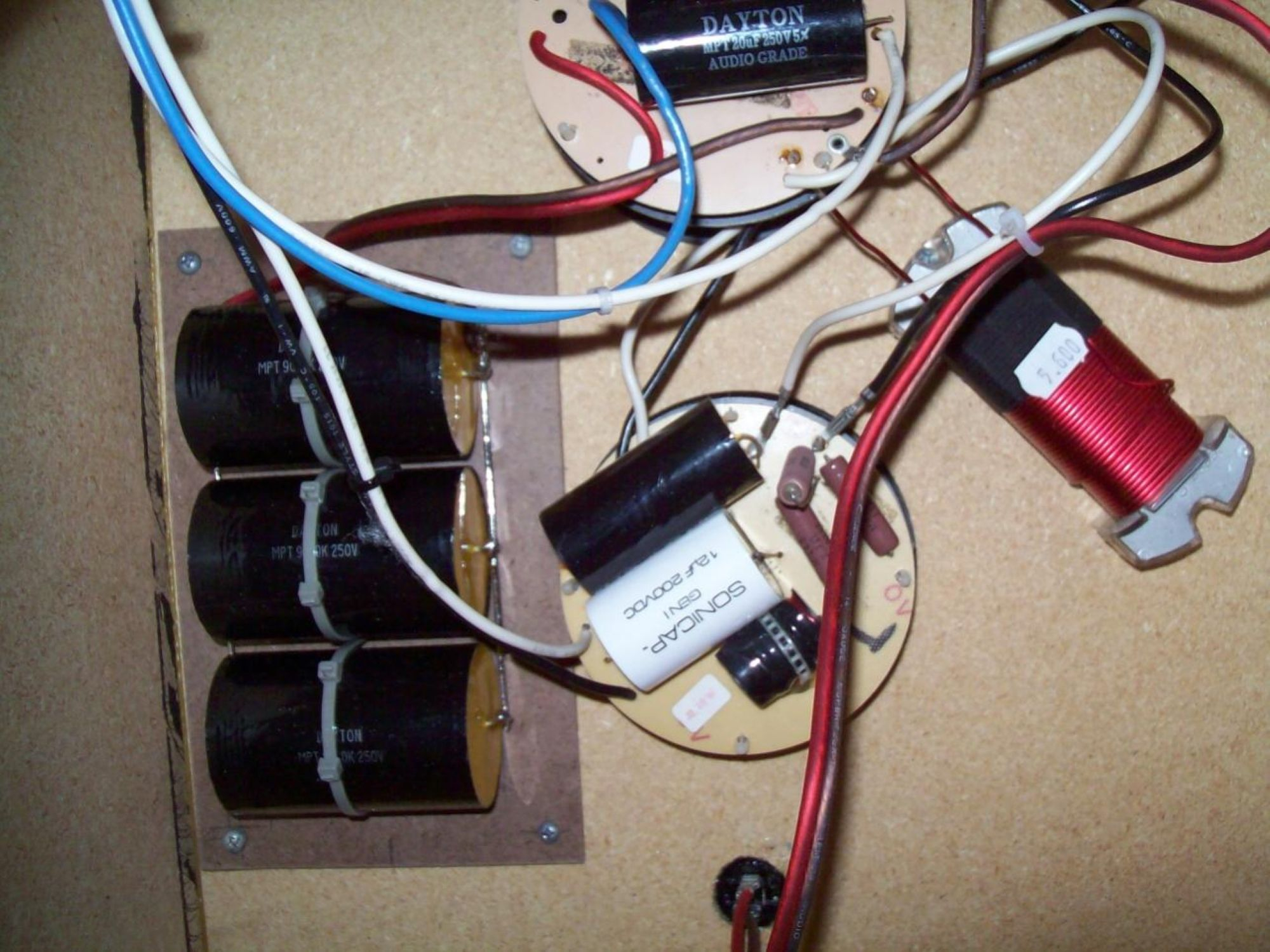

    I purchased some solen caps, two, 130's. Those will not be mounted in the same place as the three caps that are there now. Do you think I could mount the C-coil in that space since those caps will be moved?
    Thanks.

    Oh, my lord, the coils are that big? And those crossovers, etc. are unreal.
    How about where the super Q is mounted in this pix, or in that gen area?

    And what caps are you using, they look like clarity caps, but i don't see the values that would get one to 260?

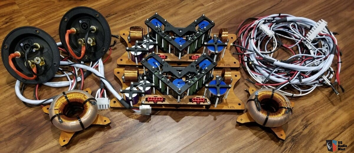

    The picture @VR3 posted looks to be for the SRS 1.2 NOT a SDA-CRS model. He is a big Clarity cap fan.

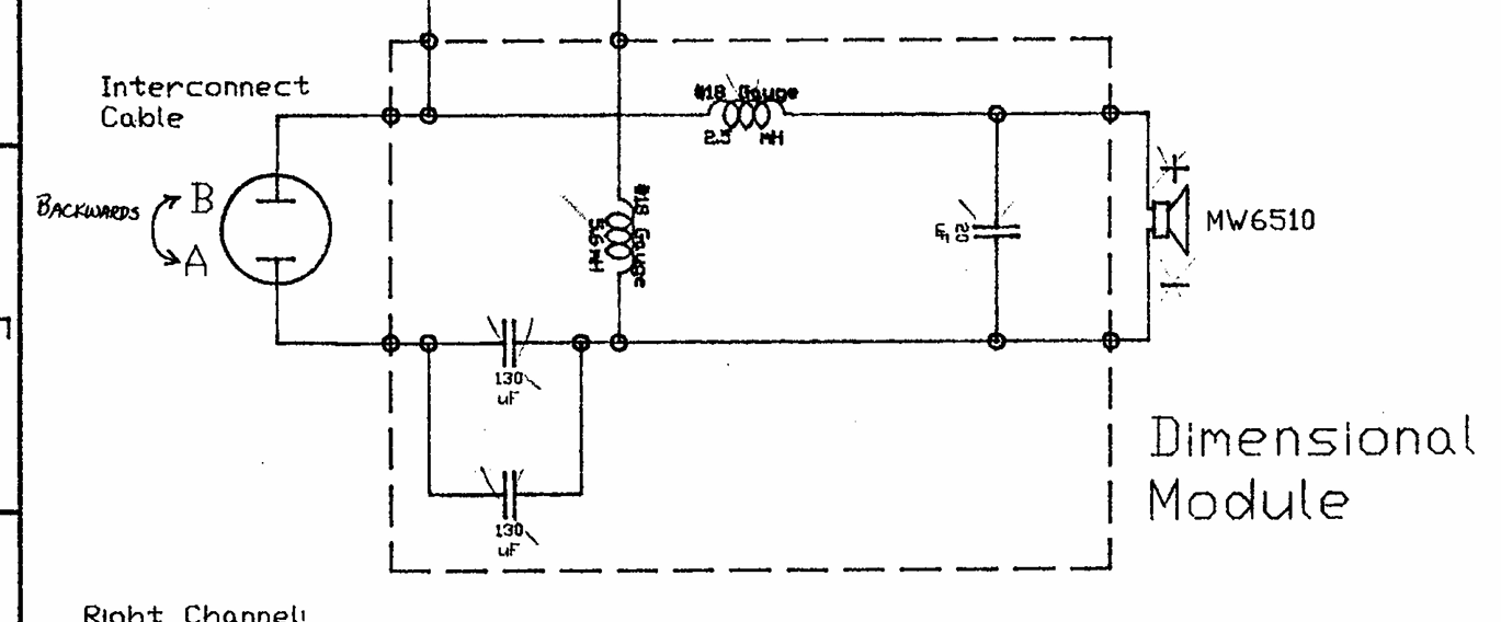

    Uh oh, did I make a mistake? I was just looking through the different schematics and my speakers are blade, blade. In other words, did I just install the wrong inductors?
  • Gardenstater
    Gardenstater Posts: 4,921
    edited April 2025
    If you installed any values other than those above, I'd say yes. Unless it is a trick question

    Not a trick, I got caught up and didn't do my homework. Assumed all crs's had 16mh inductors. No wonder it sounded, off. Fark. Oh well, out they come, hooking the old ones back up for now. If anyone in the future posts that they are looking for 16mh, have them message me.
    VR3 Posts: 29,731
    Just unwind it to the right value
