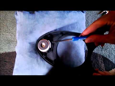

Those tweeters use ferro fluid, may need to change- Not Tom ::::::: Any system can play Diana Krall. Only the best can play Limp Bizkit.
Thank you. Is it easy to change and worth it (cost, time)?
hey @VR3, since you seem to be one of the modding experts on this form, I was just wondering if you knew how easy it is to replace a RT800 tweeter. Is it just cut a wire and solder the new one on sorta thing? Thanks
Turmoil6909 wrote: »Thank you. Is it easy to change and worth it (cost, time)?
https://forum.polkaudio.com/discussion/185061/ferrofluid-replacment#latest- Not Tom ::::::: Any system can play Diana Krall. Only the best can play Limp Bizkit. -
Perfect! Thanks so much
So easy.......a caveman can do it???Set up: 11.2 HT + 2ch
https://youtu.be/GoIiZv1qst4?si=22_RLgZMBVIMxWAy
