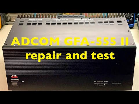

    The words 'if you slip... lethal voltage' = guy-with-the-nerve-condition-will-not-do-it-on-his-own
    https://youtu.be/fRzTHxyQWQI?si=P4VLc6UG_R4039OG

    audioluvr Posts: 5,884
    The refurb process is quite involved and unless you have an oscilloscope and a frequency generator, and the skill set how to use one you will probably just end up blowing yourself up. Second thought. Go for it!

    @plastic_avatar I don't know if you saw this in the comments of that vid:
