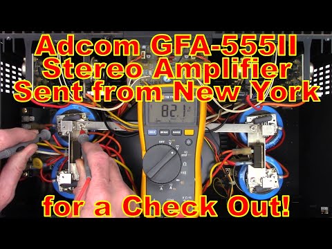

    I couldn't find any good memes (lol) but maybe this video might be useful. He cleans out the amp with a shop vac (good technique), checks DC offset (got anomalous reading that turned out to not occur when playing music...weird), checks and adjusts the bias voltage, and checks the temps inside the amp with an Infrared camera (parts do run on the high side with this amp).
    https://www.youtube.com/watch?v=R-3MPSs3K_I
