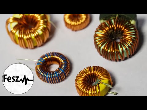

    This guy has done the work most of us don't have equipment to do, and in the video below it will help you feel better about these giant coils, and their affect on nearby components:

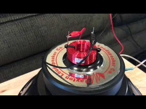

    Also this guy does some great testing between parallel and perpendicular placements in relation to nearby drivers: https://www.youtube.com/watch?v=Vs1phXWgZsQ
