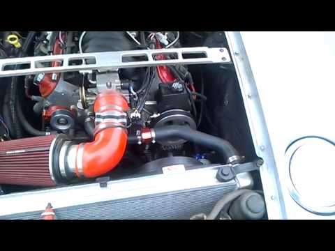

    Sometimes an LS is the only option, unless you enjoy polishing a garage paperweight...
    https://youtu.be/vy0eWHuWmnk

    Toolfan66 Posts: 18,332
    An overpriced Pacer. Still some of the ugliest cars ever made, reminds me of an upside down bathtub..
    xschop Posts: 5,687
    edited March 2023
    That was a fun Pacer that out-ran a few Vettes. The look on the other drivers' face was priceless.
    Last I heard, the new owner's kid blew out the tranny.
