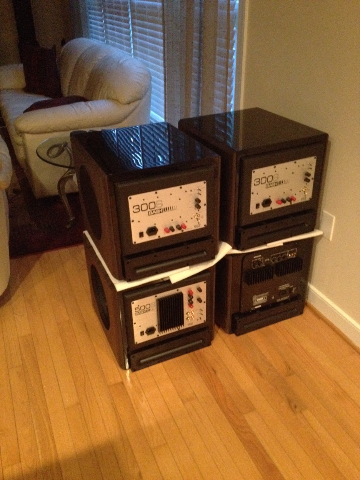

    I like the PSW1000. I had a PSW650 for 10 years and never had a problem with it. Amps do go out on any powered speaker over time, but there are excellent aftermarket options that can easily match/outpreform the stock amp and only need slight modification. The BASH 500 and Dayton500/1000 work quite well. I prefer the BASH since it is of the same design as the stock amp and is quite light and doesn't have all the pops and ground noise the Dayton's do. Although, the Daytons are quite strong performance wise and offer the parametric eq which when set at 22hz -4db work wonders in combination with the 31hz stock dayton sb filter. The Dayton is also an easy install since you just need to cut the stock hole slightly bigger. The BASH can be bought cheap if u wait for the Deals P.E. runs every six months or so, but will need a template to fit and will either need an aftermarket subsonic RCA type($13) sb filter in addition to the stock 30hz to match the odd porting (41hz) of the PSW1000. Or a better solution is to buy some mdf and extend the port inside the box up to within 1" of the front control panel changing the tuning to a low-mid 30hz at the sacrifice of some top end 100hz+ ( but who really plays a sub over 80hz?) This works amazingly well and gives the PSW1000/LSIW box the bottom end that you would expect (approching my micropro4000 level for 1/5the the cost, plus a much more attractive design if its going to be placed where you can see it) without sacrificing max spl (since you have 25% more power at least) or the great music playing ability of the stock psw1000. I have a RT5000 system +psw650 i bought new, added 2 micropro 4000's last year and then sold the PSW650 a few months back and have been playing with a bunch of PSW1000's since then. (i had to buy a pallet) I have a very large room that is vaulted to a large game room and open to the kitchen so i have found that having way more subs than most would expect has produced the best sound. I can watch a movie and not have bassy voices or background noise but then have a random gunshot hit me in the chest and move my bud light... In my home gym (which is much smaller cubic feet wise) i run POLK RT2000 with a PSW1000 and its almost as strong as my theater set up which has (2) 6.5", (4) 8", (2) 10",(2) 12" with passive radiators and about 6800peak watts just for bass!! so room size makes a big difference too. LOL Polk should make me an honorary salesperson. I have sold a ton of speakers for them over the last 12 years. I wouldn't stray away from a psw1000. Especially if i already had a LSI speakers since it would match. I am going to take the side pannels off one of these and make new ones since the RT5000 package i have is DARK Cherry..

  • Nice job installing the BASH 500 amplifier on the PSW1000. Would you be able to post more pictures of how you were able to get it to fit?
