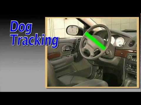

  • verb
    verb Posts: 10,176
    Interesting. In my experience we call it Dog Tracking. Usually requires a 4 wheel alignment at a minimum. If it still persists, then yes something is damaged or worn out in the suspension.
    https://www.youtube.com/watch?v=GmKkmcmi4_k
