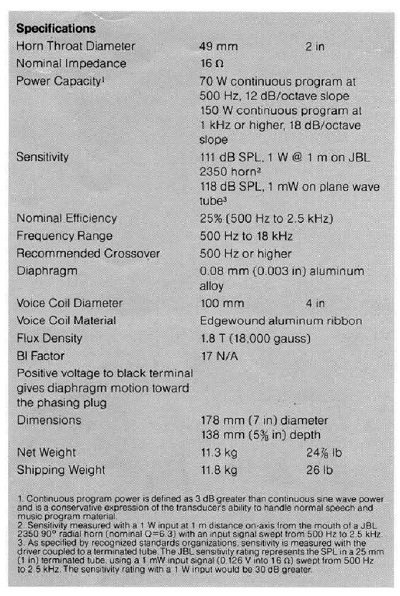

    The classic Altec Duplexes employ large and heavy (i.e, powerful) AlNiCo magnets for both the woofer & treble drivers. The high magnetic field and high flux density of these drivers is used to afford high sensitivity as well as high linearity. Sensitivity has rather fallen out of favor as a design criterion for loudspeakers, since watts are dirt cheap any more. :(
    The Altec woofers (like their contemporary drivers from JBL) were low-excursion drivers with huge (3 to 4 inch) but shallow voice coils -- very different than the current fashion in woofer design.
    The treble (compression) drivers likewise used large diameter VCs and truly massive AlNiCo magnets. The JBL 2441 treble drivers I am currently using weigh about 25 lbs
    each. Not all of that's magnet, of course, but the magnets in 'em are pretty beefy.
