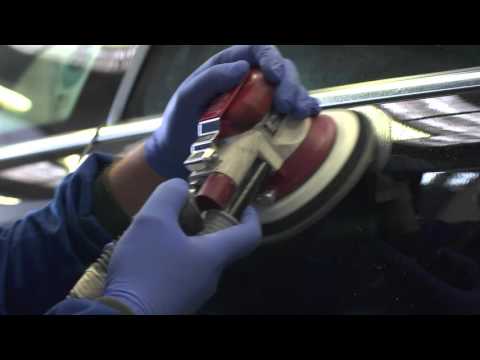

    OK, so you're done with sanding. Once dry, check for consistency again. if you see anything that doesn't look even, wet sand with the 6000 grit some more. When you get an evenly sanded surface, get your polisher (you will need a machine for this step, by hand is going to take a very long time and not give you an even finish). The surface will have a dull sheen to it at this point. Mainly because 6000 grit leaves microscratches too small for your eye to discern. It should look like a car with oxidized paint. That's good. So following the directions on the can of polishing compound, get to work polishing your clear coat. Be careful to not burn the clearcoat as you will need to do a ton of work to fix it. So keep the polisher pad wet and moving.
    This video shows you how to use a polisher to do the final polish on the clear coat. Go to about 1:04 in the video as you won't have to do the sanding part. You can get polishing compound for a clear coat in the body work section at any car parts store.
    https://www.youtube.com/watch?v=26FAieu05DU
    When you are done you will have a black finish so much like a mirror you can shave in it. You can wax it with a sealer and a car wax at this point too and that will further improve the shine and keep water damage to a minimum.
