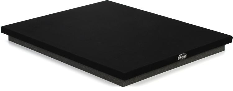

    Went ahead and "splurged" and ordered the Auralex Subdude HT. It ended up costing me little to nothing since I sold my MiniDSP to offset the cost.

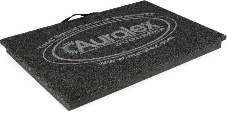

    Like the way it looks better than the Auralex Gramma v2 since its got no logo. Its 3" wider than I need, but the dept is perfect. The Gramma was the perfect width at 18" but was 1" longer... but I'm OCD about clean looking gear and the logo would bug me even if not visible.
    Subdude HT:
    Gramma v2
