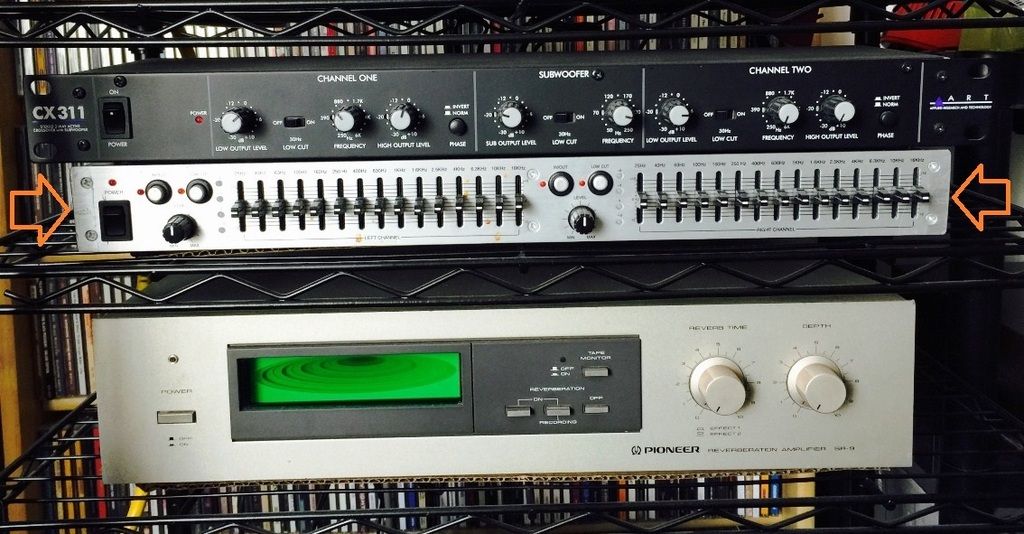

    I've used my Dremel rotary tool with metal cutoff wheel to remove rack rears before. I followed up with a flat file and emery cloth to neaten up and deburr the cut edge.
    FullSizeRender.jpg~original

    I have a waterjet at work but they would never let me use it for home projects, mostly use for steel but it cuts aluminum like butter. and thick aluminum can build up heat quickly (not if using a waterjet though), I drill & cut and rout and burr aluminum 10 hours day 6 days a week now :(
    cutoff wheels are not so easy to use and make a straight line, trick was always to cut as close to the line as you can and then burr till the line disappears.
    bandsaw makes quick work of cutting aluminum, but that is if your working with the metal in the flat.
    Dremel works ok but god it make one heck of a mess. I've done the same to put in IEC socket, then small files to make final niceness.
