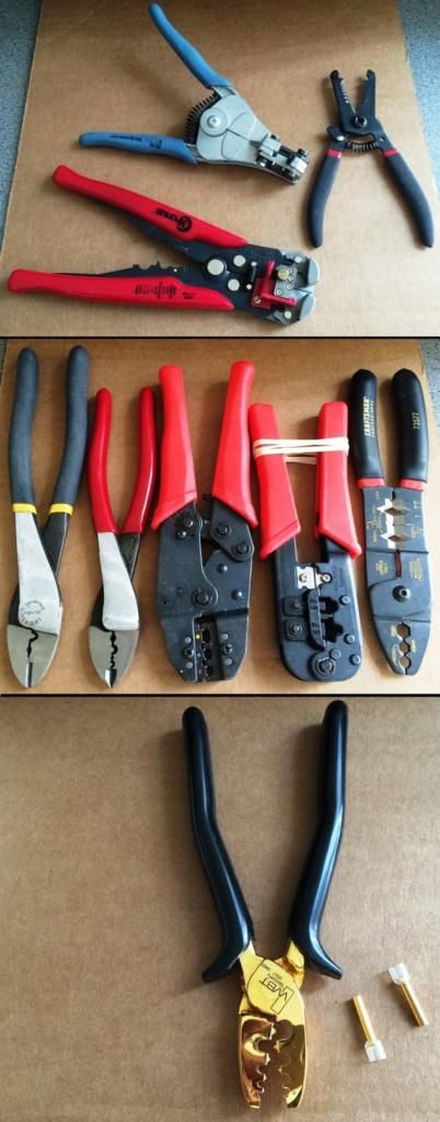

    No photos....but I am in the process of shortening another cable for my HT, when I concluded my wire stripper tool is dull as hell. Is there any secret to keeping these sharp? I have gone through 3 now in my lifetime (2 basement finishes and numerous audio related uses) and was wondering if I just pitch these?
  • Glen B
    Glen B Posts: 269
    edited August 2014
    kevhed72 wrote: »
    I have been using my strippers regularly for many years and have not had any problems. You need to start with good quality strippers. Ditto for other hand tools. I have two automatics and one manual that I use depending on type of insulation and location. The same for cable assembly and crimping, you need the right tools for the job.
    IMG_0472-vert.jpg~original
