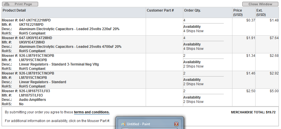

    We decided to get components from Mouser, can you verify the cart list attached is right?
    Sorry, just want to make sure the components are good. We are opting for 25V caps instead of upping to 35V. Slightly smaller in size to allow easier soldering. This is for both speakers.

    Looks good to me. A word of advice if you haven't already ordered the parts: its a good idea to order one or two spares of each in case a lead breaks or something.

    Hate to bring up an old thread. I did all the updates mentioned above, and now the amp wont turn on. Any ideas as to what else needs to be done?

    So I did all of the above mods, and now the amp wont turn on. Any ideas? Before mods it did the buzzing clipping sound. Any help would be appreciated.
