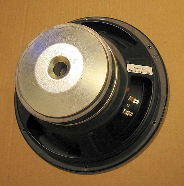

    The verdict is in.
    I installed new caps in one amp and reassembled a speaker. I wanted to listen to it for a day or two and put it through the paces before jumping to any conclusions.
    The rattle is completely gone after the spiders were re-glued by a guy at Polk named "Freeman E. Stills". I know that's who repaired them because he put "Repaired By" stickers on them with his name proudly displayed on them. He did one heck of a job and the subs hit real hard now!
    Also, the "hum" is completely gone from the amps.
    I can't believe how good this speaker sounds! I'm listening to music on them and they are awesome. I think I'll keep them!

    Here's one of the repaired drivers:
