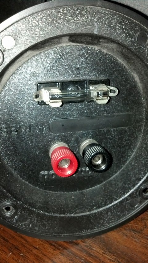

3 of the 4 work/sound great!, but i knew when i bought them there might be a problem with the 4th one....the visual problem is that it is missing the fuse terminal block that is supposed to be affixed to the terminal cup on the back of the speaker.
I called Polk TechSupport(nice and helpful!) to see if i could get that part, but none were available. However, they suggested I put a fuse in-line on the black wire going from the tweeter to the crossover.
I did that, and the tweeter seems to be ok, although it doesnt seem to sound as good as the other 3 speakers do.....
But, I hadn't hooked that 4th speaker up until then because i was afraid to without a fuse in place. So i didnt know until putting a fuse inline on that wire that there is another problem...the woofer/driver does not work at all. So, I need help figuring out the next step/s to take to get it working. My visual inspection is that everything seems ok, and the black and white wires are connected to the terminals on the driver.
One strange thing about this speaker is that the crossover/terminals inside are different than the other 3....on the 3 working speakers, there are 3 terminals( inside near the crossover ) with the black and white wires going to/from the tweeter and driver, but on this non-working 4th speaker, there are 5 terminals by the crossover. Since this one is different than the other 3, did i do something wrong in the placement of that fuse? It is definitely inline on the black wire that goes from tweeter to crossover, and when i bypass it, the woofer/driver still doesnt work....
Anyone have any ideas on what to do to get this driver working? Thanks
Attached are some pics of whats described above.

    Need many more pictures of the whole speakers. Not all Polk's were fused but they all had the same cup that made them appear to of had fuses. more pictures of cross overs wires and drivers
    in the second picture is a little yellow disc. that is the polyswitch (fuse) they started using after the external fuses. those are what protects the tweeter. remove the fuse you put in.
    so, maybe this one is just different, and doesnt need the inline fuse, since that is there?
    i will try to take some more pics
