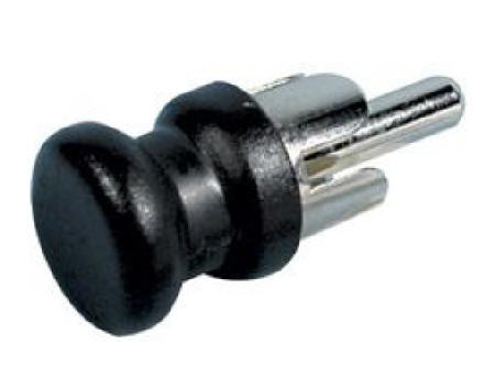

These shorting plugs are $0.69 from MCM, and can reduce noise in certain systems and environments. Do not use shorting plugs on outputs as you may damage components.
http://www.mcmelectronics.com/product/DISTRIBUTED-BY-MCM-ADC-0006-/27-5335
The shorting caps can absolutely reduce system noise. Not like, "Listen to the increased texture and depth!" but like, "Oh... that hiss I used to hear from 4 feet away is gone now". Will vary based on your system and the architecture of your pre, but doesn't hurt to try them out.Gallo Ref 3.1 : Bryston 4b SST : Musical fidelity CD Pre : VPI HW-19
So in looking at a picture of the back of my Citation 11 pre, I dont want to use it on Pre-Amp Output 2, Tape Output 1, or Tape Output 2 is what your saying correct?
Attachment not found."....not everything that can be counted counts, and not everything that counts can be counted." William Bruce Cameron, Informal Sociology: A Casual Introduction to Sociological Thinking (1963) -
if it is just on the ground ring how does it affect anything on the outputs? I think i could understand if they actually had a rca type end that went into the output jack.
could someone explain..
