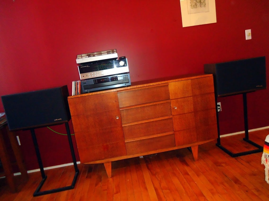

I am using a Harman Kardon 730 'Twin Powered' with a pair of SDA CRS+'s in the bedroom set-up for the last month and a half and it sounds amazing. I guess I got lucky and didn't even think to check the common ground issue before hooking them up. 40 Watts have never sounded so good, at least not in my home. I'll admit I am in love with that contour button, HK's equivalent to a loudness button that tapers away as the volume is turned up. Contour keeps it sounding full and rich when the volume is down low. At some point I'll have to replace bulbs as most of them are burned out but for now she works and works well and that's enough for me. I'll post a picture soon.Polk Audio RTA 12c's, Monitor 7c, Monitor 5JR+, SDA CRS+
Polk Audio SDA CRS+ (all original someday I'll do the upgrades and wonder why I took so long to do them, w/stands)
Harman Kardon 730 Twin Power, 40 watts and 29 lbs
Kenwood CD changer with variable output (volume remote control capability)
Denon DP-11F needs stylus...
DIY J-pole antenna hidden under cabinet gives me pretty good FM receptionPolk Audio RTA 12c's, Monitor 7c, Monitor 5JR+, SDA CRS+ -
