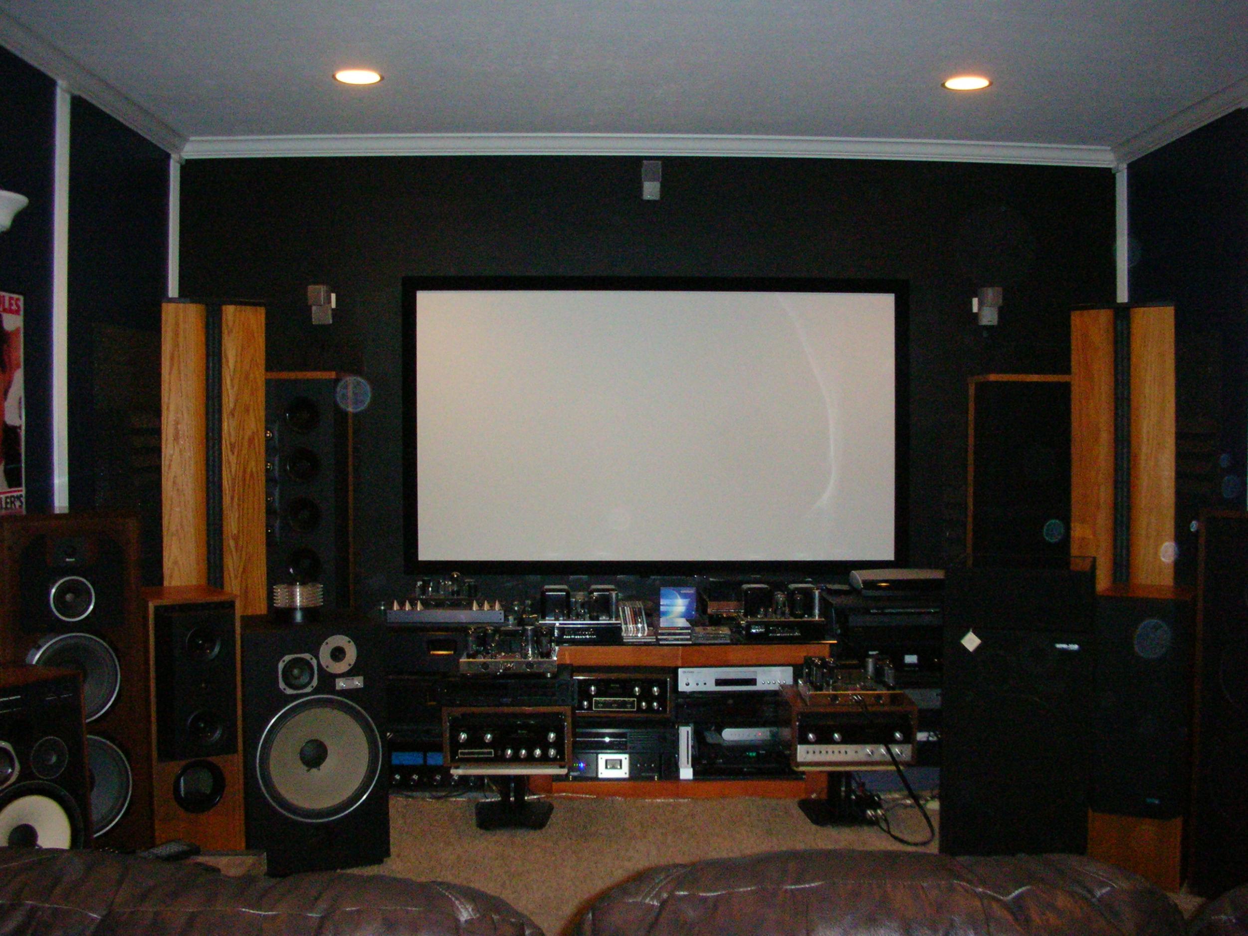

    Thought you guys might like to see a picture of "the Lab" you are helping me with. I know it has WAY too much stuff in it to sound optimal, but it's what I enjoy. One day, a room with a simple system and the Lab in another:) Thanks again.

    DSkip wrote: »
    Thanks! My wife will appreciate me more when I show her that pic. :mrgreen:
    LOL! That's a common reaction. Hosted a Superbowl party this weekend and most of the wives had this deer in the headlight look when they ventured into the lab for a look.
    My wife is generally good with this as long as it doesn't creep out into the rest of the house...too much. There are 2 more component, quality systems in the lower level; one more in my office; a micro system in the living room; and a vintage system in the garage. She's cool with this, but I've hit the rev limiter:)
