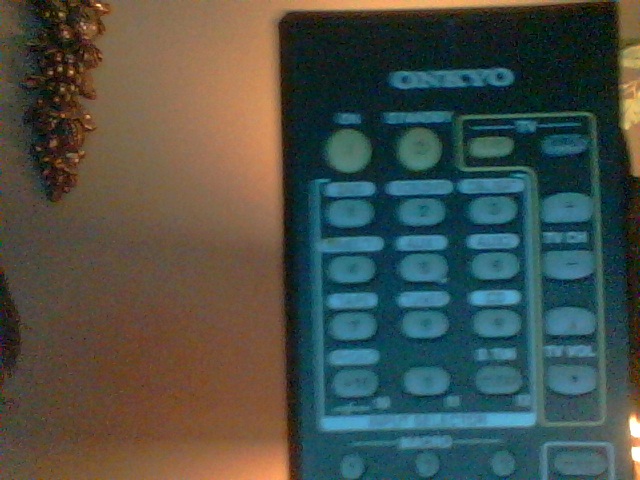

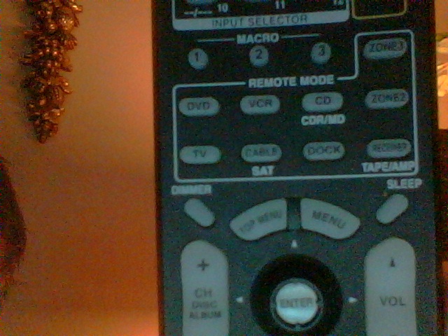

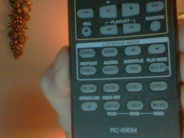

When I switch to DVD mode everything is fine?? By accident I hit a button on the remote and it muted the TV sound. I turned everything off and thought that may do it?? Not!! Hoping someone here has had this happen to them and knows what to do. Man does this make me feel pretty dumb! Thanks if you can help!:confused:
