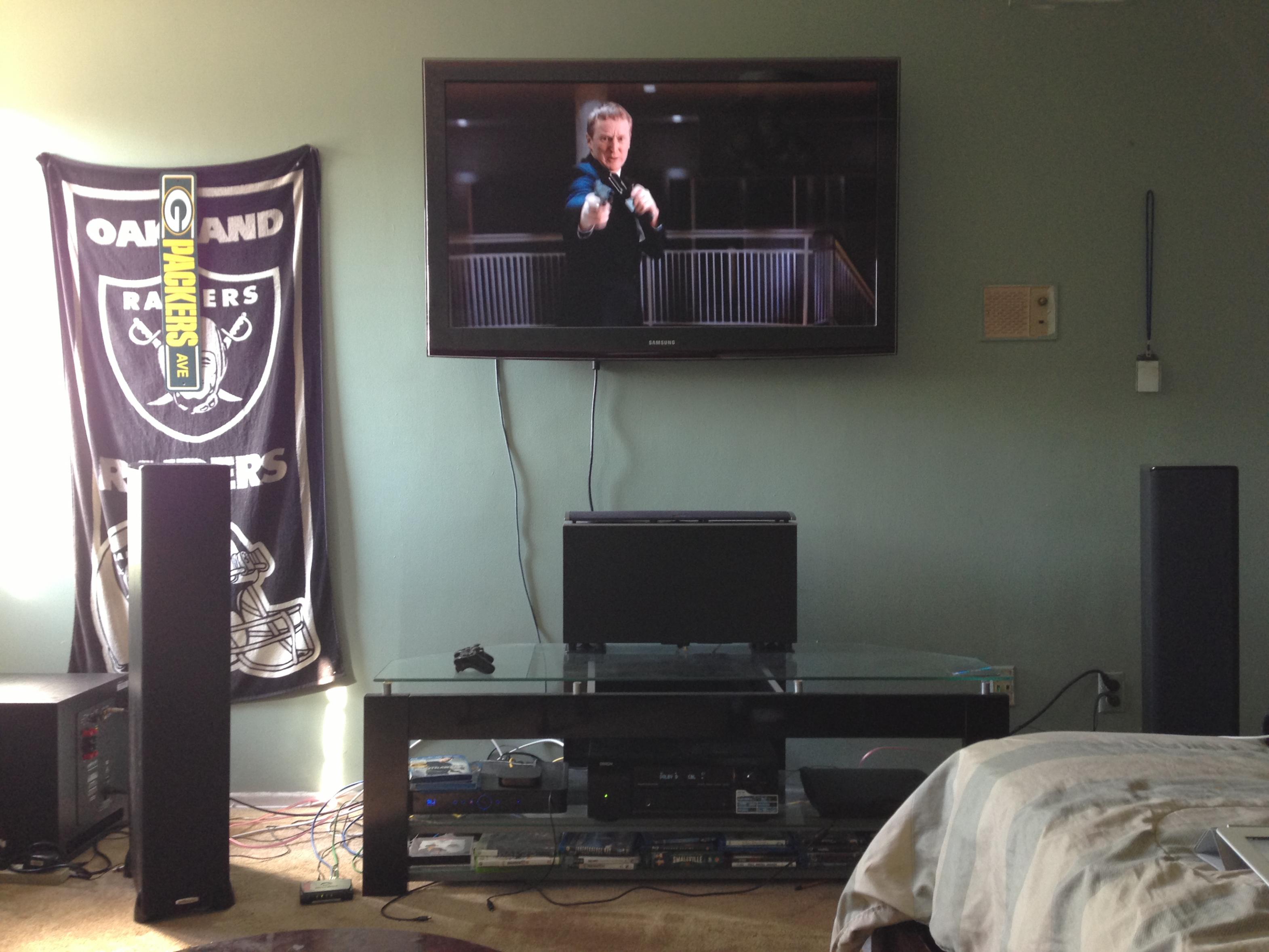

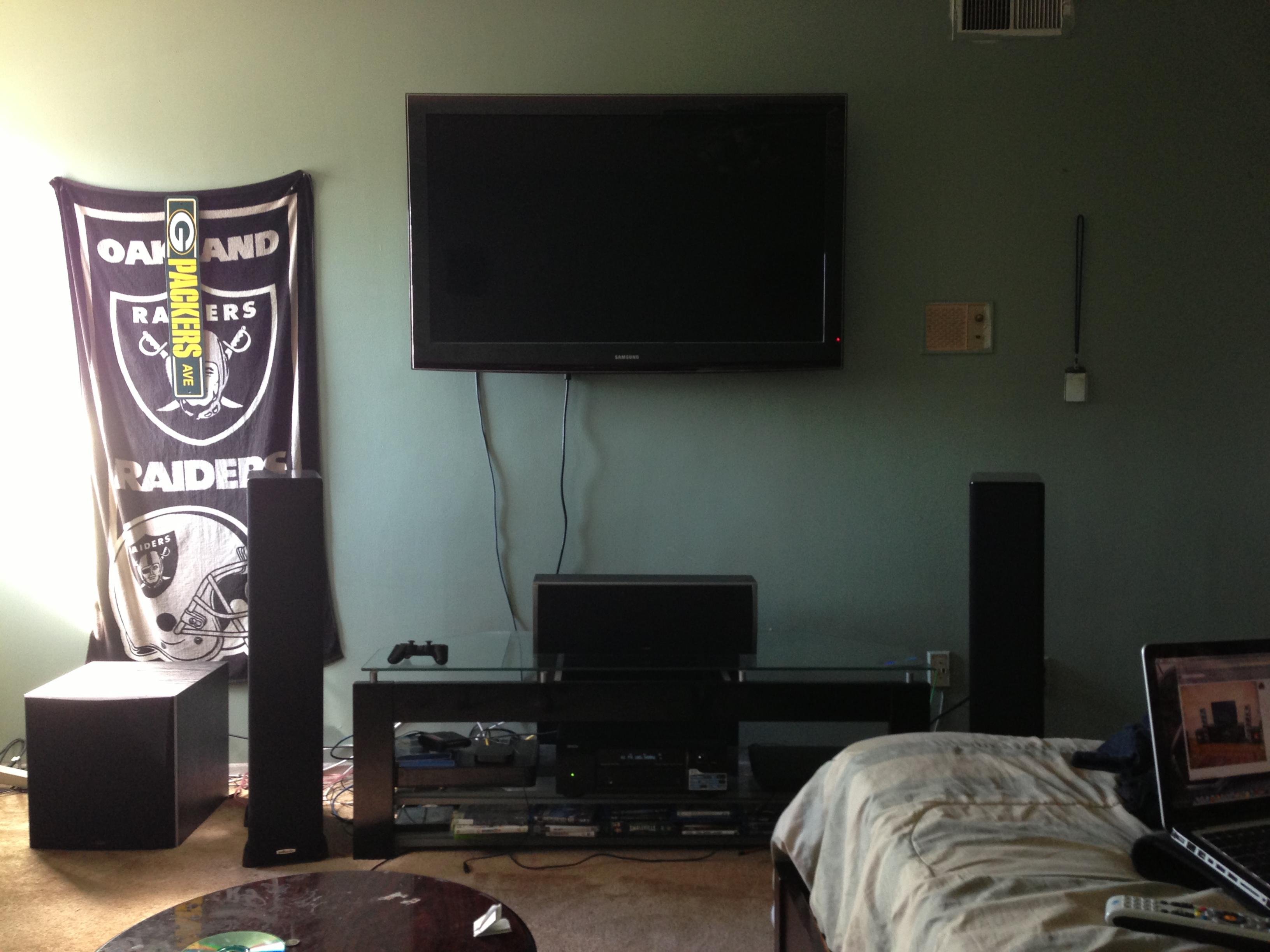

    My setup.

    Is that sub faceing away....into the window ??

    It looks like there's an object sitting right on top of the receiver. Am I seeing that right? I can't tell if it's an actual object or some kind of optical illusion having to do with reflections from the glass table top.
    Is the center channel firing at the ceiling?

    I have a 5.1 setup. The center channel is facing up and the subwoofer is facing the window. I take it those are not optimal positions. I do have a 5.1 set up. They're not pictured(the rears T15).

    Seriously, what determined that was the best possible setup ? The center facing up, the sub facing out and away, that sounds good to you ? Just asking, maybe it does.....have you tried the traditional ways ?

    Honestly I dunno. Ill definitely try the traditional way. I am fairly new at this and I thought the center channel looked cool facing straight up(fail). I'll reposition everything when I get home.
    I can't tell for sure, but it looks like there's an object sitting right on top of the receiver. Especially if you're powering the speakers with the receiver, there needs to be more breathing room above it.

    ^^ I noticed the picture gave that effect but there isn't anything on the receiver. So it should be ok.

    New Setup. The rears are hanging off the wall(not shown). I don't have much of an option with the rears. Unless I buy some kind mounts.

    Hello oleon621,sorry to derail your post.But your system will not sound right until you remove the Packers sign from in front of the Raiders banner!:razz:
