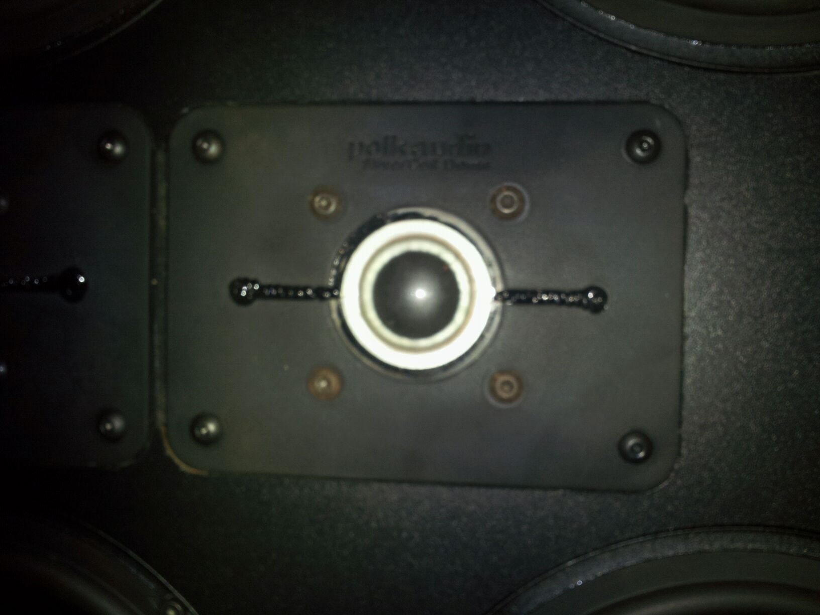

    Ok first thanks for all the info. Talk about feeling like I'm in the deep end of the pool. Being new here I really appreciate all the help so let me ask for some more if you do not mind.
    This is a picture of the tweets in my SDA's They say Polk Audio Silver Core Dome. I assume these are the SL-2000 version? So I need 8 of the RDO-194's. Any idea on club pricing? Polks service center is just down the road from me, wonder if I could pick them up there?
    Before I can update these speakers I need to replace those damn mono block amps. I know there are tons of amps out there to choose from but is there one that seems to work especially well with this speaker design? Am I going to want to Bi-Amp them?
    Again thanks for all the help!

    Your current tweeters ar definitely SL2000's. RDO194-1's are I believe still $48 USD delivered if you call Polk Customer Service at the number top right and mention you are a member of Club Polk.
