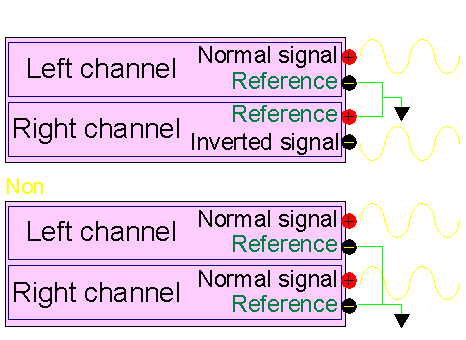

  • shadowofnight
    shadowofnight Posts: 2,735
    edited March 2009
    This wil help to visualize the outputs....

  • ShinAce
    ShinAce Posts: 1,194
    edited March 2009
    GV#27 wrote: »
    The neg terminals will already be connected internally.But when you bridge you use the pos terminals only,so it is no longer common ground as both outputs will be hot.
    I guess that's where I go astray, terminology. I would not speak of a bridged amp as common ground, since you're running it without a ground. A monobloc amp might still have a ground. However, I don't consider my bridged stereo amps as monoblocks.
    edit: both amps shown above are bridgeable. The limitation within the second layout is that the input signal hasn't been inverted for one channel.

  • Systems
    Systems Posts: 14,872
    edited March 2009
    ShinAce wrote: »
    Using a bridgable amp in non bridged mode, both of the negative terminals and power supply grounds will be at the same potential or common.
    When you bridge it the negative terminals are still common(connected) but the negative half of the waveform is taken from the second channels pos terminal which is not at ground potential.There is a ground just neither of the output terminals are connected to it.
    You cannot strap the outputs of two bridged amps together,but you can strap the outputs of two mono blocks that do not have bridged/balanced output stages because when strapped their grounds will all become common.:D

    So would that be 1.6 ohms or 160 ohms?
  • Systems
    edited March 2009
    Bikerduck wrote: »
    I measured the resistance today between the 2 neg outputs and it came to 01.6 on the 200 ohm setting. According to some posters here, that would mean it's a common ground. How can that be?
    Thanks
    Donald
    If you are getting 1.6 ohms then it is common ground.
    As Shinace pointed out earlier the probe leads will have a small amount of resistance as will any wiring that may be used to connect the neg terminals internally.Touching the probes together will tell you how much of that 1.6ohms is in the test leads.
