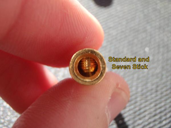

    I got my 3 styles Nikamichi stamped bananas yesterday and they seem fairly impressively built. These include the Standard bananna, the 7-Stick and the Saw Blade.
    The first thing that I noticed, besides the weight, is that the Saw Blade is more limited in the gauge wire that it will accept. This is because the contact (blade) runs all the way through. Unless you are using thick wire, this may be a positive the speaker wire is in direct contact with the blade. The other types may have more contacts to have to make. I can't be certain without dissecting them.
    Next I tried plugging them into my RTA11TL's and Monitor 5A's. Of the three, the saw blade fit the tightest. The standard was almost as tight and the 7-stick was considerable looser. I'll try other with jacks later. This does not necessarily mean that the saw blade makes a better connection. A small imperfection in the blade or in the speaker jack can create a high friction fit but have little surface area making electrical connection. However, in the absence of such flaws, I can see where the blade potentially can make a superior electrical connection.
    I would like to do ohmic measurements of the three but I presently lack equipment with the needed sensitivity. My Fluke 187 can only measure down to 0.01 ohms. If I can borrow a 4-lead milli-ohm meter from work, maybe I'll get some results.
    Something else I noticed about the 7-stick is that it has a longer end and sticks out further than the others. Unless I am missing something, I really seen no purpose for the 7-stick type other than it looks more elegant. But who cares when it is plugged in and out of sight.
    Recommendations:
    1) Saw blade for single contact with wire and snug fit. (assumes it will accommodate wire gauge and no significant flaws in blade or jack).
    2) Standard for good all-round fit (both wire and jack)
    3) So far, I don't see any reason for the 7-stick. Potentially better contact area assuming that they stay in the jack. Maybe I'm missing something.
