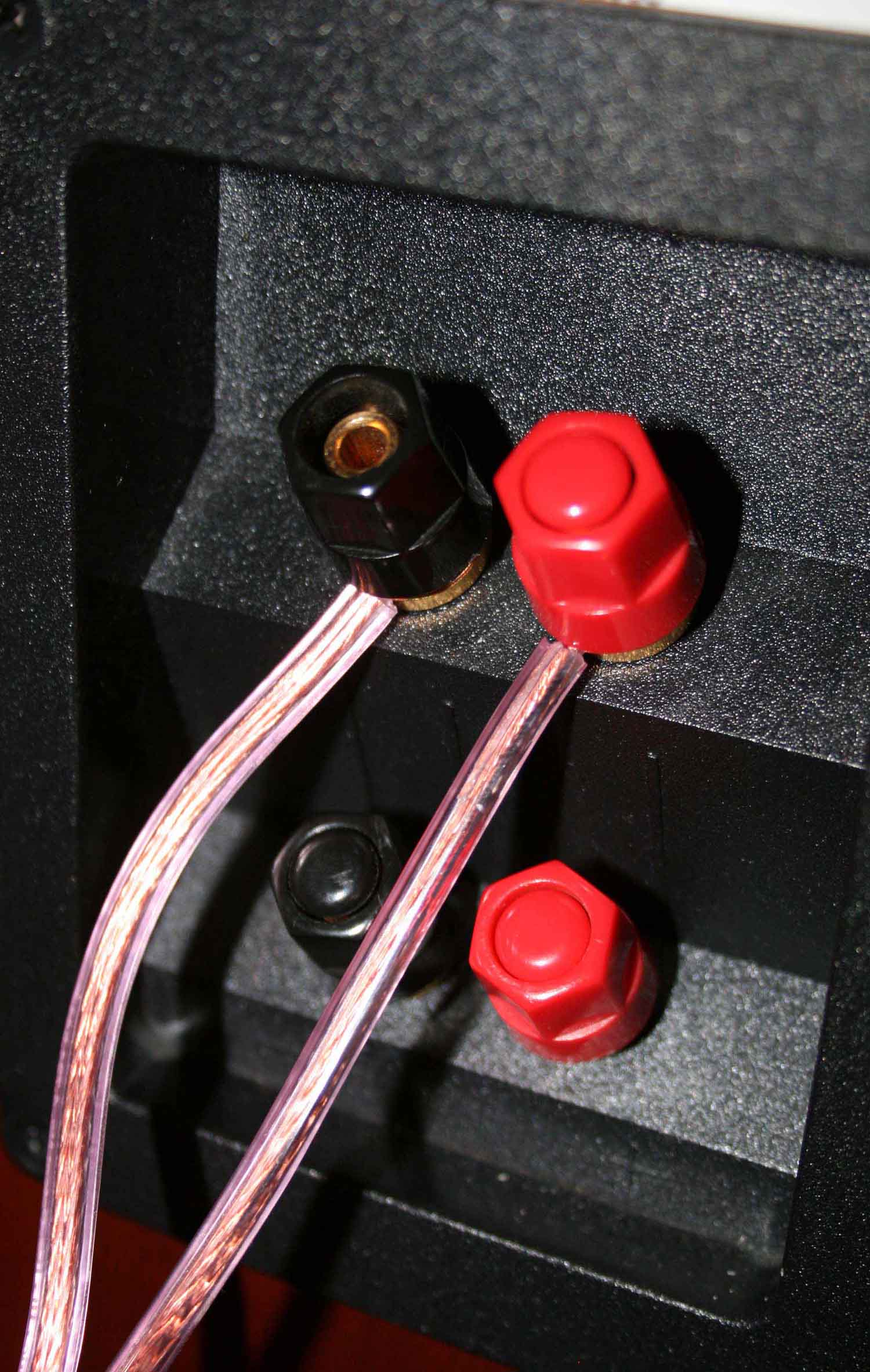

    Here's my one dilemma. I experimented and plugged one set of wires into the top outlets(whatever you call them) and then one set into the bottom on the other speaker.
    Sounds like the ones I plugged into the bottom sound better. Is that just because there is a little more bass?
    Also, in this set up...it has completely taken out my center speaker. I can't seem to get it back working.
    Are the RTi8s drawing all the power?
  • Posts: 13,284
    edited February 2009
    I'm not quite following you.
    On the 8s there are two sets of termninals, and a metal jumper that connects them. Make sure you screw down all 4 sets of terminals even on the set that are not being used (have no wires) because if everything isn't flush you can bypass the upper end...I've accidentally done that myself.
    The important thing is to check all wiring connections, make sure no bare wires are touching or crossing each other and that ALL connections are secure and tight.
    Don't know why you lost that center..that shouldn't happen...

  • Posts: 11,435
    The bottom terminals of the speaker are the woofers, where the upper terminals are the mids / tweeters. So yes the bottoms has base. The center not working you need to balance speakers in setup.

  • Posts: 13,284
    You have an old Onkyo HTIB receiver right? If so, can you go through your menus and make sure it shows that it has a center channel active.
    Then cycle through your surround modes with the remote listening for the center (again if that center is not tightly connected and wired it will not play).
    As far as blu-ray is concerned you have to run the digital cable to the Onkyo then tell the Blu-ray to send out bitstream via the Optical out and so forth. Or else the BDP may be sending sound to the TV via HDMI. Most Blu-rays WILL NOT send sound to the TV and through the Optical digital at the same time. If you can hear sound from your TV you need to get into the blu-ray menus for sound set up.
    cnh

  • Posts: 204
    No...I've had the blu ray set up long before I had the new speakers. And everything seemed to have worked fine.
    Flipping through my menus on the receiver...I can't even see options for changing the center speaker. I have had the opportunity to turn it up and down before...as I have done it.
    I may just leave it for now until I get my 805. Might be the best.
    But also, there is a huge difference when I hook it up to the bottom compared to the top. So much bass in the bottom...a lot more of the highs in the top. To make it tolerable...I still have them switched. So one is deep...and one plays the highs.
    This was a used set. Should I unscrew the back and see if it's able to be connected? The other guy may have had it wired in both. When doing so, would you have to unscrew the back and mess with something?
    Edit: Yes, I have a test tone...but there is no center even being recognized now. My receiver is the HT-R304.
    Thanks again for all your guys help!
  • Posts: 13,284
    I didn't know better I'd say that your jumpers were missing or not in place properly because that's exactly what things would sound like if you had no jumpers and wired it in the way you describe.
    There are metal connectors in place between the upper and lower terminals no?
    cnh
  • Posts: 11,435
    They are brass metal plates which connect the lower to the upper terminals together. You should have them, but its possible you don't if used.

  • Posts: 204
    I know one of the plugs is missing...but I knew that when buying them...
    Other side is the same...only it has all the plugs.
  • Posts: 299
    You are missing the metal jumpers. You are either going to have to order some or bi-wire the speakers.

  • Posts: 13,284
    Yeah you're missing the metal jumpers. You need to get some so that those upper and lower terminals are connected to each other.
    As they appear in the picture, when you wire the top all you get is high end and when you wire the bottom you get bass.
    Maybe some other members can suggest how to get the jumpers. One way to solve the problem immediately is just take two small pieces of wire and connect the wires one from top black post to bottom black and top red to bottom red then rehook your speaker wires as you have them.
    cnh
  • Posts: 204
    Will it hurt them to keep the connected as is for now? Don't want to damage the speaker.
    Think if I call polk tomorrow they will have the jumpers?
    If this is the only thing that is wrong with the speakers...I'm still very happy. They are in amazing condition for the price I got them at.
  • Posts: 13,284
    No harm done, you're just bypassing the crossover and only running some of the drivers with no power to the others. I'd be a little careful pushing the highs too much just in case the 304 clips?
    I'm sure Polk can sell you some...there also available at some online sites...I know Mike21 is online--he would know! Mike?
    cnh

  • Posts: 204
    Well...at least they look like they are easy to attach once I get them. Hopefully when I call Polk in the morning they will have some...
  • Posts: 299
    Just do what cnh said. Take two small pieces of wire and jump the top and bottom terminals on each speaker for the time being and enjoy them.
