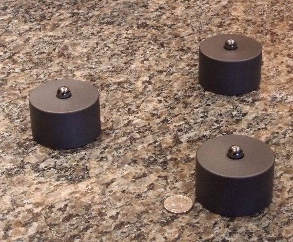

Black Diamond Racing (BDR) isolation devices first came to my attention through the November 2008 issue of Affordable Audio when a writer mentioned that he used BDR products with his Salamander Synergy Twin 30 cabinet. BDR products were also one of the isolation options recommended by Teres Audio. BDR's isolation cones and pucks were of interest to me because I did not like the look of isolation platforms on top of my audio cabinet.
Figure 1. BDR carbon fiber isolation devices. Top to bottom: 5" Turntable Motor
Shelf, BDR Jumbo Pits (rows 2 and 3), Mini Pits, Mini Black Holes, Mk3 Cones and
Mk4 Cones.
The BDR items selected for evaluation were Jumbo Pits ($125 each), Mini Pits ($45 each), Mini Black Holes ($45 each), 5" Diameter Turntable Motor Shelf ($160), Mk3 Cones ($20), and Mk4 Cones ($20). The difference between the Mk3 and Mk4 cones is the Mk4 cones have a linear and neutral tonal character and the Mk3 cones have a warm tonal character with heavier bass emphasis. The interested reader can find detailed descriptions of each item at numerous websites. Black Diamond Racing does not have a website.

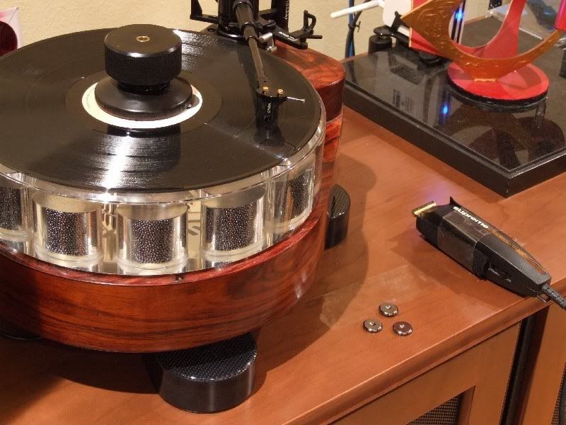

Turntable
BDR Mk4 cones are standard equipment on the Teres 255 turntable. BDR Jumbo Pits were one of the solutions recommended by the manufacturer as a complimentary vibration treatment for the Mk4 cones. Placing a BDR Jumbo pit under each Mk4 cone resulted in the same improvements heard with the SACD player.
Figure 3. My analog game was kicked up a notch with a little vibration treatment.
Of course, since I had raised the turntable 1.5" I also needed to raise the motor 1.5". Two 5" diameter 3/4" thick carbon fiber BDR turntable motor shelves bolted together worked nicely. The BDR shelves have a threaded center hole. The motor's spike feet rest on Adona 3/4" diameter cone cups that have neoprene rubber pads under them. Without the cone cups, the motor's feet would slide off the BDR motor shelf.
I tried other types of platforms under the motor: Granite, Two 5" square 3/4" thick MDF platforms, MDF platform + BDR 5" Shelf, MDF + BDF Mini Pits and BDR Mini Pits + BDR 5" Shelf. The motor ran more quiet with lower belt and pulley noise with the double 5" Shelf. Changing the motor platform was analogous to shifting the focus of a camera lens. The best clarity and detail was heard with the double 5" BDR Shelf.

Quasi-Quantitative Analysis
If I tapped on the cabinet top near the turntable while the stylus was on a non-spinning record, the "thumps" coming through the speakers seemed to be about half as loud with the turntable resting on the Jumbo Pits.
I taped an electric hair clipper to the cabinet top and set up an analog sound level meter in front of the left speaker. With the clipper turned on and the stylus off the record, the meter read 57 dB-C.
With the clipper turned on and the stylus on the record and the turntable sitting only on the stock Mk4 cones, the meter read 74.5 dB-C.
With the clipper turned on and the stylus on the record with Jumbo Pits under the stock Mk4 cones, the meter read 72 dB-C. This represented a 44% reduction in vibration at the stylus.
Figure 7. Another fiendish experiment provides quantitative insight.
