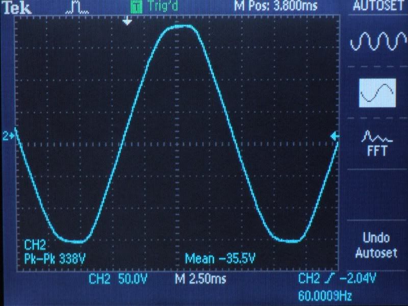

Figure 2. Wall voltage sine wave form. So sad.

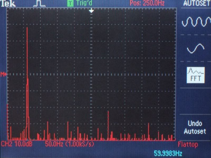

Figure 3. Wall voltage Fast Fourier Transform noise spectrum.
The quality of power delivered to my home is a little worse now than prior to hurricane Gustav (9/1/08). The harmonic and other noise content is higher and the power waveform peaks are flatter due to the higher noise content. Compare figures 2 and 3 above to the wall voltage sine and FFT plots taken in August of 2008, and shown in figures 6 and 7 of Residential Noise Study Part 3. Even though the power delivered to my home is noisier, I have noticed no sonic degradation through the JC 1's.
My flattened peaks of my normal wall voltage now looks like the loaded down wall voltage that used to feed my home theater system (figure 8 of the Residential Noise Study Part 3 thread).

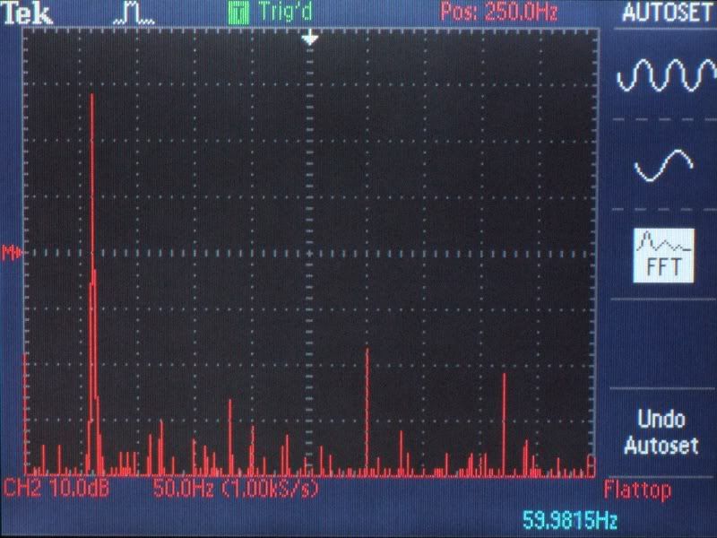

Comparing figures 4 and 5, there is a slight flattening of the left side of the waveform peaks in figure 5. The higher noise content caused by switching on the JC 1 is easily seen by comparing figures 6 and 7. The JC 1 draws 2.08 amps continuously when idling and considerably more when playing music.
Figure 6. PPP output FFT plot with JC 1 connected and switched to standby.
Figure 7. PPP output FFT plot with JC 1 connected and switched on.
