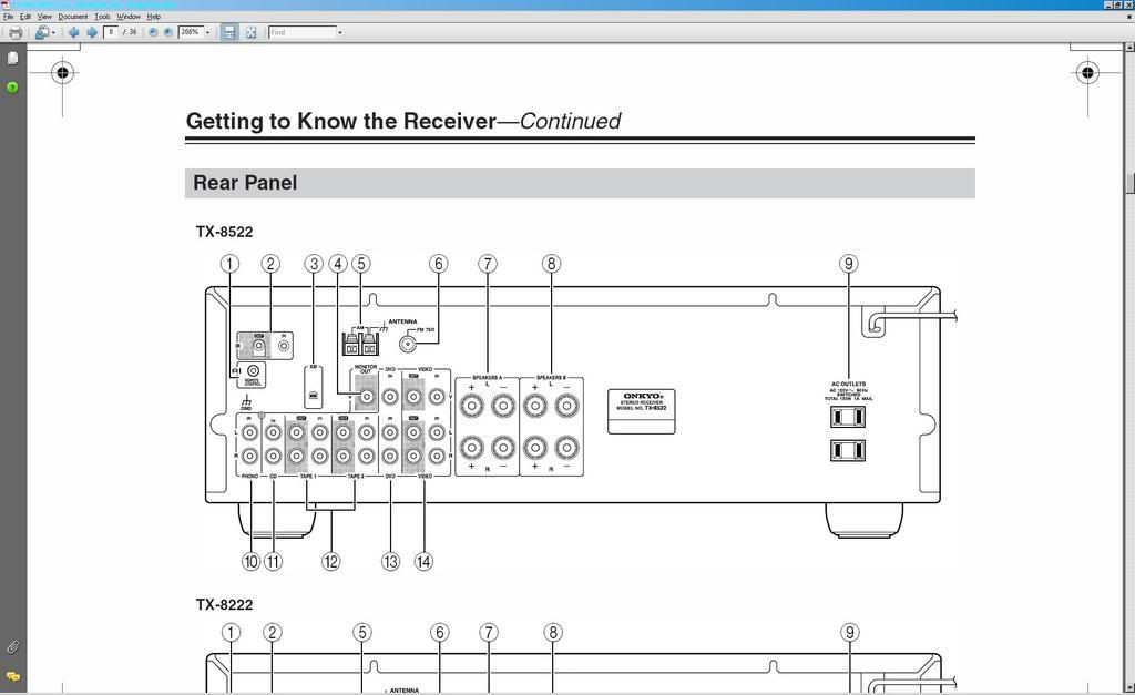

    I see the back of your reciever. There are no pre-outs. I'm not going to advise against what Onkyo told you, but that is a very unorthodox way of doing it. I've sold electronics and been in this hobby a lot of years and the option they suggest has never been a viable long term solution, let alone something I would suggest or even recommend.
    I'm not even sure it's going to work at all like you want it to or how a "true" pre amp signal should.
    Leroy's offer is excellent but it's not going to solve your problem as the "pre amp" he's including will only run the amp which only has (1) speaker terminal, plus you won't be able to use any of the processing from your Onkyo (if you use any of that). By getting Leroy's "package deal" you'll be eliminating the Onlyo and it's functions completely.
    crap. so I obviously have to ditch this Onkyo and get a new receiver.

    mmadden28 wrote: »
    What about this possibility? Get the Pre and Amp deal from Leroy, run a source (CD, Tuner, iPod) into the preamp. Y-Split the Preamp outs -one set into the existing Onkyo's line inputs for driving the Rti's and sub, and the other set into the 545II for the LSi's.
    Maybe??
    Because his OnK doesn't have "main in" either and you can't run it that way either So that idea won't work.
    The best solution is to get a receiver with pre outs.
    Sorry but that's the best and IMO, only solution.
    "Appreciation of audio is a completely subjective human experience. Measurements can provide a measure of insight, but are no substitute for human judgment. Why are we looking to reduce a subjective experience to objective criteria anyway? The subtleties of music and audio reproduction are for those who appreciate it. Differentiation by numbers is for those who do not".--Nelson Pass Pass Labs XA25 | EE Avant Pre | EE Mini Max Supreme DAC | MIT Shotgun S1 | Puritan Audio PSM136 Pwr Condtioner & Classic PC's | Legend L600 | BlueSound Node3 - Tubes add soul!

  • mmadden28
    mmadden28 Posts: 4,283
    edited September 2008
    heiney9 wrote: »
    I understand its not the best solution, but he was looking for something to help him absolutely keep his Onk in the mix (for some reason). I'm not familiar with the term "Main in"-what is that? :confused:
    So he can't run the preamp outputs in to the CD line in?
    ____________________
    This post is a natural product. The slight variations in spelling and grammar enhance its individual character and beauty and in no way are to be considered flaws or defects.
    HT:Onkyo 805, Emotiva XPA-5, Mitsu 52" 1080p DLP / polkaudio RTi12, CSIa6, FXi3, uPro4K
    2-chnl : Pio DV-46AV (SACD), Dodd ELP, Emotiva XPA-1s, XPA-2, Odyssey Khartago, LSi9, SDA-SRS 2 :cool:, SB Duet, MSB & Monarchy DACs, Yamaha PX3 TT, SAE Tuner...
    Pool: Atrium 60's/45's
    heiney9 Posts: 25,262
    mmadden28 wrote: »
    Nope.
    Pre out means the unit is capable of sending a typical "pre amp signal" to an external amp (by passing the pre amplifier section in the unit)
    Main in is the opposite meaning you can "plug" the inputs of an external amp into the unit and use the "pre amp" section in the unit (bypassing the internal amp)
    These are always "capped" with removable jumpers which work like the jumpers on bi ampable speakers.
    The signals that are used for typical line levels (cd, tape, aux, video, etc) don't have anywhere close to the same value as the input or output that the pre in or main out has (they are not compatible). It causes problems and in some cases serious problems as you could overload the amp or send a dangerous "spike" of voltage or high pitched sound to your speakers and damage either or both.
  • trans am
    trans am Posts: 91
    Okay deal is done. I paid him. I can sell the onkyo or give it as a gift and use the preamps 4 inputs for everything else. here's my question since the amp only has 1 stereo terminal, could I run the psw111 of the the amp and daisy chain the lsi7 to the extra terminals on the subwoofer for now? or is that ridiculous? is there a way I can split the terminal on the amp so I can still have a sub?
