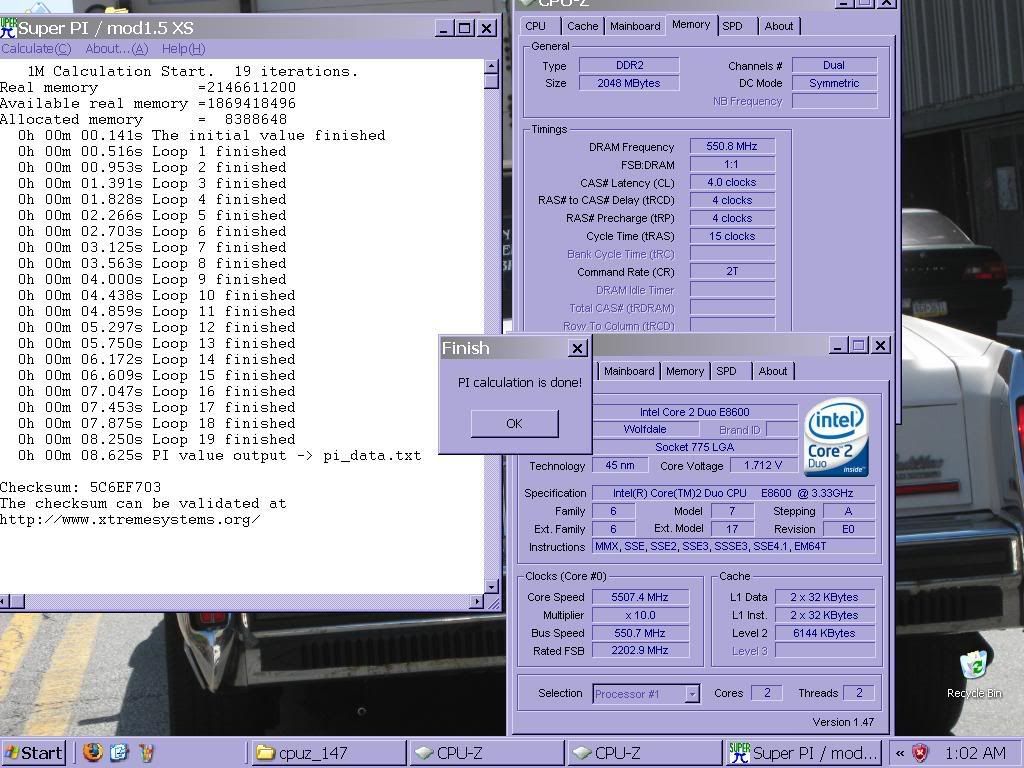

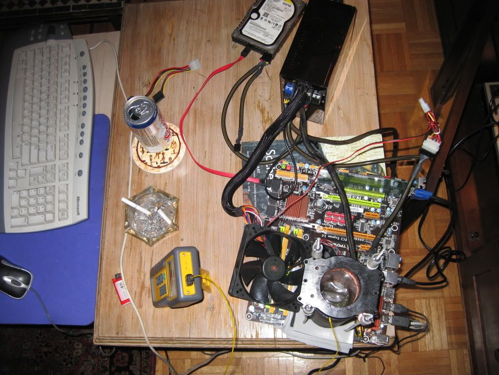

    ...I cool Intel quad and dual core cpus using dry ice and liquid nitrogen. XS is the best overclocking forum in the world....
    :confused::eek::confused::eek:
    Dam-n-siht, dry ice? Liquid Nitrogen? Now that's extreme! :cool:

    mmadden28 wrote: »

    :eek::eek::eek::eek::eek:
