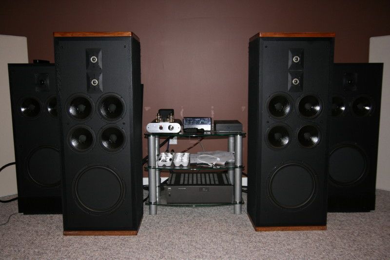

Here they are before I started ripping into them, posing for a picture in front of their baby brothers:

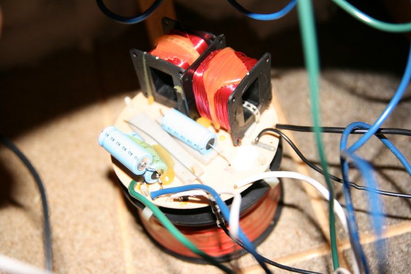

I pulled the passive radiator, here's what I saw inside:
(Notice the single conductor going to the SDA interconnect in the above shot...)
and
Ok, well that's just not going to suffice, time to start upgrading!!!!

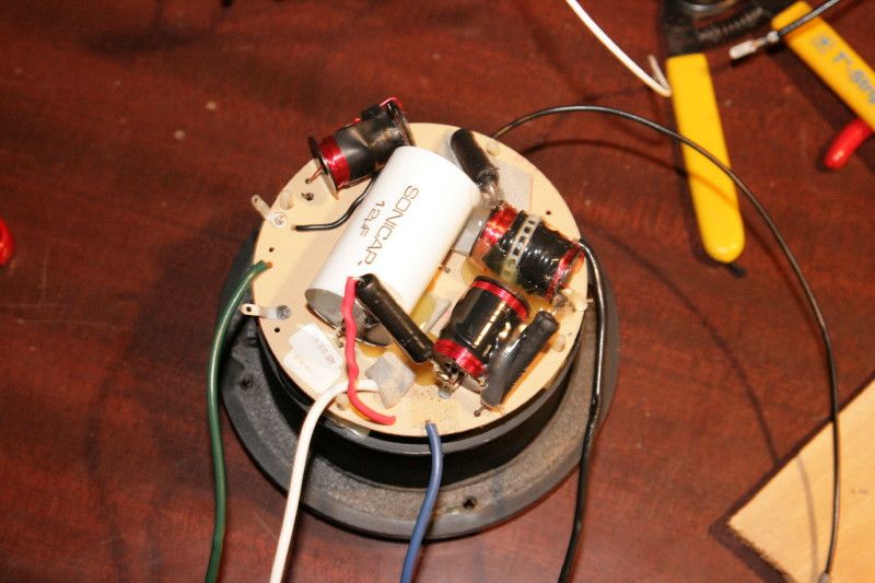

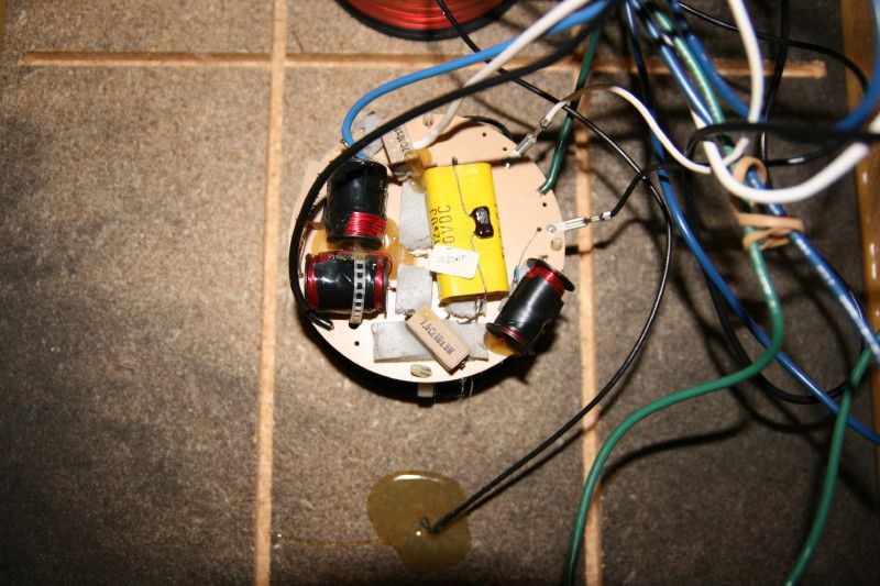

I pulled both crossover units, one is mounted to the back of the binding post assembly, one's mounted to the large inductor and attached with a screw that you need to remove from the back with an allen wrench.

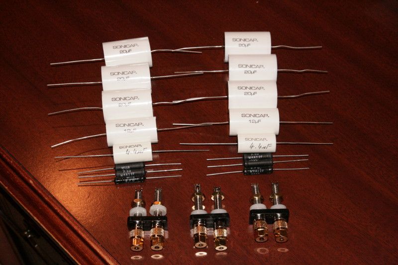

So, parts:
Yummy! Spent more on those caps than I did on the speakers! :cool: The third binding post assembly is to replace the blade/blade connection so I can use speaker wire for the SDA interconnect. Frank at Signal Cable made me a cool Ultra with one banana and one spade at each end, so I could connect both strands to the single binding post. Now that's an SDA cable!!!
These xo's were a bit trickier to do than my 2B's. Yanking the polyswitch was tough because it runs underneath one of the little inductors on the high-end xo. Need to be real careful prying the inductor loose to get at that polyswitch. Also a few places where one component needed to solder onto the next component, rather than each piece having a dedicated soldering post on the circuit board. Nothing too difficult, just a bit more involved than the 2B's.

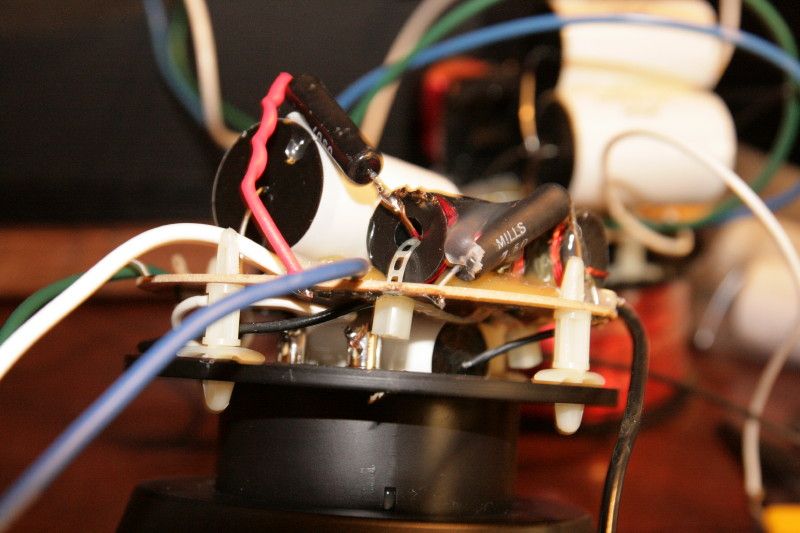

So here's the finished product. First the high side:
Three Mills resistors and the 12uf Sonicap (I did not use a bypass) on top of the board as seen above, and a 4.4uf Sonicap mounted below:
It's kind of hard to see in the above pic, but the 4.4uf Sonicap just fit in between the tops of the regular binding posts and the SDA binding post. If that cap had been any bigger, I would have had problems.

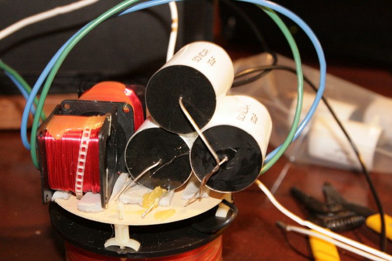

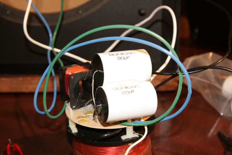

Now for the low end. I just think this looks so bad-****. Three 20uf Sonicaps - over $80 in caps just for one low-end xo! The schematic calls for a 20uf and a 40uf. There's no such thing as a 40uf Sonicap, so I used two 20's (so did the stock xo):

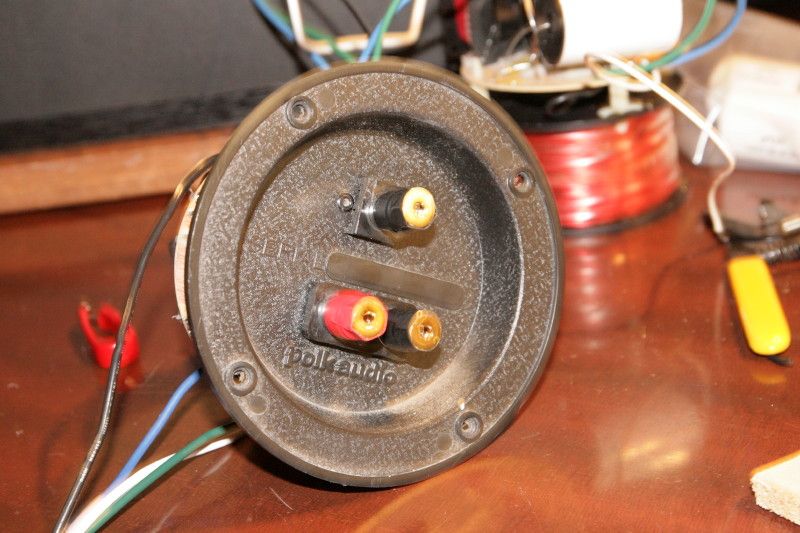

Here's the binding post assembly. Shame to put tape over those gorgeous Cardas posts, but making them red/black makes things soooooo much easier. Jesse, sorry, I used the boots again. I know, I know....
    Yeah, that was a shame to buy all that jewelry and cover it up.:eek: You are denying yourself the pleasure of taking an occasional peek behind your speakers just to look at the shiny binding posts.:)
    I put a dot of red paint on the boot under my positive Cardas posts.
    nspindel wrote: »
    They will make custom values. Did you ask? Although, a 40 uF might have been harder to place on the board than two 20 uF's. The 30 uF Sonicap is nearly 1.5" in diameter by 3" long. The size of a 40 uF Sonicap might be of some concern.
    Great review. Thanks.
    Thanks for the positive thoughts. I think a 40uF would have been a disaster, actually. I don't think I could have fit it on the board side by side with the 20uF that is behind it, so it would have been a bit of a hack job. I kinda like the look of the three twenties stacked up like that!
