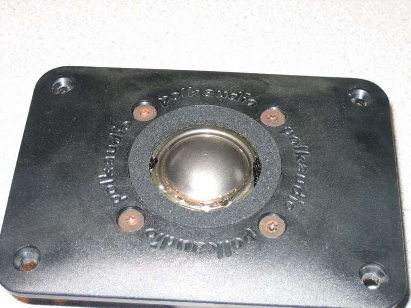

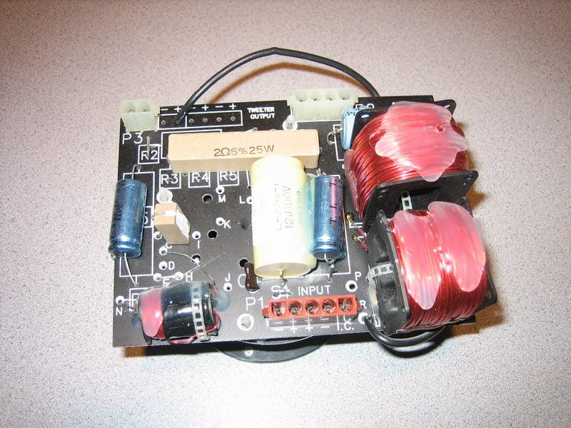

    First of all, I want to thank you guys for your offer to help....I totally didn't expect that and I want to let you know that it is a heartfelt thank you and just strengthens my belief in the value of the Polk Community here.
    I'm not sure how to tell which are the 6503's or MW611's because the drivers all look the same. I took them all out of the speaker cabinet and marked their positions. The top two drivers move freely but have a strong burnt odor. The 3rd one is scratchy and smells burnt. The bottom one hardly moves and smells burnt. The lone driver on the right doesn't move at all and smells burnt. The tweeter is visually destroyed.
    I didn't take pictures of the drivers because visually they look normal. I removed the crossover and took a couple of pictures. The burnt smell is there but not as strong as the drivers. I don't know what to look for in terms of damage.
    This is from the right speaker only, I haven't opened the left one yet.

    That tweet is definitely shot but the x-over appears to be ok. Minimal damage and a cheap fix if anything there.

    Looks like the boards are fine, and the inductors. The resistors can be burnt without any visible damage. Take an ohm meter, and read the resistance across the resistor. If you don't get a reading that matches the rating for that resistor then you are in luck. Now that you have it apart its a good time to upgrade the XO. At least replace the 2 12uf's per side, and replace the resistors with Mill's. That 2ohm 25watt doesn't appear to be stock. Double check the other speakers XO to see if it has the same setup.
    BTW the 6511 is the sigle dimensional driver, and the 6503's are the stereo drivers.

    I'd say if the "sand" resistors aren't discolored and the PC board looks fine you might be alright. Many times the resistor gets hot underneath and that's where the discoloration is. That's what I found on my 5B's after the resistor was removed. Your's look normal, even the slightly cooked one in my 5B had a slight brownish discoloration on the top.

    Well I agree that the cross over looks in surprising good shape considering the event. Looking at the crossover schematic I would check all woofers on both speakers. I would also have the other amp, or the other have of amp as it does appear that dc could be feed back into the amp from the other amp failure by that sda cable.
