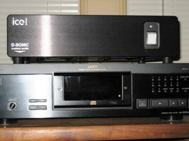

Check out Icepower amps, www.d-sonic.net. You can find them in Rotel, PS Audio and a few more. They run very cool, and are price very reasonable. I should have my new D-Sonic Magnum 1000S this week, Monday/Tueday at latest. Heres what they look like in a real picture.Shoot the jumper.....................BALLIN.............!!!!!
