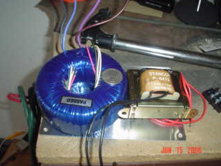

    OK. Got my cable built, finally. The toroidal transformer produced a much better fidelity sound when passing music through it.
    Attached is a picture of both the recommended Stancor-6412 and the Avel Lindberg Toroidal Y236605. The toroid has 4 windings on it. You only use 2 of them, one for each side. I used the two windings with the lowest DC impedence. Forget about the other two, since they are only used in 2:1 step up/down applications.
    On my 2.3s the connections are as follows on the Avel Lindberg.
    Right Pin = Brown wire on transformer
    Right Blade = Violet
    Left Pin = Grey
    Left Blade = Blue
    I found the polarity using my ears. Turning the stereo balance to one side, I found that polarity one way made the sound appear even further to the outside while the other way seemed to move it inward (if any). I left it where it widened the sound.
    It took so long becuase of fiddling with a faulty amp and waiting to find a cheap preamp on ebay to drive the nad 2200. Finally got a good deal on an old carver.
    Here's the two transformers side by side with a quarter for scale.

    Just noticed the post by DarqueKnight. This Y236605 is pretty hefty, about 5 pounds. It is rated at 230VA. You can see by the pics it dwarfs the stancor people have been using, if size means anything. The wires where a little heavier guage, too.
    The ones you mention are massive. I'm sure they will work just as good, if not better. Someone posted a picture of the innards of their polk factory cable and it had a puny transformer. I'm not so sure saturation is a problem, because the SDA effect drivers are only driven a fraction of what the main drivers are. I guess safe is always better than sorry, though.
    Just make sure and get the right wires. I used an ohmeter to find the matching pairs. They have the same impedence if they have the same number of windings), which is what you want. If you grab two windings with a different impedence (different windings, probably 2:1), you will have a step up in one direction and a step down in the other.
