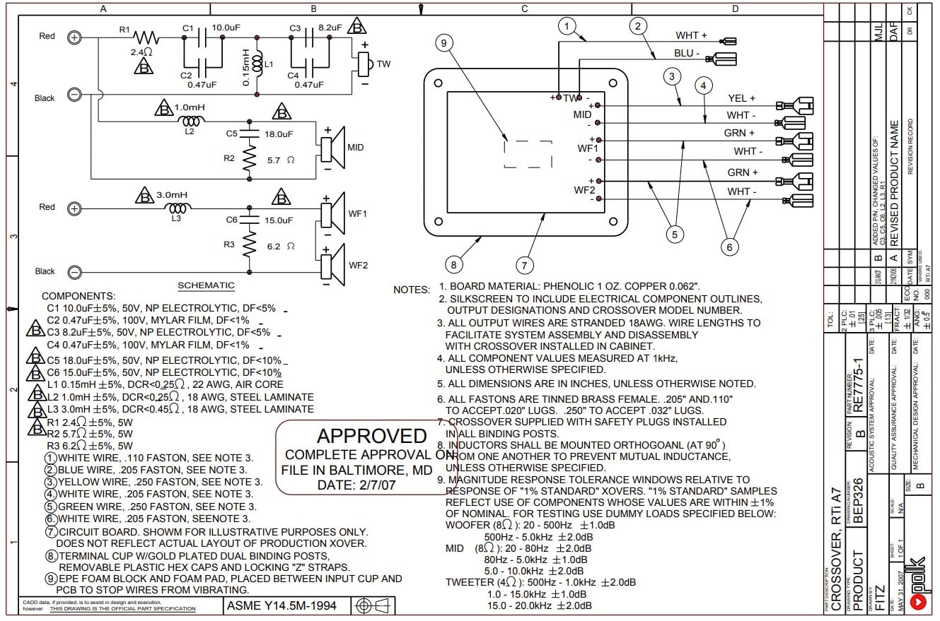

    I am hoping you have the crossover schematic. If not, the PDF is located here: https://forum.polkaudio.com/discussion/202480/rti-a-series-crossovers#latest
    Regarding components, Mills MRA 12W are generally a standard for crossover resistors. Some will argue that the Dayton non-inductive wirewound resistors from Partsexpress are close in quality, but significantly less expensive. Either will be better than the original sandcast resistors. I would use decent capacitors in the tweeter circuit. Jantzen Cross Caps, or Clarity Cap PX at a minimum. Size is a factor on the larger capacitors in the woofer section, and since they are shunt caps, they don't have as much of an effect on sound quality. Non-polar electrolytic is what the factory came with and using new equivalents will give you similar sound to what you had.
    One thing to look out for, is the inductors could have been damaged by overcurrent. You'll need an LCR meter to measure those. An out of spec inductor can make a big difference in sound between channels. I've had it happen to me on a vintage set of Mirage M3.

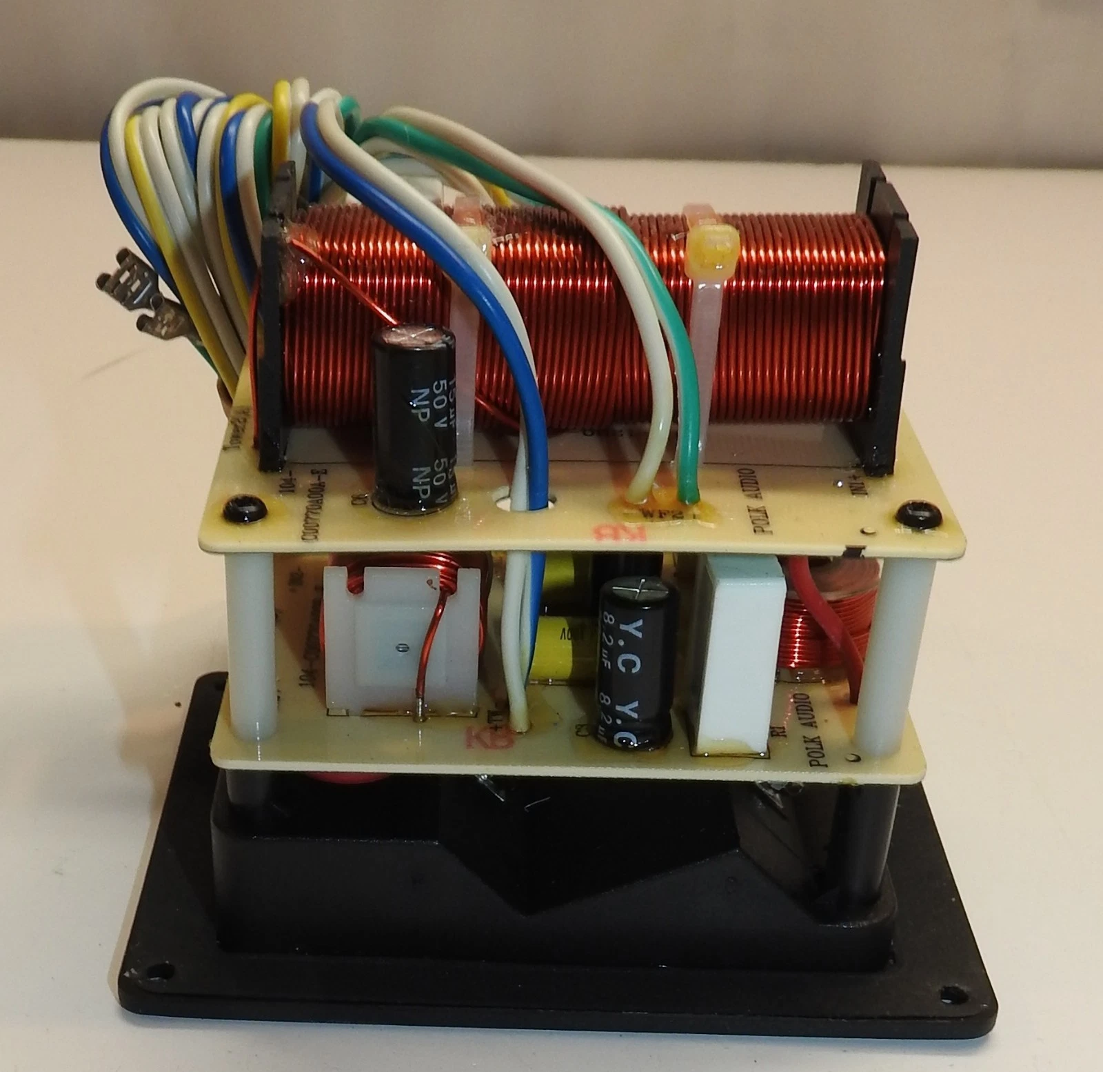

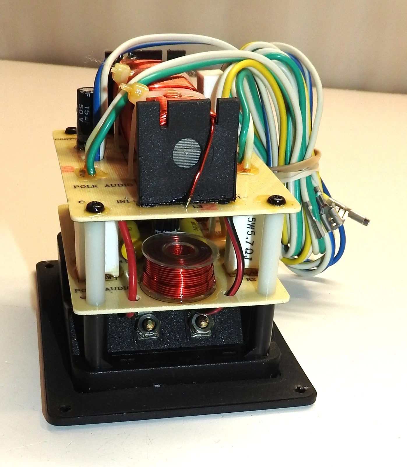

    Here's what the crossover looks like, as you probably know but people reading this thread don't all know:

    @Gardenstater I have personally examined the circuit board, both in terms of its schematic and its individual components—yes, it is the board shown in the photo. While the only way to be 100% certain would be to remove every component and test them one by one, that is beyond my current capabilities. Based on my own assessment—supported by input from an AI (to which I had sent a photo of the board)—and the fact that the coils appear to be in good condition, I suspect the issue lies with the capacitors and resistors. The sound quality problem, specifically affecting the mid and high frequencies, points toward these components; the AI ​​also suggested focusing primarily on the capacitors, noting that Mylar capacitors, in particular, rarely fail.
    For instance, the circuit shows that an 8.2 µF capacitor—paired with a bypass capacitor—and a 2.4-ohm resistor are used for the mid-range section. I reasoned that by using components with the exact same values—an 8.2 µF capacitor and a 2.4-ohm resistor from the brand Jantzen—I could closely replicate the circuit design implemented by the Polk engineers and achieve the same sonic characteristics.
    Of course, even without taking any measurements, the fact that the artificial intelligence specifically highlighted the mid and treble sections—where I’ve been experiencing a "veiled" or "muffled" sound—suggests that replacing the components in these parts could largely resolve the issue. Even if the coils appear to be in good condition, their actual values ​​might have drifted, making it logical to simply purchase a new crossover. This is especially true considering that, to perform accurate measurements, one would have to desolder every single component anyway; if I were to replace the capacitors and resistors with new ones of the same nominal values ​​but still fail to achieve the desired sound character, then buying a new crossover would definitely be the most sensible approach.

    No annoyance at all. I looked at the crossover and you shouldn't have to remove any components to test them all. The drivers have fastons and can be disconnected. You are aided by the fact that capacitors don't pass DC current which is what the continuity testing for shorts and opens will involve. The speaker cables should of course not be in place. The only thing you might have to do is desolder one lead on each of the bypass mylar caps, in order to test both parallel caps independently. To avoid heat damage just clip a small hemostat onto the lead and that will help with pulling it out as well. Check resistances, continuity, inductances and capacitance with an LCR meter. You can even get ones that do ESR and DF.
    You can probe the board on the trace side by placing the probes of the meter on the solder pads.

    I have to wonder why the AI "thinks" that the 10.0uf tweeter capacitor is not subject to damage. The current would be greater through it than the 8.2 uf.
    I see from reviews that the crossover frequencies are 2.7 kHz and 125 Hz, both at 12 dB per octave fwiw.

    A kind of easy way to test the drivers in the “bad sounding speaker” is install the good crossover in it. Then listen to it with music or a movie soundtrack you know well.
    Hopefully they are ok. You will only have to replace crossover components
    Side note: I think you may have trouble locating those tiny .47 uf caps (C2&C4). F1nut advises cut the originals from the XO for a cleaner top end. C5/R2 & C6/3 are Zobel networks for the mids and the woofers respectively.
    George, help me out bro: “You can even get ones that do ESR and DF.” What does DF stand for?
    Hey Tony. DF stands for Dissipation Factor. In the schematic you can see that they specify less than 1% and 5% for the tweeter mylar bypass cap and NP electrolytic cap and for the midwoofer and woofer they specify less than 10% for the NP Electrolytic Cap. NP stands for non-polarized which I'm pretty sure is the same as bipolar.

    I think we should probably give the Polk Engineering Dept. the benefit of the doubt that the small mylar capacitor (so called bypass cap) in parallel with the NP Electrolytic will improve the sound. It's not the same as the "opinion" that some may hold that a high quality film cap is not in need of a bypass cap, when you are talking about an electrolytic in series with a tweeter. JM2c.
    Tony Gee at humblehomadehifi speaks highly of bypass caps. I have heard @VR3 say they are useful as long as it is a much better quality cap than the one being bypassed.

    George: your post of the ‘A7 XO schematic did me a favor as I’ve never seen it.
    Further, applying knowledge I picked up about the time we met at your house made me realize 16 years ago I misinterpreted much of the speaker’s XO function.
    - the LP filtering for the mids (and woofers) are 1st order.
    - the HP filtering for the tweeter is 3rd order. That makes the “hand off” between the M & T asymmetrical* - a fun fact
    That said, when I get the living room to myself for a stretch, I’ll “tinker” w/the EXO a bit applying the above info* to electronically restore the original hand-off for fun and possible improvement.
