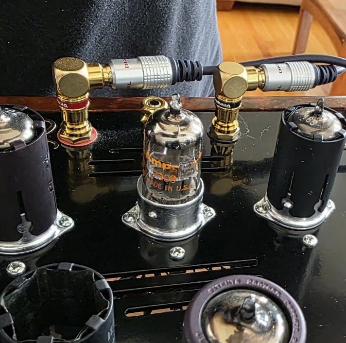

    Oh my, I haven't been tube shopping for a while! I built the Eros in 2015 and only need one 6922/7308. I think I got the single Amperex 7308 from Carl.
    The Eros uses two EF86 tubes (typically used in Neumann U67 microphones) as first gain stage. I would have liked to get some better Telefunken EF806S but they commanded a high price, like ~ $280 each. At the time Tele EF86 were $100 each.
    When Norm and I had ModWright gear, Bendix 6900's were the holy grail tubes, around $800 a pair. I did some research and learned MU Engineering purchased Bendix tube division and rebranded existing stock. We got those for $300 a pair until word got out they were essentially rebranded or made with Bendix tooling.
