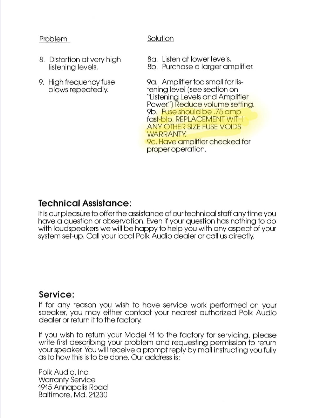

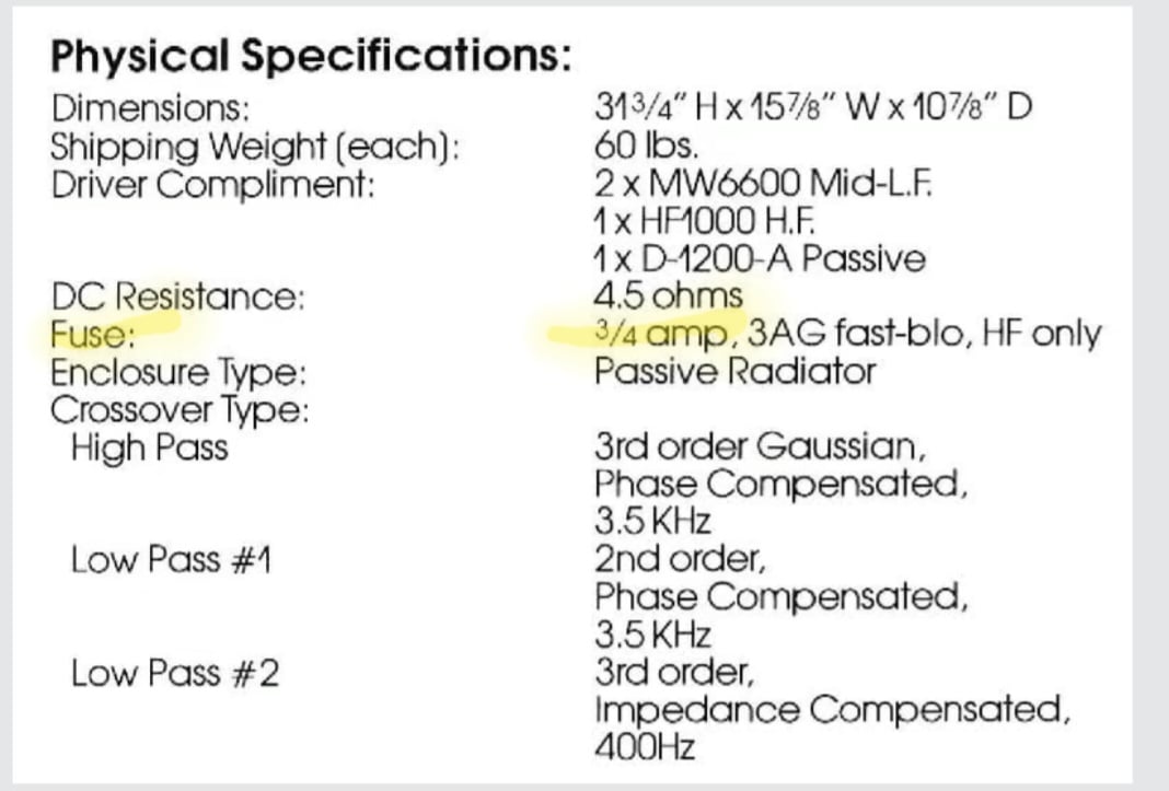

    But, according to Polk Monitor 11 owner's manual, "correct" fuse for THIS model is 0.75A, not 1A. In fact, Polk is rather adamant about it. (See screen shots from owner's manual.)
    I admit it is puzzling to me, since the Peerless tweeter is identical to Monitor 10 & 7, in which 1A fuse is specified.

    Yeah I remember puzzling about that myself. The Peerless are the usual 8 ohm ones right? I mean they made 4 ohm ones as well.

    Correct. They are (nominal) 8ohm Peerless.

    Well, use the .75 amp fast blo. All the 7's or 10's have been 1 amp fast blo as well as my SDA 1 signatures.
    If you do a search here, you'll find most cases suggest 1 amp fast blo.

    Yessir! That's the plan. But I was curious about the reasoning behind Polk's deviation from their usual 1A fuse. Not that everything Polk ever did makes sense.... But just thought there might be a technical reason that I was unaware of.

    It is kind of strange, it's not like they were different peerless tweeters. The SL1000 also used the 1 amp fast blo.
